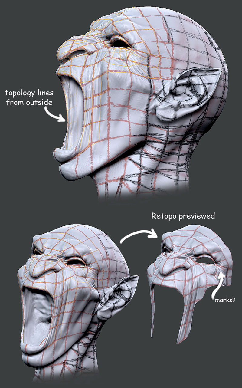

Hello ZBrushers,
I went through the entire thread but couldn’t find what I need (maybe I hurried…
) -great thread btw.-, so I’d like to ask for your help concerning 2 problems:
1.) I run into problems each time I try to retopo the inside mouth area of this monster. This is because even when I retopo from the inside, the retopoed mesh is connected to the retopo lines from the outside area and they mix up. On the upper pic you can view what I mean: the lines visible on the inside mouth area are actually lines from the outside.Up to now I wasn’t able to retopo the inside because of this problem.
Does anyone have a practical solution concerning retopologising these areas?
2.) On the two lower pics one can see that in the preview the retopoed mesh looks quite nice, only problem are those little marks/holes on the right instead the original crow feet wrinkles. Any idea what this is about?
(I hope you don’t get confused with my polypainted lay out lines)
Oliver, Du hast 'ne PM von mir.
Good luck.
Give thanks and praises to da Rastaman!
Danke nochmal für die Hilfe;).

Hurdy Gurdy Man and Rastaman (hehe cool name), it seems you sorted out the retopo in the mouth. Can you share your process? Did you export to 3d app and retopo then import as obj. Can you reply with enough info that it has the answer in the thread for next time someone does a search.
Hurdy Gurdy Man, would it be possible to see the image of the result, and I would like to see the rest of your character do you have a wip thread.
