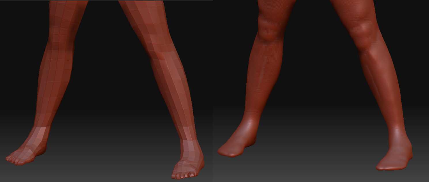

Sure thing.
Most of the detail is in the upper body so far, but that is the area where the geometry has changed the most. Aside from an edgeloop that I put in running from head to toe, as well as a few extrudes for an ear on the head.
Sure thing.

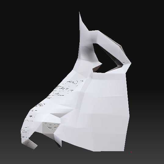

2nd: When previewing the new geometry i get al kinds of weird black spots. This happends even when i just create two new polygons. When i increase the mesh density (adaptive skin for example) the spots get smaller. I tried different models but the results are always the same, black spots / holes everywhere :(.
try boosting your resolution up, i got the black spots on my laptop when i was using 1024 - 768 but not when i use a 1920 - 1024 dont worry too much about it, there not missing polys. but it might be as simple as turning on double sided polys in the Tools-> Display Options-> Double. give em a go.
Turning Double sides off did the trick :), it might be a driver problem since i was messing around my videodrivers a couple days ago. But a least now i know how to get rid of them black spots, thx for your help:D .
