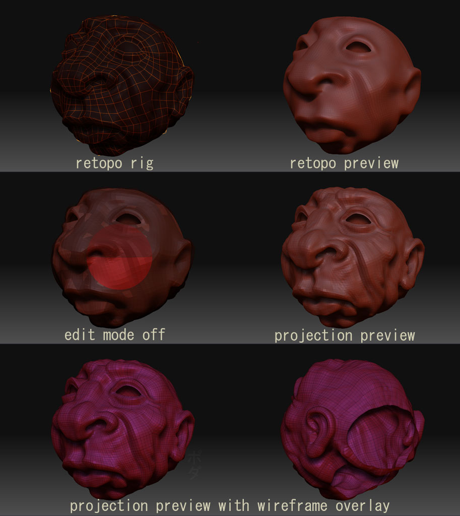

Here’s what I wrote in my wip thread - it has been pointed out that what I am calling vertices or verts in this process are actually ZSpheres. That is true but I think it’s clearer when described as verts and even the docsrefer to them as verts:
Along with comments and suggestions in the thread we are currently in, I also found the cyborg head tut to be helpful (if not a bit vague) in figuring retopo out.

Hey Plakkie - If you just want retopo an object but you want to start with the existing geometry already in the retopo rig my guess is you can follow step 4 in Francois Rimasson’s The Making of “Birth” tutorial. It says to clone your souce mesh and hide the parts you don’t want to keep (in your case I guess you would not hide anything) and select Projection from the Tool:Rigging subpalette. This will take whatever’s visible in the clone and turn it into a retopo rig and project it onto your template (source) geometry. To see and edit the rig you select Edit Topology from the Tool:Topology sub palette.
I haven’t tried it yet but it sounds pretty straight forward (relatively speaking). :wink:
I hope this helps.
