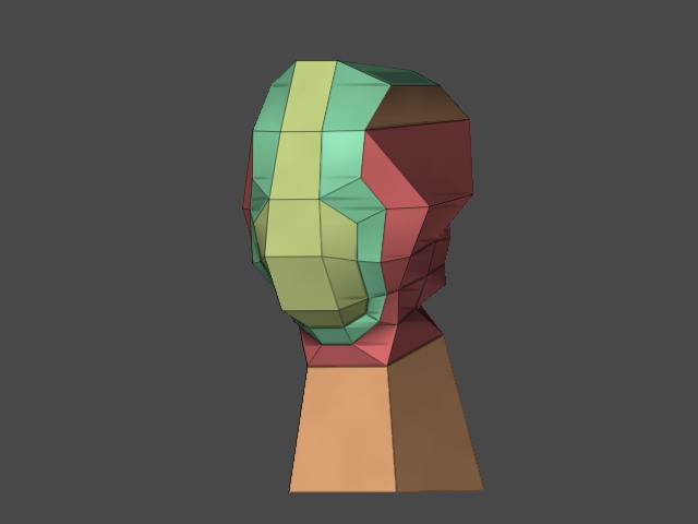

Hi calum5ZB, you seem to have the edge flow working nicely, try not to add any extra detail at this stage, like the loop you made for the chin, making a loop around a single polygon isn’t a good idea, it may cause issues later on. Think carefuly before you add loops, if they enhance the model, all well and good, but if they disrupt the flow in any way or seem irrelevent leave them out.
Once you have your basic model looping correctly think about proportions and anatomy, and tweek your model into shape, the fewer polygons to deal with at this stage the better.

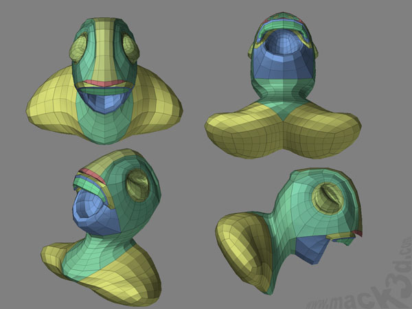

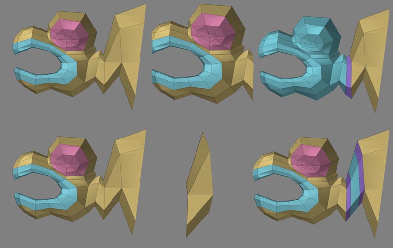

Here’s another little tip to think about. Because zbrush adds loops along the edge of a hidden selection you can vary the amount of loops created by the way you make selections, ie. select one side of a loop and you get one extra row of edges, select both sides of a loop and you get two rows of edges. Check the example below for clarification. Sometimes you need more geometry in certain areas and sometimes you need less, juist gives you more choice into how you cut into your model.
