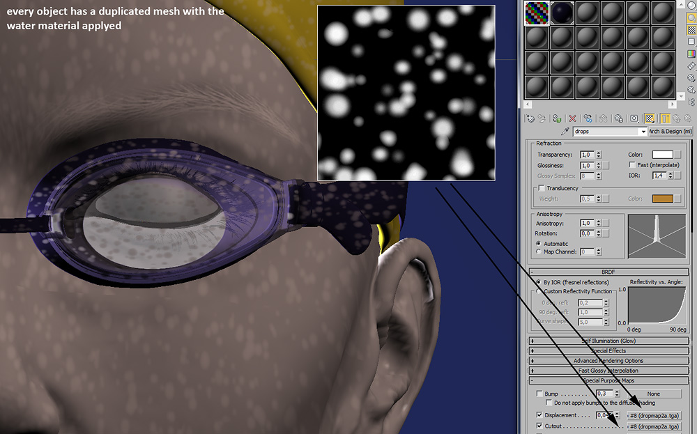

WOW! If you don’t mind me asking, how did you get the transparency of the goggles?

Intervain, the water setup was quite simple (after a lot of different approaches, hmpf…). I´ve duplicated the mesh of all the objects that have water drops on them, remapped then (usually a planar or cilindrical map, to adjust the density/tiling in relation with the camera) then I applyed the material as shown in the picture above.
And to improve the water render, I´ve added a skylight with low intensity (0,55) and a HDR sky map.
The scene´s main lights are just two areas, one key light and one fill light.

I was thinking about another way to do water drops.
You could simply draw in the drops with a alpha mask over your model. Then extract the drops into its own subtool then export the drops into max and use the mental ray water material. I tried this on a simple sphere and seamed to work pretty decent.

Great work and congratulations on the top row :), thanks for sharing how you did the water droplets on the character I definitely want to give that a try.

the water effect is simple but effective… but looks not so good like the skin.
