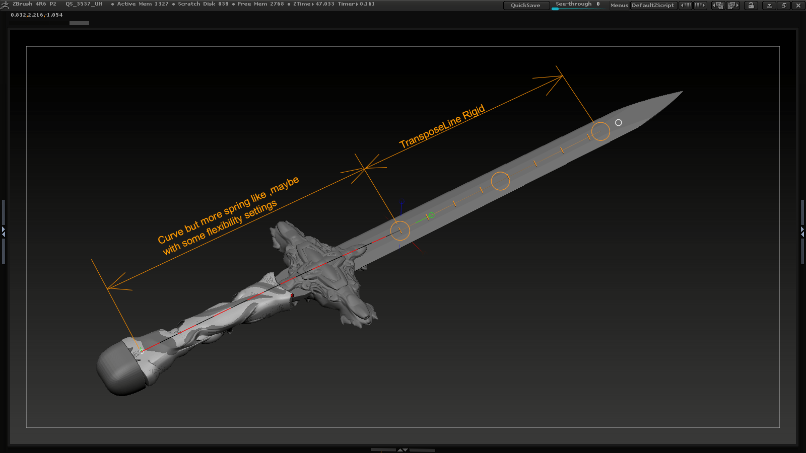

So this could be cool to start out with a curve line, then that will be the spring mechanism and it will append the transpose line to it so that will be rigid, the curve will have a spring like behavior and the rest will have normal transpose line functionality.
So the start point of the curve will stay in place, the rest will be adjustible through the string settings, and the rest will be just like the transposeline.
See Picture:

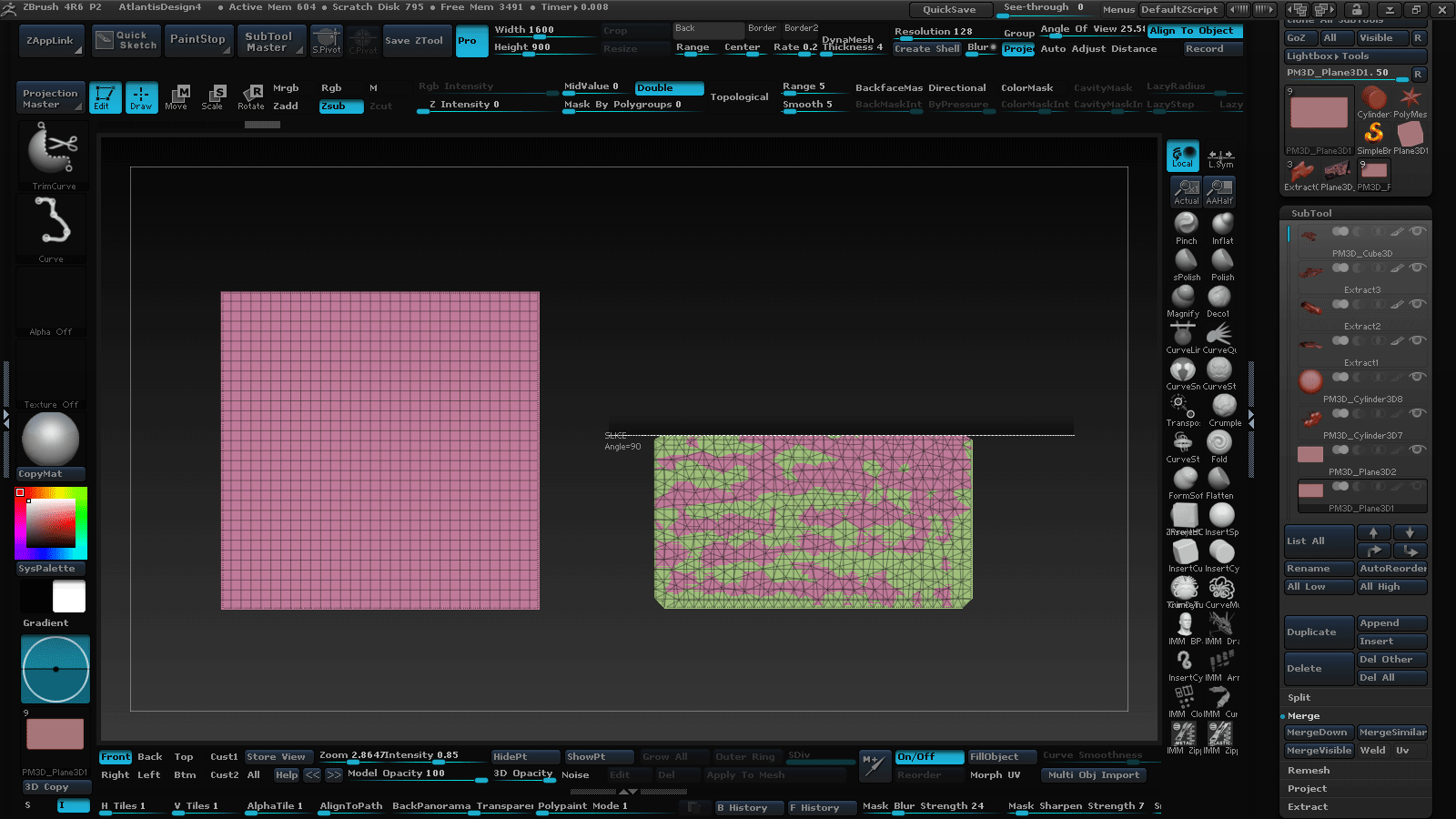

Now if you use the trim brush on a plane the surface get the tesselated topology when you trim it.
You could just hide and delete hidden, or slice it.
But could be cool to have a quad surface option 2.

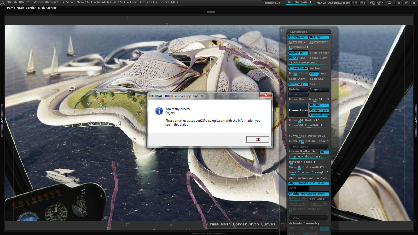

I love the frame mesh function,
But because of dense meshes the curve point will get this error (to many curves)
Could be cool to have a setting that will tone down the curve steps.
Maybe a popup window right after the error would be cool.
And a setting in the stroke menu.
NVM :smiley:
Curve Smoothness is the setting that fixes the problem.
Never used that one it’s awesome.
