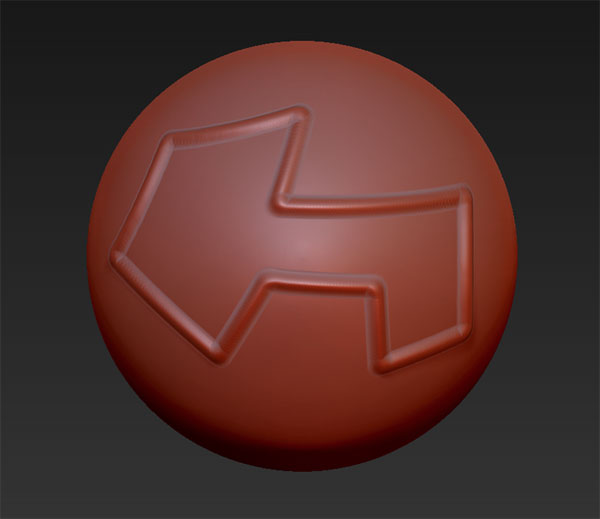

What has happened to the fucntion where you start at brush stroke and hold down the SHIFT key to constrain the stroke to the screen axis??? I am using that all the time, well atleast in R7, so where is it now and how do I get it back ? … Now when I hold down the shift key, a really annoying and very hard to control Lazy mouse kinda line appear. And it also used to work when masking, that functionality is also gone!!
Please help, this new behaviour is so frustrating!
The new straight line functionality is as follows:
Make contact with a surface (pen-down for a starting point)
Hold down shift, and drag out the guide line to an end point. Note the number indicates the angle degree, so a “zero” would be a right angle.
Release Shift while still holding the pen down, and the line will be drawn.
If you need a more interactive/pressure variable stroke, you will have to make use of the Backtrack feature in Lazy Mouse
Switch on Lazy Mouse, Backtrack, Line setting.
Turn the “track curvature” to 100, in order to get the stroke to adhere to the surface of the mesh.
stroke back and forth between the two endpoints that setting produces.
Edit: seems Scott got here first
@Carsten Lind
Hi, the functionality you’re describing has been integrated into Lazy Mouse 2.0.
I agree it’s not 100% the same but I would argue it’s better
You can still create strokes that go vertically, horizontally and at 45 degree angle… but you can also make straight lines at any angle, plus you can actually see where they’ll end up before committing to them.
The thing to keep in mind is that you click, then click and hold shift to see the exact path and length of your stroke. When you decide the angle and length are correct you let go of shift and you get your straight stroke. You can also chain these strokes by keeping the pen pressed and just holding and letting go of shift.
The detailed description is in the Lazy Mouse 2.0 section of the documentation under Click-to-Click Straight Lines section.
One thing that’s not mentioned here is that if you set Lazy Radius to 2 or more then you’ll get snapping to 90 and 45 degree angles.
This will be represented by an extra green/yellow line.
Admittedly I haven’t used the 4R7 function too much - is there any other nuance of the old feature that’s missing here?
I’m sure the new control scheme with the visible line just takes getting used to.
cheers

Arrrgh - It feels so un-intuitive, un-interactive, clunky… I see that it is easier to get angled lines, but even the 0 degrees is not 100% horizontal, but only almost 100%. I would prefer to have a way to get the old way back, a setting in stroke or something. As it has been designed now, is just more painfull menu hunting which doesn’t help with the reputation that Zbrush has of a flawless UI (sarcasm may occur)
As I mentioned: if you set Lazy Radius to 2 or more you get a snap with a visual indicator in form of a green line that turns yellow when you snap to it. It’ll get you perfect horizontal, vertical and 45 degrees strokes.
I’m sure getting used to it can be painful if you already developed muscle memory for the previous version.
As for menu hunting and ZBrush UI in general (sarcasm noted) I have the same response (and we can agree to disagree - it’s a philosophical dispute
): ZBrush’s UI allows you to put (almost) any button or slider wherever you need it which makes it the most versatile and user friendly UI that I know of.
If you don’t want to add an extra button/slider directly on your UI shelves then you can always make your own Menu that will pop up directly under your cursor if you bind a keyboard shortcut to it.
I will grant you that with the current system you do need to have lazy mouse ON in order to use the Click-to-Click Straight functionality.
What could be cool is if Shift (pressed after you start drawing) automatically and temporarily turned lazy mouse On. (because now pressing shift after you start drawing does nothing if lazy mouse is Off.
That would be a nice new feature
I’ll even submit it as a feature request
Maybe there’s a way to do it already with a script or plugin or with an option I’m not aware of? I don’t think so, but would be cool.
cheers
I know it can sometimes seem like any improvement in Zbrush is 3 steps forward and one step back, but I think if you actually make a pros and cons list of the change, you’ll find you’re coming out much farther ahead on balance.
RafalZ already explained how to get the increments to snap to the angles you want, although I personally dont have any trouble moving the line until any evidence of stair stepping is gone to get a right angle.
It’s amazing what we can get used to, because the old way of only being able to make a straight line at right angles and having to arbitrarily rotate the screen plane to get just the angle you want was insane. That screen rotation shortcut was so fidgety I only managed to pull it off about 70% of the time.
The new method is much closer to what you’d do in a standard app like photoshop by shift clicking with the paintbrush in between points, although with the added bonus of precise angle measurement for mathematically matched lines. It also enables continuous multi part strokes allowing you to easily make a series of straight lines that would have been a practical nightmare with the old method:
It’s even pressure sensitive, so a light touch with the pen while drawing out the line will make a slighter mark, and heavier pressure vice versa.
The most valid complaint I’ve read from someone is that they prefer a more interactive stroke process allowing you to make corrections in pressure as you draw the line. While most of the time when drawing straight lines, you do want a consistent quality to the stroke, in the event that you dont, the Backtrack option is available for a real time straight line drawing. The Backtrack function is a discrete button, and so can be relocated on the UI or hotkeyed.
All that said, I don’t see any issue (other than potential technical issues I dont understand) with making the old behavior available when Lazy mouse is switched off. I personally dont use lazy mouse that often, because I don’t like the performance hit, and prefer a more organic stroke. It would be nice to have that option available without having to switch Lazy Mouse on.
