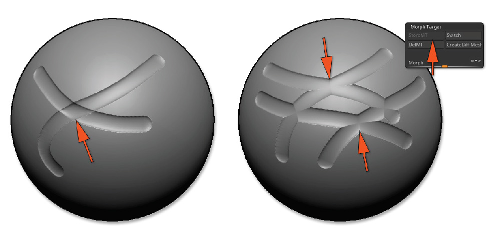

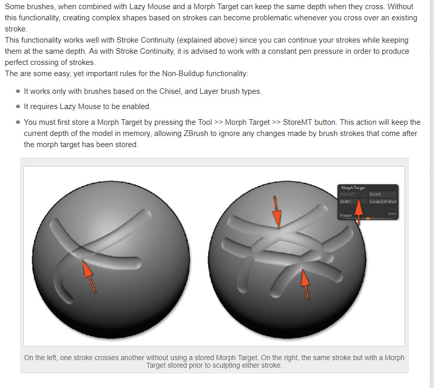

I have a problem with new system for non-overlapping strokes:
Documentation for Lazy Mouse 2.0 says non-buildup for overlapping strokes should only work with both Lazy mouse AND morph target enabled.
http://docs.pixologic.com/user-guide/3d-modeling/sculpting/sculpting-brushes/lazy-mouse-2-0/
In reality just making a MT with no Lazy mouse makes it work. As a result Clay brush and Clay tubes become close to unusable, acting as single-height layer brush. Is this intended or I get it wrong?
http://docs.pixologic.com/user-guide…azy-mouse-2-0/

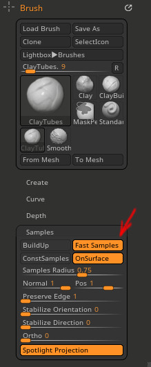

Snapping - yes, works only with Lazy Mouse, because it is defined by Snap Radius in Lazy mouse.
Im talking not about snapping, but about non-overlapping strokes, which, for me, starts working with storing Morph Target (Lazy mouse disabled or enabled - doesnt matter).
This makes clay and clay tubes unusable. Clay Buildup works fine.
Buildup under Brush>> Samples in 4R8 is on with Clay Buildup, off with Clay and Clay Tubes. This is the same setup as in 4R7.
PS. video screengrab to illustrate the issue
[video=youtube_share;cFCuqT6gs48]https://youtu.be/cFCuqT6gs48[/video]4R8_62.jpg
@Indik
Enable Fast Samples under Brush > Samples
S-ed ,
Thanks, fast samples indeed solve the problem, although it looks more like a workaround than a logical solution.
With fast samples enabled non-overlapping strokes don`t work at all (when I need them), regardless of lazy mouse <<- this contradicts official user guide
As clay brushes are one of the most popular ones, and morph targets are core functionality of Zbrush, I imagine many people will be frustrated by this.
