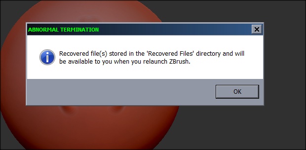

So far I have been able to repeat this every time.
  1. Select Cube3D, draw on canvas, enable Edit mode, Make Polymesh3D.
  2. Subdivide to level 4 then Ctrl+Z back so there are no SubD levels, then subdivide again. Crash!
It is because of the Undo History, because if you ā€˜Delete UH’ after you Ctrl+Z back to 0 SubD levels you can then subdivide again without it crashing.

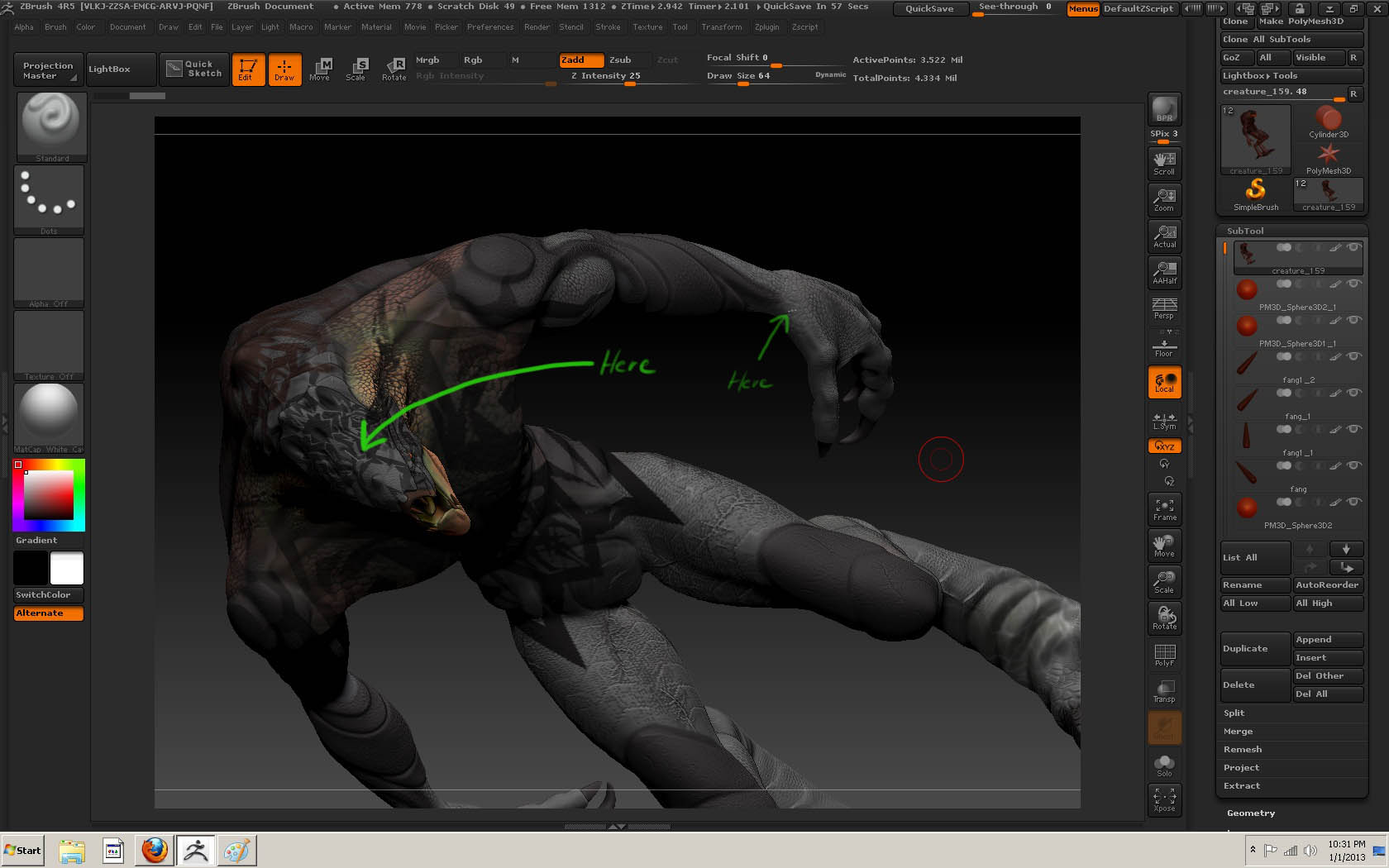

Hi all, I upgraded to 4R5 last week and I started using it today and noticed a weird display problem. These white ā€œlinesā€, that appear to be geometry, just happen to be displaying on my model, even when I rotate it. They will somehow remain fixed, but move to another part of the model. Please see images. I checked my textures and polypaint menus, and there is nothing that indicates it’s a texture problem. I restarted the program, and the glitch remains. Has anyone else experienced this issue with the new upgrade? I’m really hoping a patch is released soon.

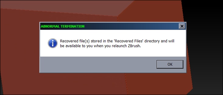

I get this every time after I have Undo (Ctrl+Z) a couple of times then go to subdivide the mesh. Answer OK to error and it crashes to desktop. I hope this gets fixed in the next update.
Just did it twice in a row, once with sphere and once with cylinder. Same error.

JD. I had the same thing. If I’m not mistaken, those are simply incomplete curves, I dragged mine out of the main mesh using one of the curve brushes, then deleted the generated geometry.

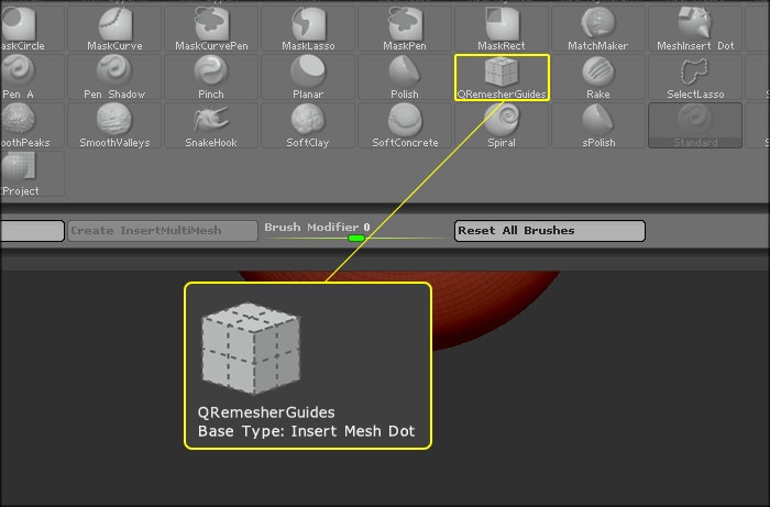

QRemesherGuides in the brush palette.
Guess I’m a blind old coot… thanks.
I found the tuts at pixologic under topology… was looking for qremesher
Also the topo brush in the brush palettes…
