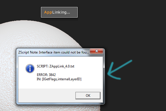

Hello Aurick & mates,
I’m getting this Errror while using ZAPPlink … is there any solution for this ???
Thanks!
Hi Gabo, Thanks for getting back to me. …
just a minute here! I just did a check and now everything is popping up. Maybe I needed to restart my Mac, which I did. In any case “The Grinch who stole my Brushes” seems to have left the building!
Sorry and thanks again.
Pixologic: Thanks for the info. I’ll need to stick with 4r4 unfortunately, until this problem is fixed, as I’m using zApplink quite a bit. I look forward to the fix.

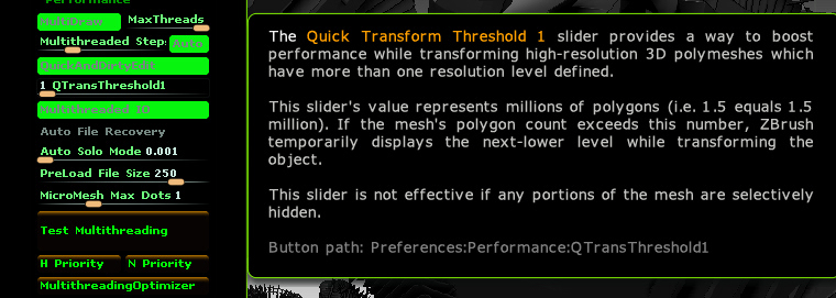

Zbrush 4R5 works REALLY SLOW
The interface I mean, spin model (15K poly) is really annoying… Rotates with discrete delay… =(((((
And Z4R4 - works FINE the same time.
Unless things have changed with 4R5. The following would apply.
http://www.zbrushcentral.com/showthread.php?174484-What-Hardware-upgrade-would-increase-ZBrush-performance&p=990997&viewfull=1#post990997
In 4R5; I have 7+ mil polys on my screen right now, no noticable delay when scaling, moving or rotating the view, at all. There are some settings in preferences. Mine are still at the default.
