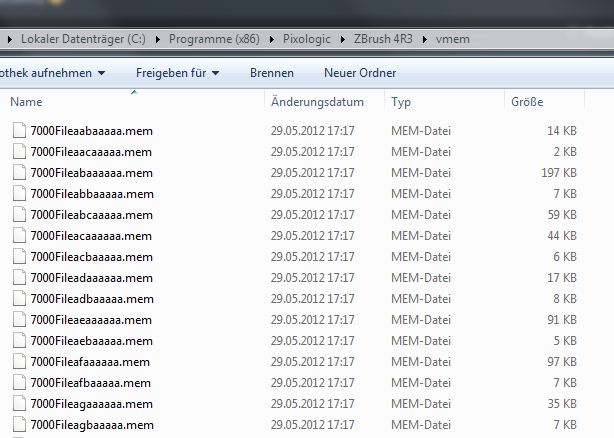

Thank you very much for your efforts. The computer is brand new I got it last week, Zbrush is installed on an SSD drive with lots of free space there should not be any bad sectors. Where in the Zbrush folder is that virtual memory data?
vmem
I tried Sculpting and rendering a polymesh with over 14 million points or a dynamesh resolution of 1024 with out any Problems. I get that error only when I add surface noise or fibermesh and close the programm. By the way that vmem text files are all empty.
.txt file empty? should be .mem, they are made when zbrush is running.
Oh, I see. When its closed there is just an emty text file. But as you can see from the screenshot it looks like Zbrush writes data to that folder.
