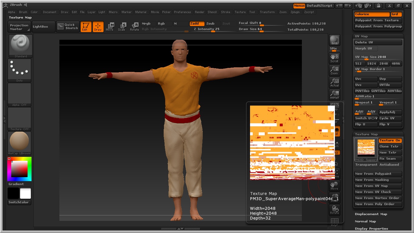

Hello there, I’m very new to ZBrush so I’m sorry if this seems a fairly obvious problem (I have the feeling it might be), but I’ve just started playing around with ZBrush and I’m trying to export a UV map from a polypaint, but it’s not working.
Attached is a screencap of what my uv map looks like in the interface.
I started with making a texture map and then choosing “uv map from polypaint”; however I found that on trying to do this a second time and re-opening my model, I can’t seem to change the subdivision level which might have something to do with this? (The slider for the subdivisions are grayed out and frozen)
I’m running Windows 7 64-bit, with i5 CPU and 6 GB RAM; let me know if I need to provide more information or other screenshots, and thanks!
