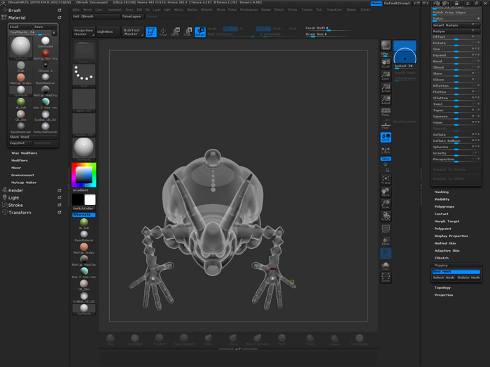

Then I create a ZSphere Rig as you can see here:
I tried to fill out empty space as good as I could
After the Rig is finished I click BIND MESH under RIGGING menu

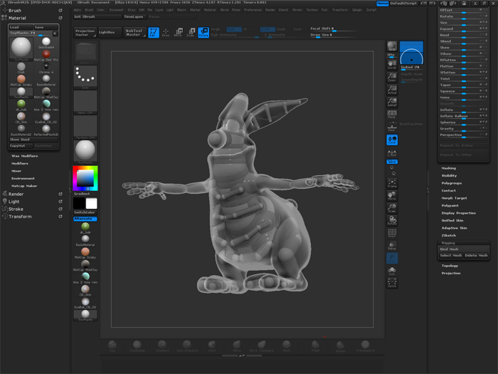

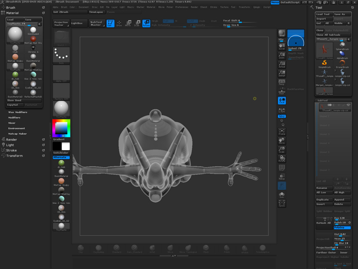

After this process is done I rotate the ZSpheres with the binded mesh - nothing is masked!
This happens:

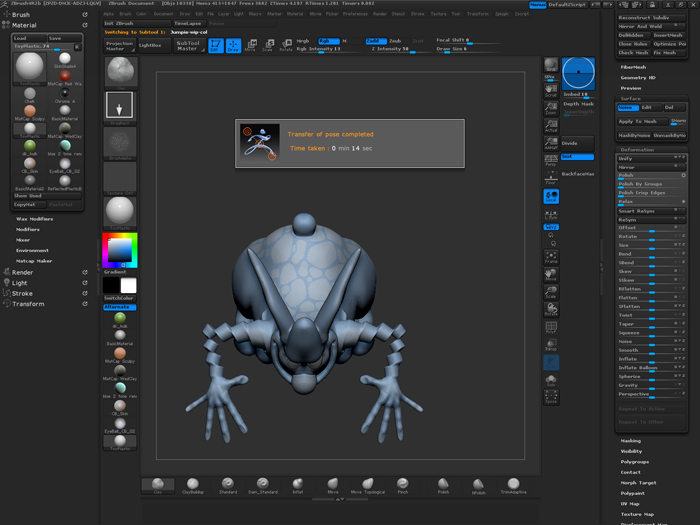

Then I click TPose>SubT under TPose Master Plugin…
after some calculation by Zbrush this appears - actaully what you can expect already:
So what is the problem here - is it me? Is it a bug of Zbrush?

After all I made a model without any use of dynamesh - at least now I was able to pose the model without strange stretchings and messing up the mesh - but still there seems a problem: The subtools get deformed after posing.
So I’m asking again - since noone ever replied to my post - does anyone have the same problem?
  1. Unable to pose a DYNAMESH model with TPose Plugin - either way (with ZSphere Rig or Transpose Tools - both mess up the model)
  2. Subtools get deformed during posing process and stay that way after posing is finished…
