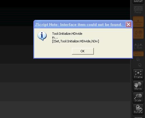

I’m also having this issue. I can’t get any of the curve brushes to work on objects with multiple subdivision levels.

curve brushes can be used only if the subtool hasn’t subdivision levels…probably it is useful with dynames, but work with them to define a end model it is impossible!

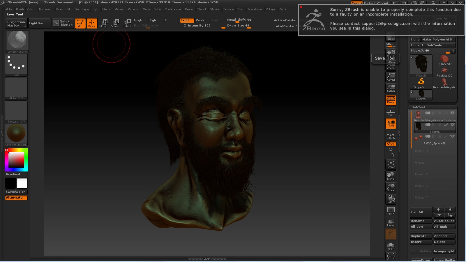

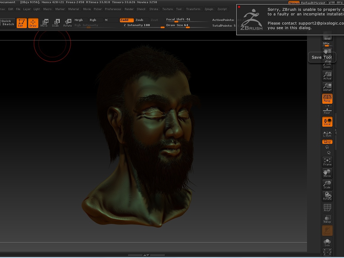

Hi guys! Happy Monday!!!
This just happened trying to save something I dont even like, please pardon how badly it sucks…
The annoying bit is in the upper right.
EDIT:
Ok I just noticed those goddamed dots are back in the title bar as well (over on the right).
(amusingly you can also see that the window has done its nasty little trick of un-fullscreening it self again)
So this means I need to reinstall right? If so which version? Do I start at 4.0 or just go right to 4R2? And
if I do that should I then try 4R2b again?
EDIT OF EDIT:
I also just realized that this model is the one I was working on when I first got the regestration problem, could
this be related to the .ZTL? If so I can send that along as well, I was also recording the process in timelapse
and that stopped working while I was working on this bit…
EDIT OF EDITED EDIT:
I just fired it up again after rebooting and its working, opened the same .ZTL and messed with it and saved it just fine.
Then I closed ZBrush, fired it back up, loaded both the movie and the .ZTL and did some more work (he’s better
looking now) and re-saved both, that worked fine but I caught video of two other bugs happening at the same
time, one is the snapshot one and the other is an old version of the ZTL being plopped into the canvas.
Subedit: I didn’t record it, the movie thingy turned it self off… This keeps happening too.
Amusingly you can also see that the window has done its nasty little trick of un-fullscreening it self again!

I can’t use the Stroke curve mode on a model with subdivisions or layers.
When trying to draw a curve I get those error messages: " The mesh is composed of multiple sudbdivision levels. Action cancelled." or " The mesh has layers. Action cancelled."
