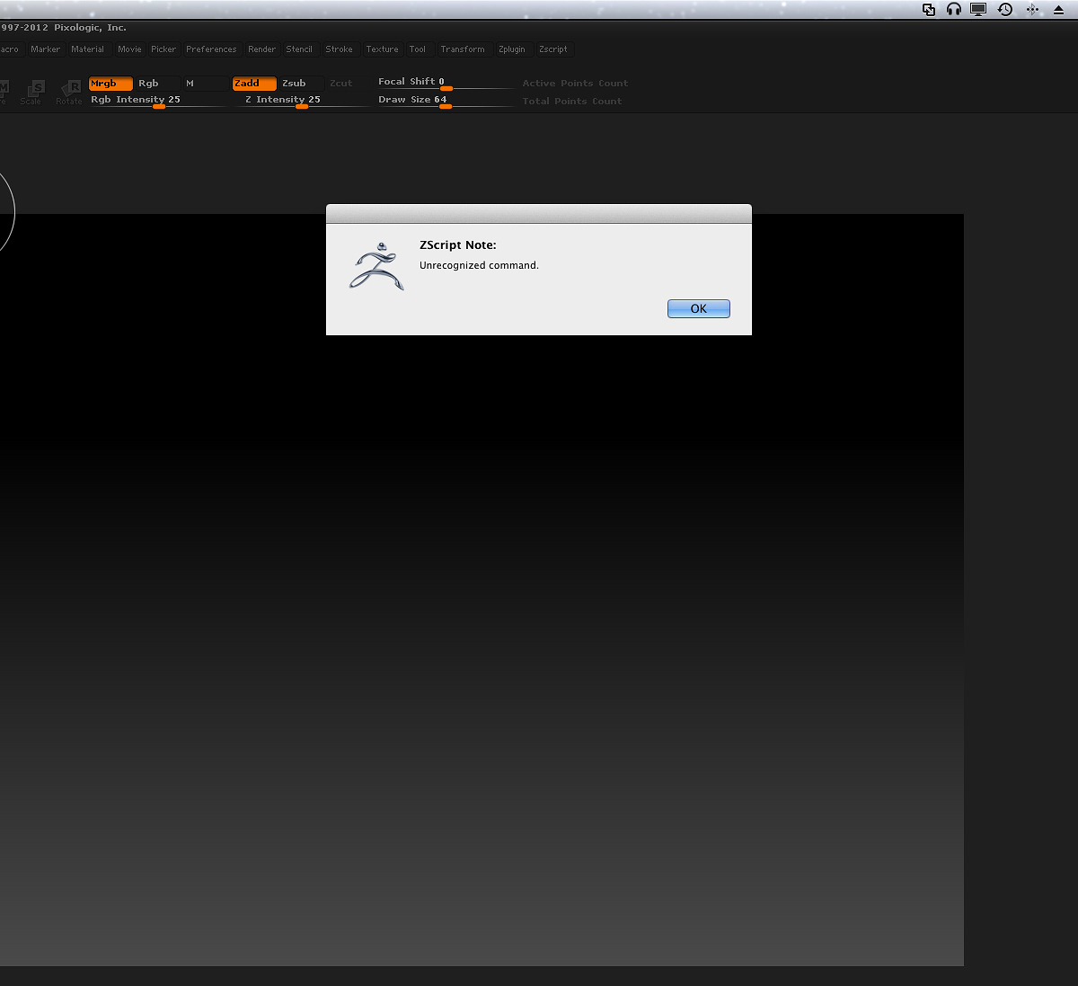

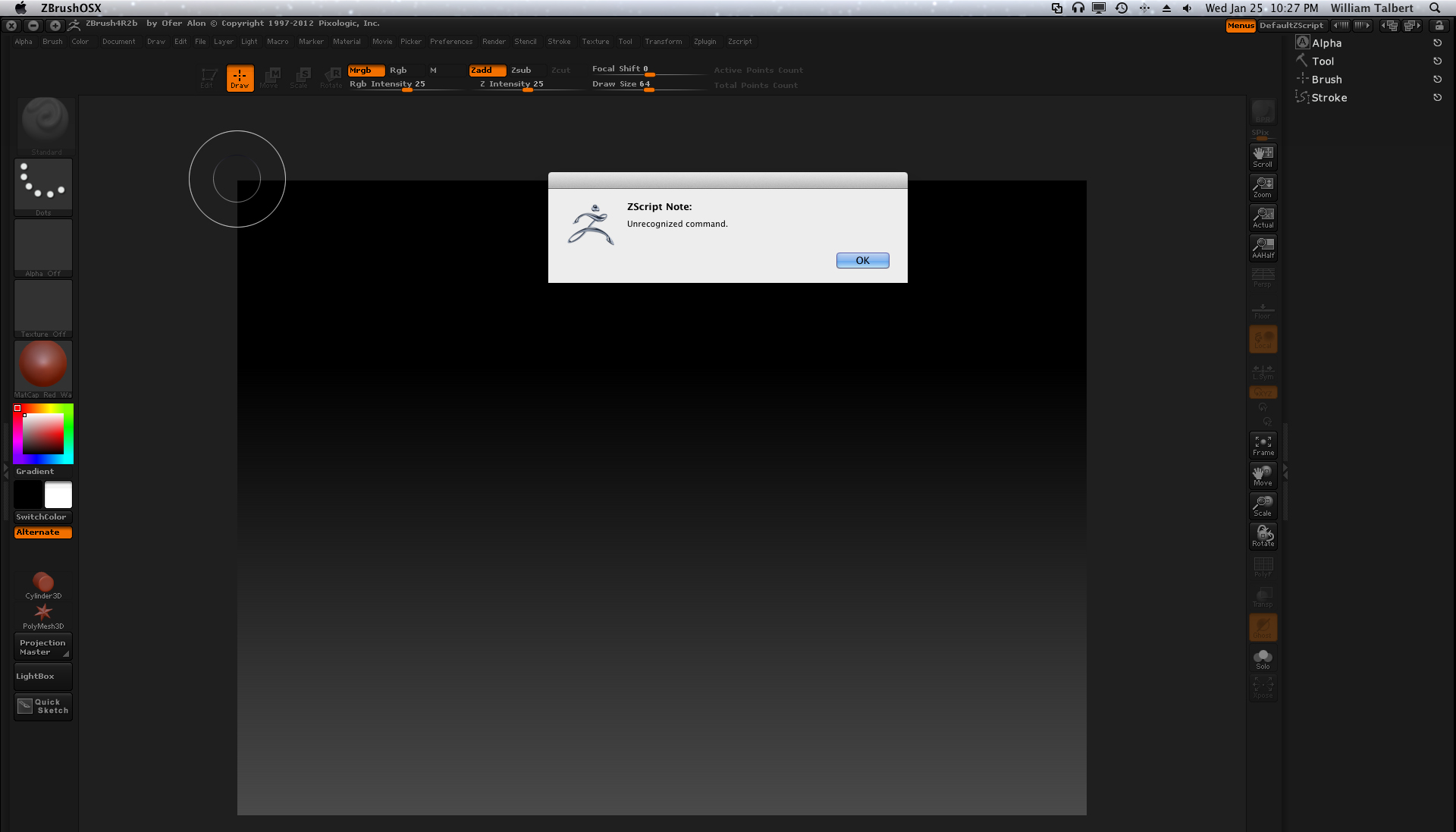

I’m having the same problem on my Mac with the “ZScript Note: Unrecognized Command” error followed by ZBrush crashing.
In trying to figure it out I deactivated ZBrush and copied the original program directory to storage, then deleted and reinstalled ZBrush. I started the program and closed it about 10 times without getting the error again.
I started making some customizations. Nothing major. When I quit and restarted, the error returned. I deleted the customization files in the ZStartup directory and ZBrush opened fine 6-8 times back to back. When I made some simple changes and saved a new configuration file in Preferences, I would start getting the error again. Delete the CustomUserInterface4R2.cfg file and ZBrush would start again with out error (with one exception). So I tried some basic changes in Preferences, storing the UI change and testing by restarting several times. Then I’d move the UI config file out of ZBrush and start again storing a new change. I got the error on all of them, although it was random and not every time program restarted. The UI changes I made included color in the interface colors, using the Multi-threading Optimizer under Preferences > Performance, changing the Pull Down Border setting under Preferences > Interface, assigning a new hot key to the Lightbox button and finally, rearranging a few of the UI items.
The one exception was that I got the error on the first restart after moving the UI config file to test a different setting. There was no config file and I got the error only on the first restart of about 5 or 6 that time.
I don’t know if that helps any. If you want the crash reports from my system or copies of the config files that caused the error or other info, let me know. I included two screen shots. The first is the error and the second is the title bar after I restarted since the shot with the error didn’t have any of the additional info up there. Also, I haven’t opened a Support Ticket yet since I wanted to check the forum first.

Hey, The “Unrecognized command” error at start-up…
Aside from this issue, Zbrush has been working very well…even after many single, several hour work sessions.
It’s just this, 98% repeatable Application launch issue.
I’m well pleased…just a bit annoyed…

I backed up my Zbrush Folder.Deactivated Zbrush 4R2 and ran the 4R2b update. When startingZbrush. a pop up window ‘Zscript Note:’ appeared saying “Unrecognizedcommand.” My only solution was to uninstall and reinstall Zbrush4R2, then run the 4R2b update for the second time. Now Zbrush 4R2bworks. Unfortunately now all the custom brushes, materials, alphasetc. have to be transfered to the new Zbrush install.

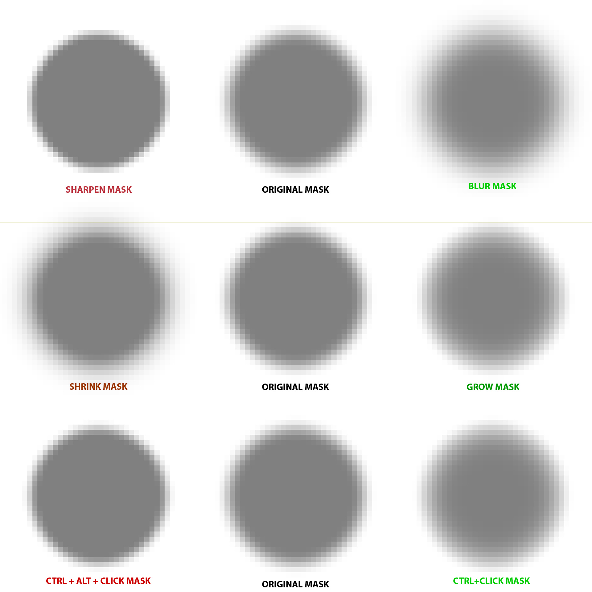

I posted about this but no one seems interested so this will be the last I mention it. I am including screen shots of a test I did in ZBrush 4R2B, an outline of the problem, and system specs below. Any clarification/confirmation would be welcome.
PROBLEM: The new Grow Mask and Shrink Mask functions in ZB4R2 were programmed to the wrong buttons. After reading the docs carefully (it is mislabeled Extend instead of Grow BTW) I can’t reconcile their behavior except to say that it looks like they are reversed. NOTE - This isn’t some hotkey mapping issue or custom UI gone wrong, just the actual functions of the buttons being misplaced on your end.
ADDITIONAL: Also, the CTRL+Click and CTRL+ALT+Click commands with masks don’t seem correspond to what the docs say:
The CTRL+Click and CTRL+ALT+Click shortcuts are now assigned to the Extend
and Shrink Mask functions rather than to the Blur and Sharpen Mask functions.
CTRL+Click seems to be setup to Grow Mask (which is really Shrink), but CTRL+ALT+Click seems to still Sharpen Mask.
TEST: A Plane with a mask in the center and single click tests of Blur/Sharpen/Grow/Shrink. I always reverted (using undo) to the original mask. Note the thin line I added to highlight the problem with Shrink/Grow being programmed wrong.
CONCLUSIONS:
  • Shrink Mask actually extends the mask beyond its original border and does not reflect its definition in the docs or common sense.
  • Grow Mask actually shrinks the mask in from its original border and does not reflect its definition in the docs or common sense.
  • CTRL+Click is setup to Grow Mask, but since that functionality is wrong it is confusing as to the actual intent of the command.
  • CTRL+ALT+Click is set to Sharpen Mask despite the fact that the documentation says it should now default to Shrink Mask.
SPECS: ZBrush 4R2B, Win 7x64, Quadro 5000, Dual Xeon X5690
Again, any clarification would be welcome. Thanks,
-nbreslow
