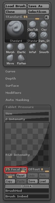

Low opacity on masking - is there a setting to fix this?:
I have the same issue as PrayingMantis. All brushes have 75% on RGB focal shift. All the standard brushes at least have this problem. Is there another solution than recording some macro to fix this for all brushes?

As far as the masking goes. I am not having any issues with masking and my brushes have RGB set at 100 by default. You can change your masking dimming though by going into the Preferences>Draw>Masking Dimming. the default is 4 but it only goes up to 5. Could you give me screenshots or a video of your issue.

“As far as the masking goes. I am not having any issues with masking and my brushes have RGB set at 100 by default”
I’ve got a problem with RGB focal shift. For some reason, all brushes have 75% setting on RGB focal shift when I open Zbrush.

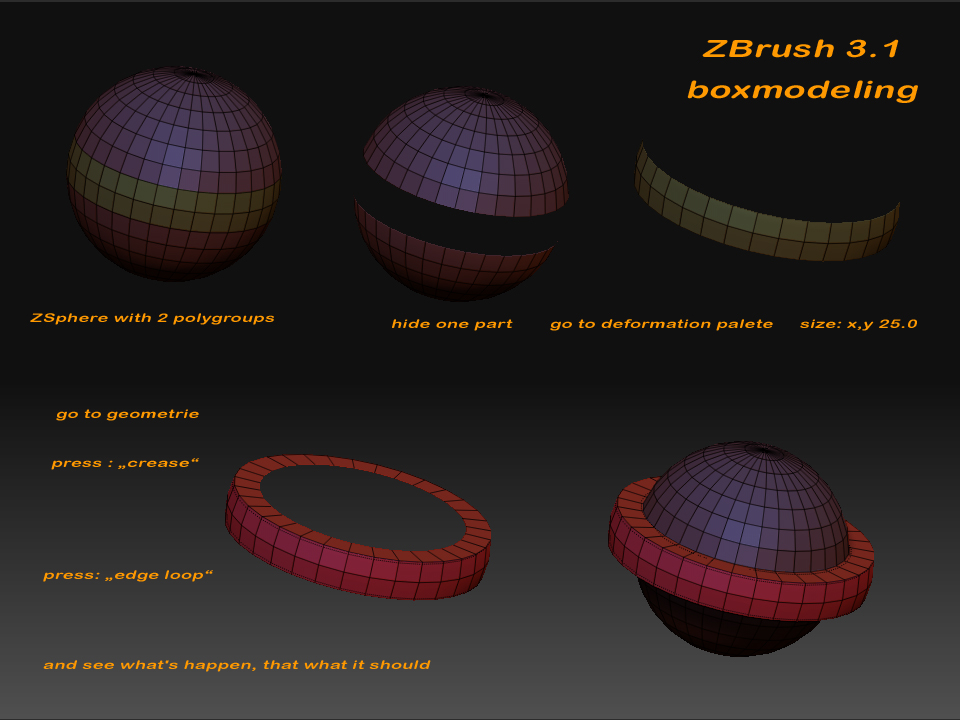

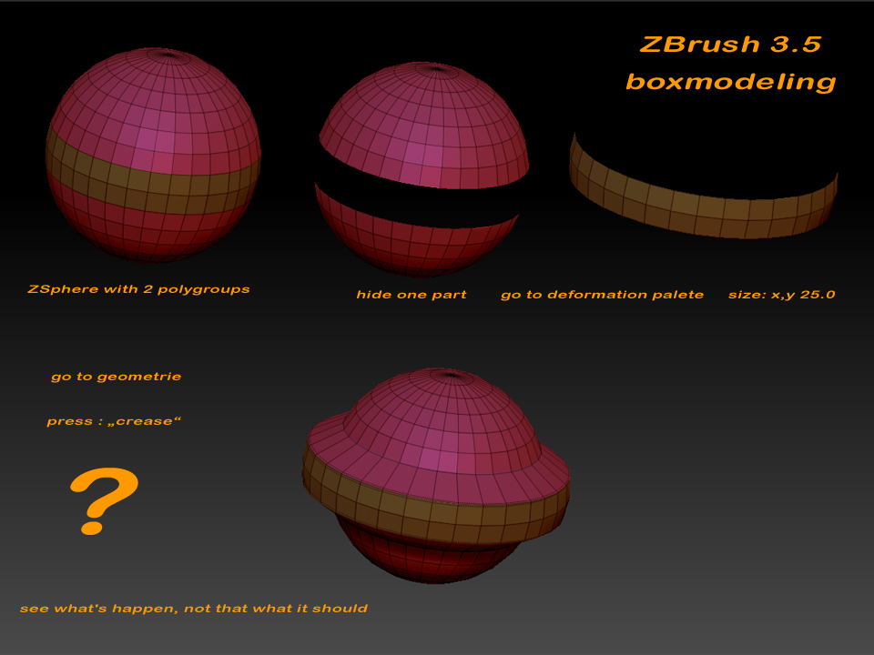

Dear Aurick at Pixologic and all ZBrush users. Please can you check if you got the same wrong working function as i have on ZBrush 3.5R2
Next point:
I start ZBrush 3.5R2 and then i clear my layer. Now i chose a texture
from the texture pallete and and press “CropAndFill”.
ZBrush 3.5R2 crashes down!
So, if i start ZBrush 3.5R2 and first initialize it and then take a texture and press
“CropAndFill”, then ZBrush 3.5R2 doesn’t crash down.
And on the Plugin " SubToolMaster " is Hi Res All and Low Res All not working well.
It doesn’t work to all subtools.
So if you all got the same problems, so please Pixologic could you fix that.
Please can you do this with another update. I dont would like to wait for the fixed ZBrush 4
Btw. Pixologic i still missing this great, great " IExtr " function of ZBrush 2.
Please can you bring it back on ZBrush 4.
Because i’m working now with ZBrush2, ZBrush3.1 and ZBrush3.5R2
Sorry, but on every new version of Zbrush is some old stuff who doesn’t work right.
Greets
Roland Kaiser

Roland, in your first example you didn’t write that you are hitting edge loop, which you did in the second, i’ve tested it and that is what the problem is but yes it is working differently.
Although one behavior between 3.1 and 3.5r2 that i’m seeing is that if you don’t hit edgeloop and just do crease, 3.1 will leave the hidden part hidden, whereas 3.5r2 will unhide the model. This is a problem if you want to crease a certain area and then edgeloop it, it looks like for now you will have to crease it before the deformation, then deform and edgeloop.

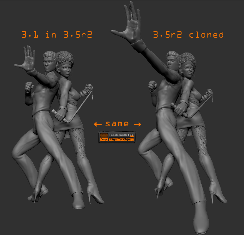

I’ve noticed that if you load a tool from 3.1 and enable perspective it is weak, regardless of “align to object”.
However, if you then CLONE all the subtools and do the EXACT same perspective, it works as it should, so there is some sort of issue when loading old tools.
