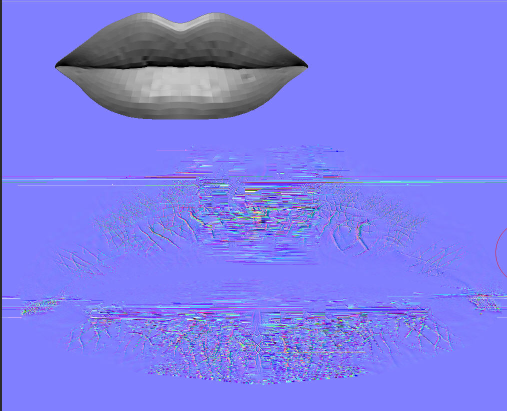

I realy love to use 3.5, but I simply cant make maps without distortions for multiple Uvs.Here are some things that iv noted that hinder work flow, or fail to work.
1: when wil Texture maps have smooth Uvs.
2: When will I beable to use multiple Uvs without distortions?
