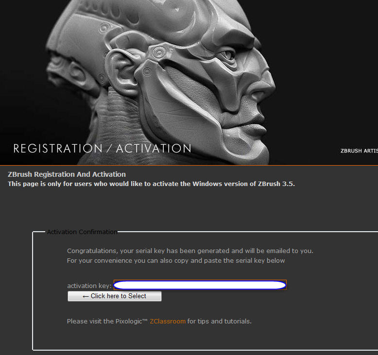

I clicked on web activate. Filled out the form and activate. I then see the screen shot below.
Windows Visat 64 ultimate, latest updates, 8gb ram. I put Zbrush in the Programfiles x86/ Pixologic folder kept in its own 3.5 folder. I applied the patch from the trouble shooting folder right about then activated it. Note I saw the Java screen for 3 seconds for thie page showed.
