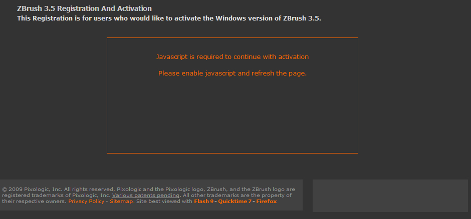

I tried to do web activation. After filling in my information on the form that comes up and hitting the “Start Activation” button, it takes me to the confirmation.php page and nothing else happens. I don’t get any code to input or anything.
Please make sure that you have the most current version of Java installed. You can get it from http://java.com
It’s possible that your version is out of date and so the pages are not working correctly.

I clicked on web activate. Filled out the form and activate. I then see the screen shot below.
Windows Visat 64 ultimate, latest updates, 8gb ram. I put Zbrush in the Programfiles x86/ Pixologic folder kept in its own 3.5 folder. I applied the patch from the trouble shooting folder right about then activated it. Note I saw the Java screen for 3 seconds for thie page showed.
Well I’ve been testing the javascript issue all day. I’ve tested it on vista 64bit and 32bit as well as xp 32bit. I have the same issue on all 3 pc’s. So it could be an issue with my router or something.
