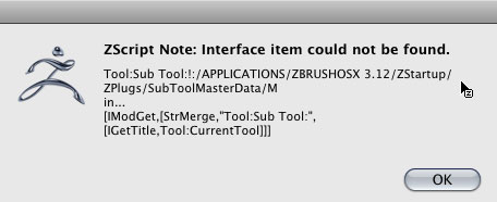

I don’t understand something. Aurick said that Transpose Master is NOT supported i the 3.12 version. Is that the trouble I’m having?
I keep getting this message.
electricCAT,
Apologies for the delay in replying. Transpose Master for ZBrush 3.12 OSX is supported.
Are you still getting this error? Make sure you save your ztool to a folder such as ZTools.
Thanks for the response. It’s too late for me now (Action Hero Contest deadline today) but I’ll try it later.

The contest now over, so i tested a different model with Transpose Master. It worked at first, then I went back to the subtool version, still everything okay. Then I subdivided the mesh on a few subtools and tried the TM again and that’s when I get the error message. I selected the second subtool down and it worked. i selected the top subtool and I rcieved the error message again. What is is looking for?
