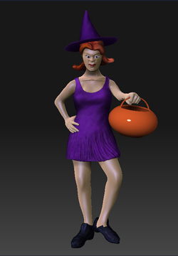

Thanks for the update! I have been experimenting with it again and it seems to work really slick. Except on a model like this one where the bucket is a really dense mesh with no subdivsions( made with extraction, I think?).
When I use it on a tool that has a subtool like this ZB freezes. I did a fair amount of experimenting (deleting various subtools out) and am pretty sure its the bucket that is doing it.

Thanks, it is possible that a very dense mesh is causing the problems. Transpose, and therefore Transpose Master, work best where the lowest subdivision levels produce a combined mesh of about 250,000 polys maximum.
