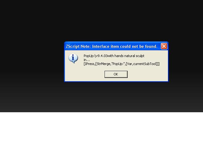

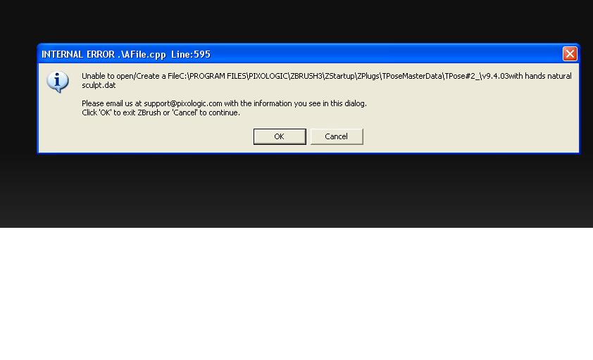

The masking think isnt a major problem as I can eventualy get all hidden using inverse mask with lasso. The Interface error im not sure about and unfortunatly its my major project file of my female sculpt, its a big file to post up. I will try to see it it does it at a lower Sub D level and then try again.
Here are two errors im getting, I will try some more models later on.
tez,
Are you using a backslash [] in the filename of your mesh? If you are then that will be confusing the plugin. Extra periods [.] are also best avoided.

The file name was v9.5with hands natural sculpt.ZTL. I renamed it shorter and it now works. Not sure why this was but its solved, thankyou.

tez,
I’m glad that helped solve your problem. If you can avoid using periods in file and subtool names then that would be good too. Zscript can have trouble extracting the path in those circumstances.

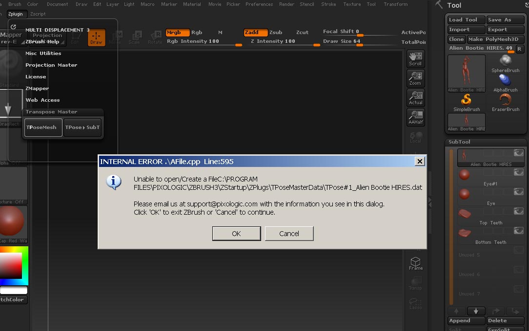

I don’t think I saw anyone answer Palovichs problem. I have the same problem with it.
murmur,
I think Pavlovich’s problem is to do with a removable drive, although he hasn’t confirmed this. That issue will be fixed in the next update.
Your problem, I think, is different. It appears that you don’t have a TPoseMasterData folder in the ZStartup\ZPlugs folder. If this is the case, you haven’t installed the plugin correctly.
