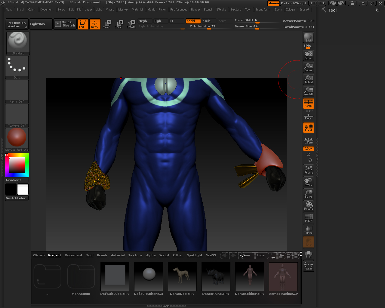

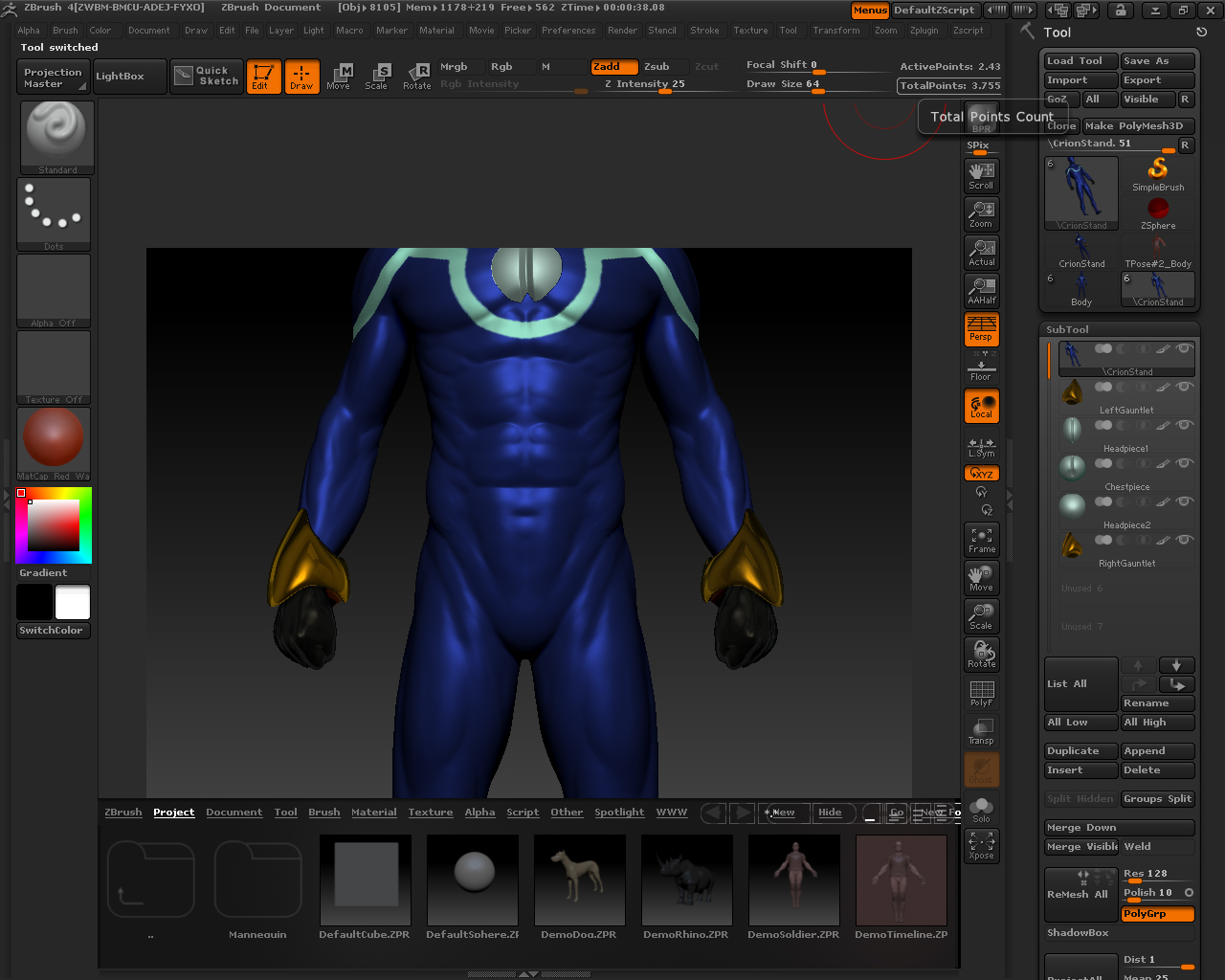

aight im having a problem with transpose master while using zbrush 4. i have a model with 5 subtools. and no matter what i do when i try to revert the low-res changes to my hi-res model, a few subtools lose their color, some subtools are deformed, and one certain subtool ALWAYS turns into this crazy ball of aluminum foil. I’ve searched the internet and it seems a couple people have had this problem too. unfortunately, the best help they were given was advice to “deduce like sherlock holmes.” can somebody PLEASE PLEASE help me with this?
(first pic is before i click “transfer to subtools.” second pic is after)
mooblah6,
I would guess you mirrored the Right & Left Gauntlet? This can cause the normals to flip when importing, with the result that you see. If you merge the two subtools together Transpose Master will pose them correctly - but you will need to start over with the posing.
