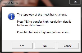

I’m using Zbrush 4 with the latest Transpose Master …
There seems to be a bug where if I import an Obj that I exported from 3DS Max 2011, the transpose master just doesnt work!
I get either of these 2 problematic resulting errors:
a) As in the Jpg attached - it says the topology of the mesh has changed and hence asking if I want to delete or project on the new one…either choice will result in parts of the mesh exploding (verts snapping to incorrect positions)
or
b) It cant find the original mesh and gives me the errors of “polygon mismatch” and " mesh not found", so it grabs the basic PolyMesh3D star from the library to replace it.
Transpose Master works fine for all things Zbrush related - e.g. on the demo soldier. But once the import is from an OBJ in 3DS Max it doesnt like it. I’ve tried all the different options of exporting in 3DS Max but doesnt seem to have much difference. Also, I havent had any problems with OBJs from Max before and I can still use this method to update the model at any subdivision level (so technically on that front, the vert orders havent been changed by the obj export).
Can’t figure it out! Though I’ve noticed that by just turning on the SUBTOOL MASTER plugin and do nothing, turn it off. Only then, turn on the TRANSPOSE MASTER- I get a slightly different result - on the odd occasion/model, it works there after.
Anyone have similar problems with this - is there a known bug in Transpose Master with Z4?
Any help much appreciated…going crazy here!

I have had the same errors ptsang is describing. What I discovered was my mesh out of max was corrupt. There were odd ngons or extra verts tucked away in the max mesh that I had missed. Could be the reason meshes that are made in zbrush from scratch don’t get the errors you are talking about.
I am very careful when it comes to modelling and check my meshes in xview routinely, but what I got from my experience is that when zbrush acts strangely its mostly to do with something in the mesh. Hope that helps.
Hi kanga
I think you are spot on there. I’ve concluded that it must be the mesh that’s corrupted.
And from your suggestion I had a look to see if there were some stray verts or ngons etc, there were some but nothing that would obviously make it explode in some parts when the transpose master is used. What I did was fixed or did a general weld on the verts- created some triangles bit was enough for me to test it out back in zbrush and finally - it works as it should.
Will have a look in the morning to see if i cam clean it up and maintain the mesh I created. It must be the max tools I used to retopologised as it can easily create twisted polys or extra verts or zero area polys etc etc…
So gotta be careful as you say.
May stick to zbrushes retopology method from now on to avoid the hassle!!
But it should have implemented the ability to move the vert and snap to the surface of the high res sculpt all the time in move mode!
Thanks for the replies!
Phil

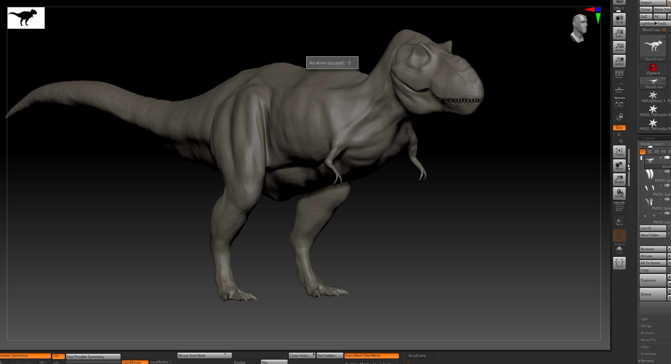

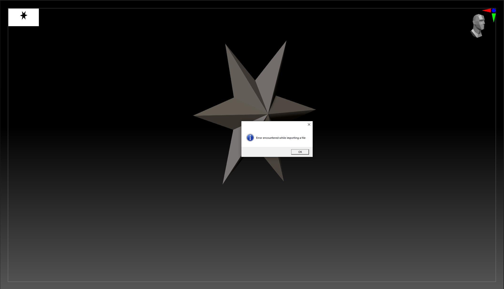

When I use TPOSEMESH, I receive the following message: “An error occured: -5”, then when I click mouse button, a new subtool with the PM3D_TMPoolyMesh is created just with a star. And a popup window with the title “Unable To Open File” with a path, the images attached show the problem. I discovered that the problem is on the subtool, I´ve zremeshed, tried to delete hidden meshs and didn´t solve the issue.
What shoul I do?
I use zbrush 2024, windows 10, 64 Gb ram, Ryzen 9
