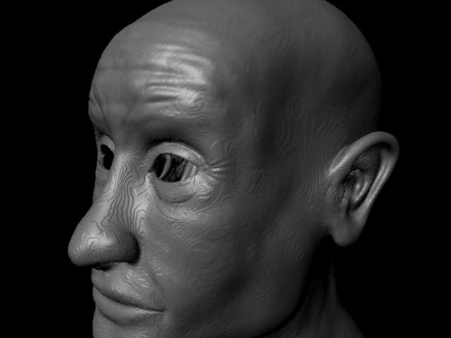

Here is my WIP Head…No Disp. map, just 2 million Polygons, and some minor detail… “Can there be such pain”? Hope you all like…
…D…
