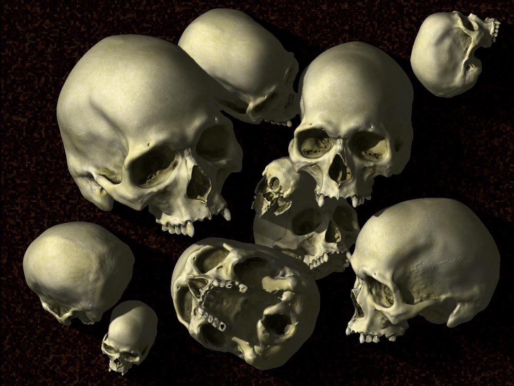

Todays work so far, Model is still a work in progress. Thanks for the answer to my question I’ll just paint it dark in there
I have to say you are too good to be true…I hope you ar emaking a living at this? My question on the skulls…3d sphere or Zsphere…and how did you do the teeth? Are they multimarked into place after modeling the skull? Outstanding work. It’s been a pleasure getting notification of your postings each time. Truly.

Ron. I used zspheres. Big one for the head 3 smaller ones pushed in for the eyes and nose. for the teeth I did what the guy who did the cool angler fish in the quick time video did ,painted an alpha mask inverted it and moved them out. It didn’t work very well I spent too much time trying to clean them up and not very successfully. In fact that is why he has no front teeth. I was planning on doing the multimarker deal for them. I spent about 4hours modeling it .It would have taken less time but I did a really dumb thing.I did some modeling ,did a save as, modeled for about an hour lots of detail especially on the underside thought It’s time to save again, so did save as again, when it asked me if I wanted to replace the existing model with this new one I mistakenly pushed no and lost all of that work. what a jerk I just had to laugh. Glad you like it.

Great skull , Monstermaker …how did you do the zygomatic…i did a skull in Zbrush, with Zspheres, but had to use Silo to “cut” the zygomatic arch loose from the skull !

tez, and artwooki, I’m not in the 3d industry haven’t even been doing this for five weeks let alone five years. I’m not even sure what a zscript is and I have no idea how to make one.
Jantim,The zygomatic arch isn’t cut, infact I asked a question about how to do that tried to post an image and it didn’t work then either . What I did is just pushed the ,what do you call it digital clay?, as far in as I could from the top and botton view and painted it dark.
