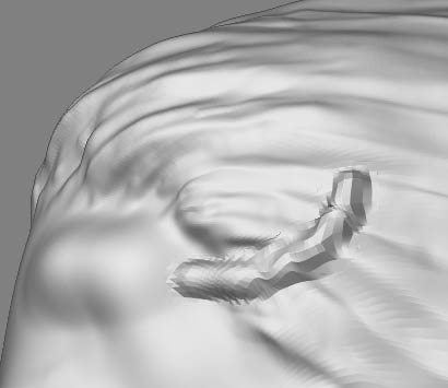

So i’ve really had NO problems running it on my macbook pro with 2 gigs, it actually runs a bit better then my dualcore AMD with 2 gigs. So i’m quite happy. The only bug i DO have is that my redraw doesn’t seem to work right (compared to the demo on the PC). Basically as i’m drawing my model rezes itself down a couple of steps, and even sometimes draws a “rect” around the drawing area. It fixes itself after it rotate or move the model, but its making it quite difficult to make fine details. Has anyone else seen this? Is this just a video issue?

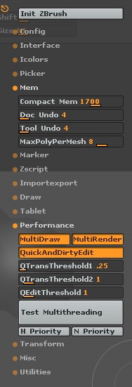

shonuffhome, can you tell us wht your preferences are set at in Zbrush for memory and performance?

Right now i have them set to whatever default is, but i have 2 gigs on my mac, and its an intel core 2 duo… so it should run pretty well. On my PC i have the same settings (for the demo version) and it doesn’t have these problems, the redraw issues.

shonuffhome, try these settings in the image below. Now I have no redraw issues and your the first to post them. I’ve not even seen that issue on a Mac Mini which gets it’s graphic memory by sharing with the system heap. So you’ll have to help me out a bit. What else did you install? All software up-to-date?

Heya Jason. I’ll try these settings to see if they help. basically is a free macbook pro, i have installed blender (actually checking it out) and maya 8.5, photoshop, but thats about it. Has all the standard mac osx stuff on there, itunes, etc. nothing fancy.

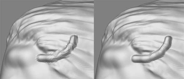

ok so i reset my memory to what you’ve included and it didn’t make any difference. Here is an example of what i’ve got, included in comp.jpg… left side of image. Basically if and once i edit i get this look, then i simply rotate the view (even just a pixle) and it redraws to the comp.jpg, right side of image. it makes it hard to validate any edits because i have to constantly edit, rotate, edit, rotate. The bigger problem is that when i’m drawing it looks like that, very low quality… even has a small rectangle around the draw area. Its causing a high level of frustration. :slight_smile:

As for your drawing issues, not quite what the terms you used imply. I’ve seen this before, I believe Aurick or Ryan posted a solution on the forum previously on a couple of occasssions. I’ll have to think about it, I remember it’s a simple fix, but not what that is…
