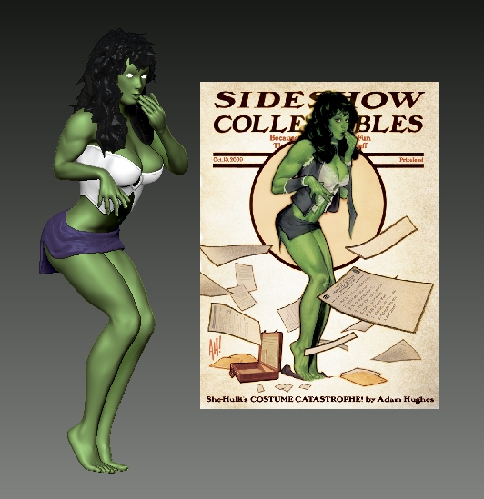

A fun and funny she Hulk model I came across looking though some of my old files. I had started this last year and revisited a bit the last couple of days. The illustration to the right by Adam Hughes was my reference.
Have fun Zbrushing and a great Super-Bowl weekend everyone.
Ezra

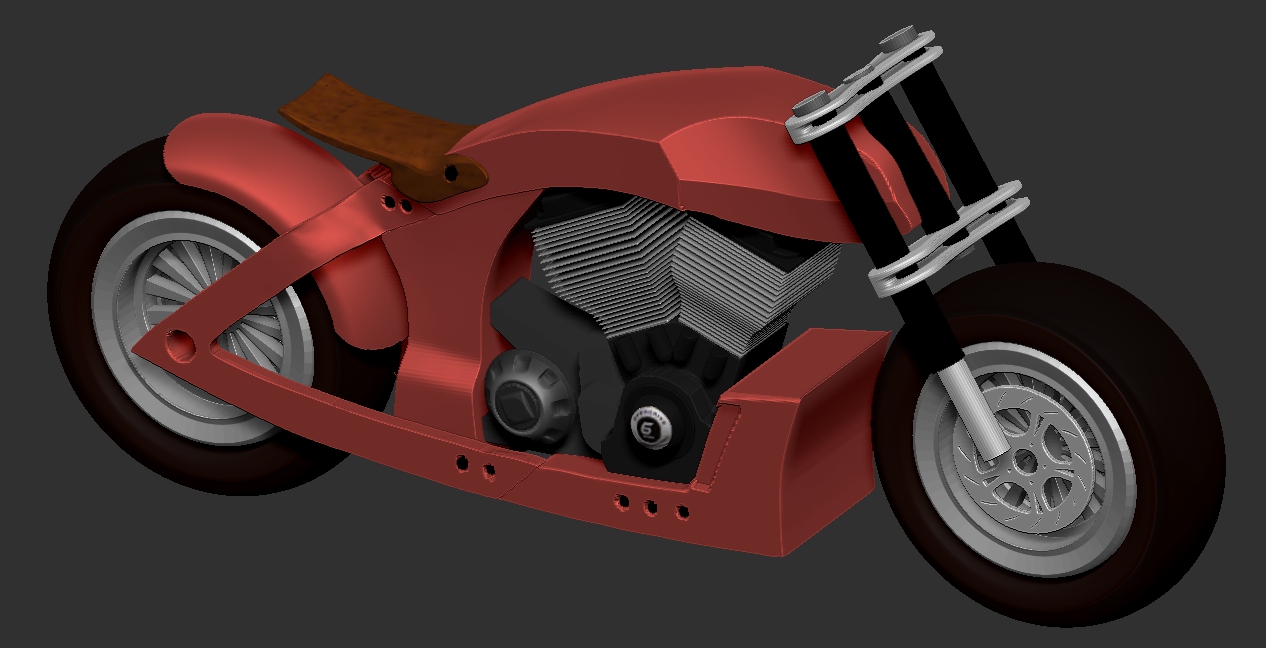

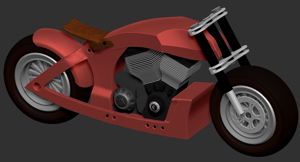

A bike WIP I started a while back and am revisiting.
Have fun Zbrushing all.
Ezra
Wow did you make this model with shadowbox?
Really looking forward to the end sculpt of the hardsurface bike!
Keep it going Ezra mate,:+1:
Cheers and happy sculpting.
Kenny:)
Hi Kenny,
Thanks for stopping by. I typically use extractions from a plane that I put a photo image on a la Pixolator’s motorcycle videos titled Making Time for Art. I’ve explained in a my methods in a bit more detail in my prior posts in this thread for the bicycle and the truck.

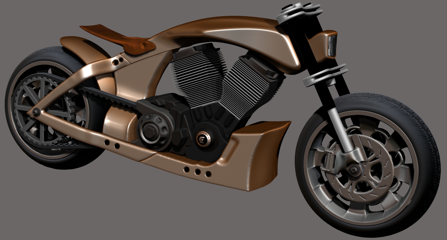

Love the bike Ezra!
:+1:small_orange_diamond:+1: be great to see in some chrome !!!

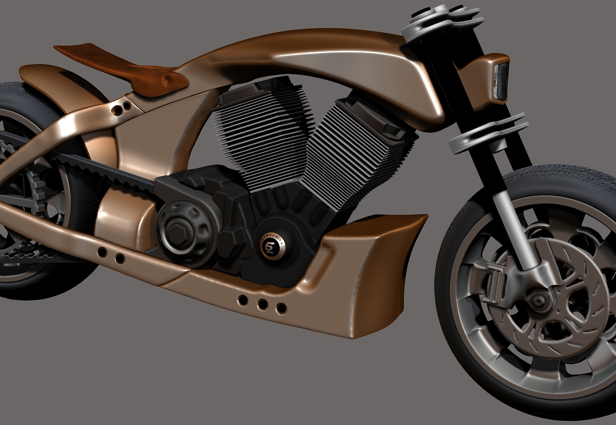

As I started to look at the bike I had started last year I realized I wasn’t really happy with much of the build. I ended up rebuilding about 90% of the parts so I’m just about back to about where I was when I picked this project up again this year. All C & C welcomed.

The bike looks fantastic, Ezra! I had actually downloaded the photo reference of that bike with the intention of giving it a go several days ago. I’m working on a different bike now but I need some pointers. Specifically how did you do the drive belt? I’ve tried everything I can think of and can’t get it to look right, where yours is picture perfect.
Hi Voodoodad:
Thanks for stopping by and the nice comment.
For the drive belt flywheel I start with a Ring3D > Initialize > Change LDivide to 256 & SRadius at (smaller-your choice) like 15 or so > Deformation > Flatten Z (both sides equally) > SFlatten XY (negative a little to remove the curvature on the outside) > Masking > set Sel and Skp to 3 > hit the Mask All > then hit Col > then Ctrl Masking and change to Mask Circle and stroke to Circle with the Square and Center buttons click on > then Mask off the inside half or so of the ring so that on the outside of the ring (only) so you have alternating masked and unmasked areas (remember you can move that masking circle around by holding down shift) > Deformation Inflate XY to + (approximately) 33 (turn off View Mask and Polyframe to see if it looks the way you want it to) > if so Clear Mask in the Masking subpallet > Deformation > Size Z (widen to your preference) > click the Make Polymesh3D after your happy with the results.
For the circular part of the drive belt that goes around the above flywheel subtool: do NOT mask the inside of the 3D ring with the trl masking as described above just Deformation > Inflate XY > then Deformation SFlatten XY (as required to flatten the outside edge again).
For the straight parts of the drive belt I just made a cube > I extruded several times on the X axis using the ctrl and transpose move (enough times that I felt when I subdivided I’d have plenty of divisions along that X axis and fewer on the Y and Z. > I size that (now elongated on the X axis) cube until it;s about the size of the belt that you made on the flywheel and with enough subdivisions that 3 edge loops equal approximatly the width of the teeth on the ring belt on the flywheel. > Then I masked off the top 1/2 along the x axis and then masked every other three polygon widths long the X Axis until it looks like your ring after you used the circle mask on the inside of the ring in the top paragraph. > Deformation > use either Offset -Y or Inflate Y > Duplicate and rotate the duplicate 180 degrees on the X axis and use for the other straight part you’ll need.
Then you need to position the straight belt parts to the ring belt part > slice cut both the circular belt part and the two straight belt parts as required so that they appear correctly positioned > Merge the thre parts (or 4 if you’ve created another flywheel/ring belt) then remesh (at a high polycount).
That’s all there is to it. lol.
Have fun Zbrushing
Ezra

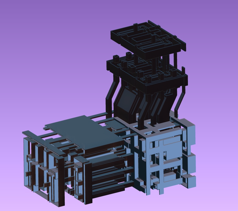

Hi All,
I’ve been playing having a little fun with shadowbox this afternoon. I’m also trying to upload a turntable (my 1st) unsuccessfully.
Have fun brushing,
Ezra

I would love to see people post more time lapse videos of using the shadow box. I just can’t wrap my head around it. (No pun intended) :wink:
More shadowbox play, then some mirror-weld.
Thanks for visiting nicksc, genc and Gridlost and thanks for the nice coments on the bike. That was my 3rd Zbrush project back when I had a little more playtime.
Gridlost I’ve never time lapse or otherwise recorded anything in Z but what I’m doing in shadowbox to get these is really just mindlessly masking rectangular areas on the sides and bottom of a shadowbox until I like the way it appears. Certianly nothing very technicle about it. If you’ve never used shadowbox though there is a tutorial I did up above in this thread and Etcher (Geert Melis) has some excellent video tuts on using shadowbox in his thread. http://www.zbrushcentral.com/showthread.php?161159-ZBrush-4R2-Betatesting-By-Geert-Melis. Here are a lot of shadowbox tutorial by many different artists on youtube. http://www.youtube.com/results?search_query=zbrush+shadowbox+tutorial&oq=zbrush+shadowbox+&aq=0&aqi=g1&aql=&gs_sm=1&gs_upl=19985l19985l0l22061l1l1l0l0l0l0l53l53l1l1l0
