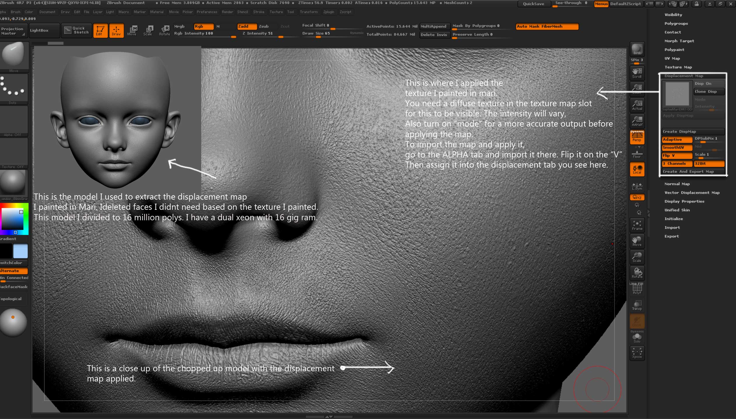

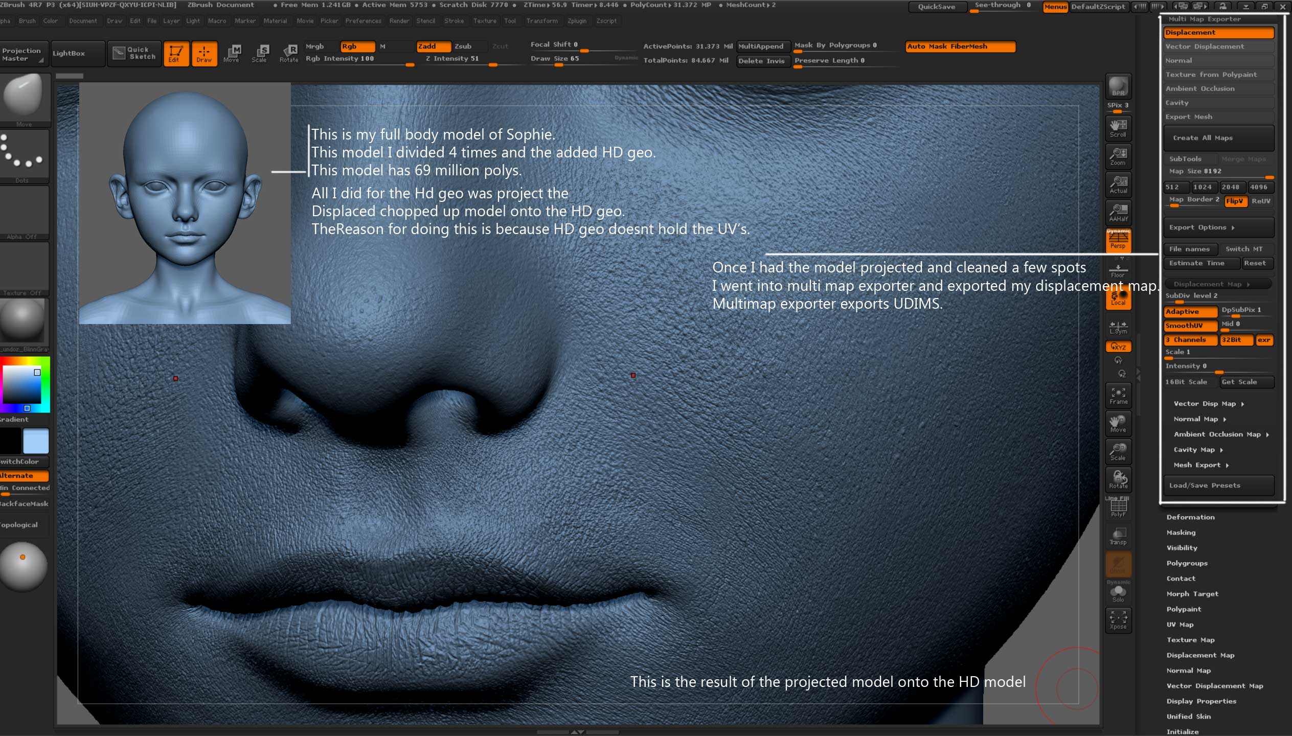

So here is a wip of Sophie. Very early stages and I probably won’t be able to do much more on her for the remainder of the year.
There is still a lot of fixing and tweaking to do before I’m happy with her, but thought I would share this as people have been asking me how to apply a displacement map made in Mari.
This is what I worked out here on my own. If there is a better way and quicker approach I’d like to hear about it.
I apologise if this mini tut doesnt help or is lame. I’m a bit useless at these tut things.
Thanks for looking.

You said in one post: "I usually export a displacement map from a subdiv higher than what I export my model as . So if I export my model at level 1 or 2. I make a DM at level 2 or 3. " Could you explain why you export from a higher subdivision level?
