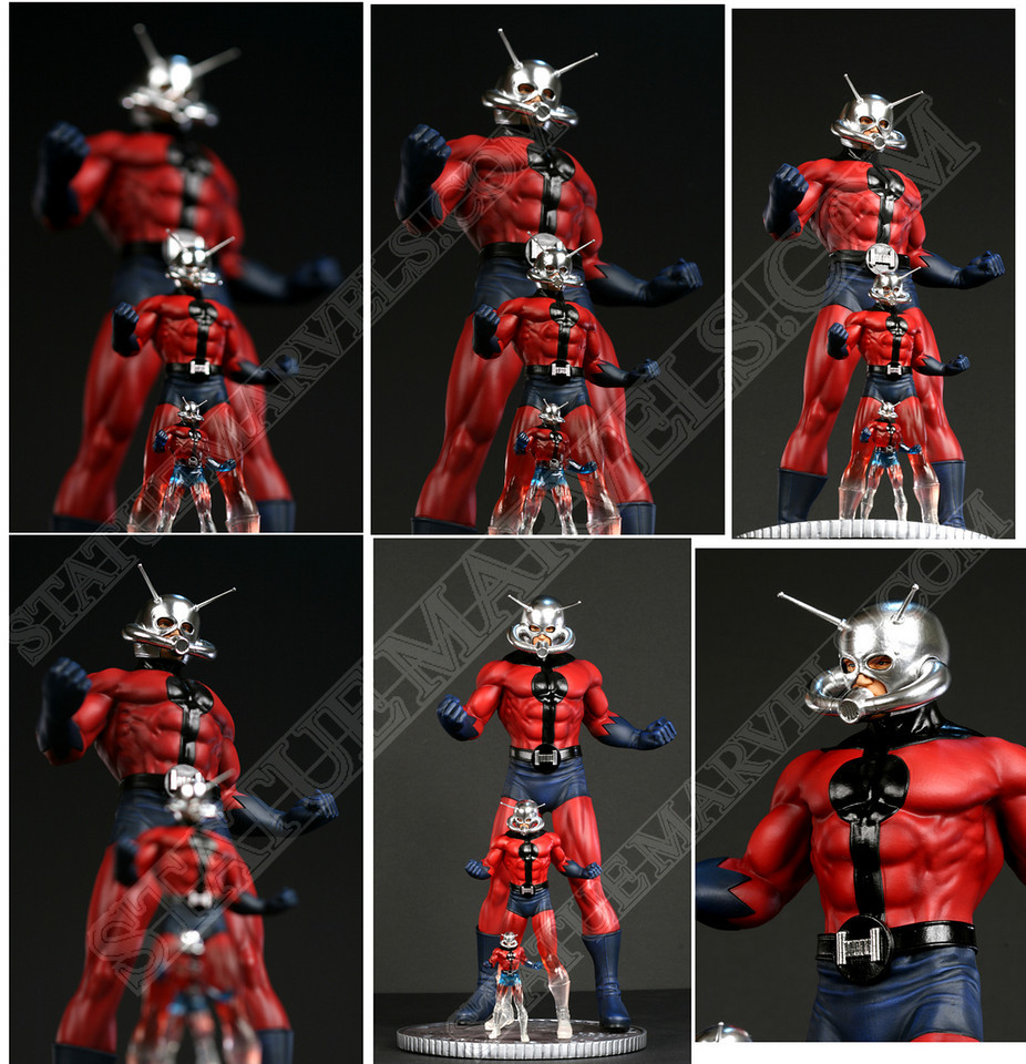

Hmm… fully printed crystal prints… mm… I try to avoid it cause crystal prints are really hard to examine for detail (it’s like examining detail on an ice sculpture). But sometimes people do request it. Like the one attached (which was not painted by me… it was painted by one of my painting idols… Danno… who is the lead painter for Bowen Designs). I casted this in acrylic from the original prints. It turned out really cool! Sculpted by Jason Smith of Overwatch fame (you can buy this figure on sideshow i think). Lol… i had to handmake those transparent antennae on the 2inch tall version… nothing can 3d print or cast those (.3mm in diameter).
[attach=178034]painted ant man.jpg[/attach]
Okay… before whoever took over Morpheus’s Account jumps on me here. I assume its not Will. Morpheus did try to help me print one version of these. I guess the irony here is that I wanted Morpheus to make some money and do part of the prints… but the resolution was kinda missing… so i had to redo them on our own machines. Just wanted people to get fast perfect prints and sent almost all my customers your contact info (also so i wouldn’t have to do prints anymore… cause that wasn’t my initial focus)… then I had to feel bad when the prints came out kinda icky, and apologize, and pay for it myself and toss them and redo them myself. What more do I owe you guys? You guys do some great work and are extremely professional about shipdates and timelines.

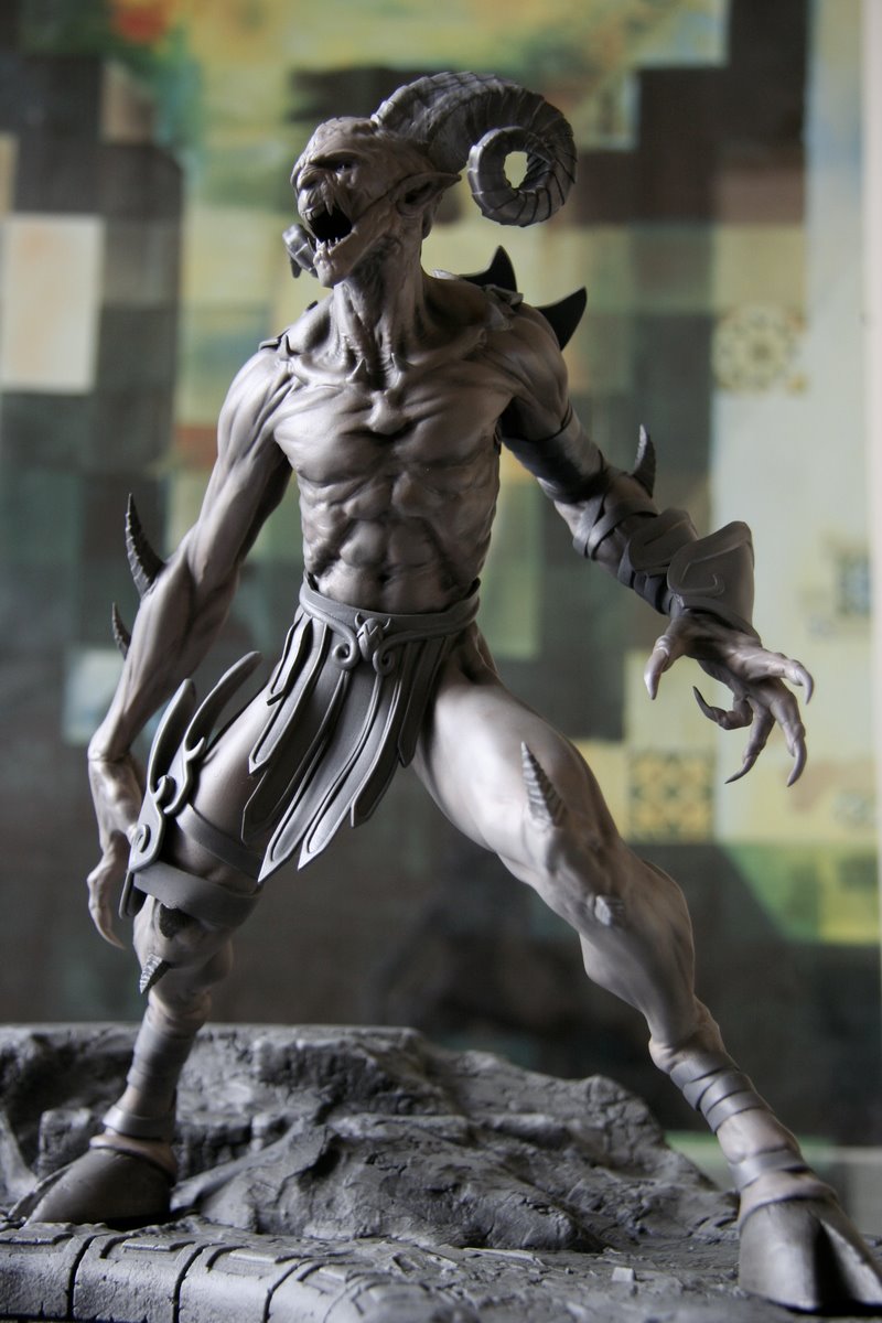

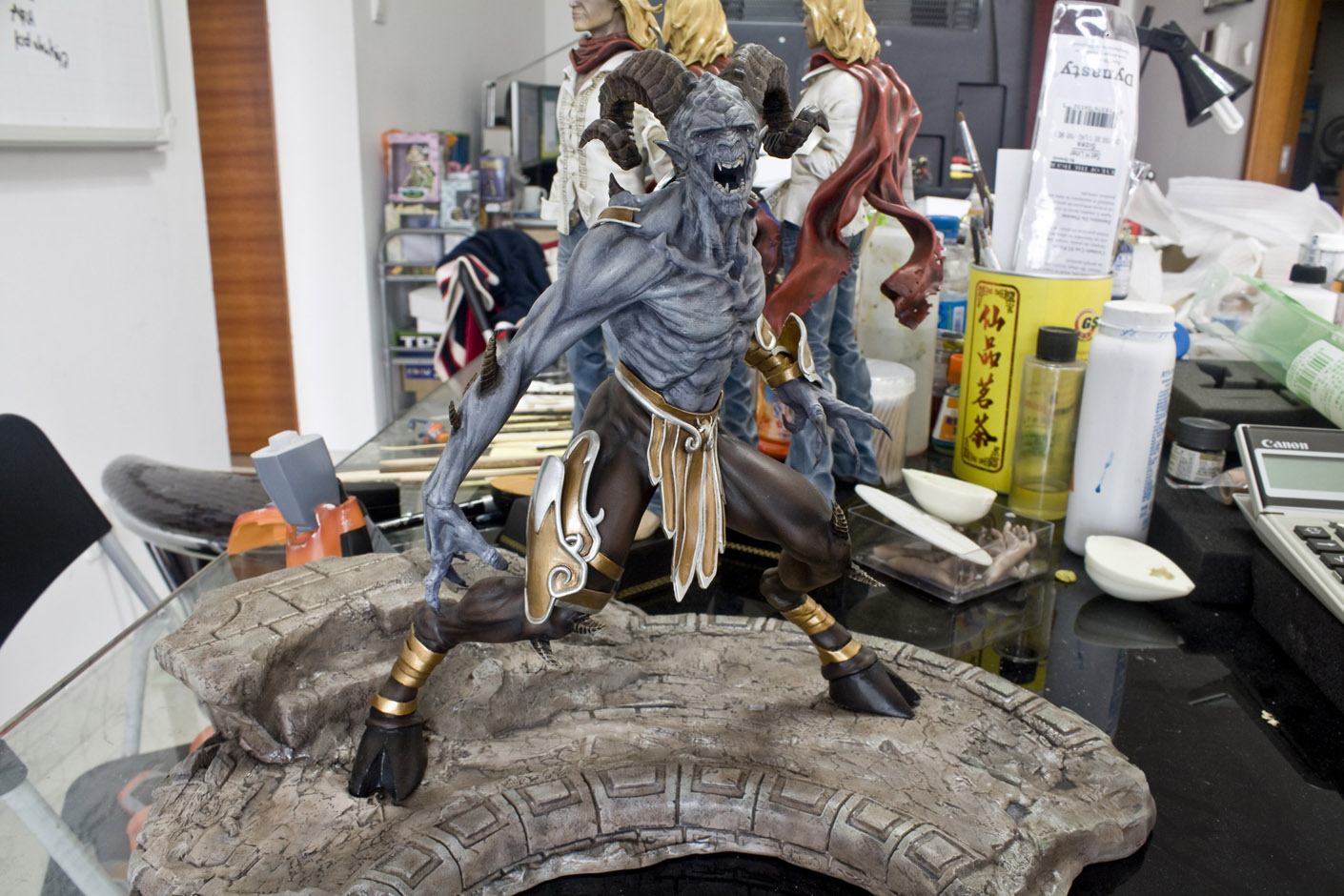

Here’s one a did for Sony awhile back~ Recently did a colored version for them. Hehe… its a sony exclusive… so you have to work for sony to actually get one. Katon Callaway is the zbrusher! I don’t paint all the pieces for ownage lately, but I did this one~ Thanks for the opportunity katonc! :slight_smile:
