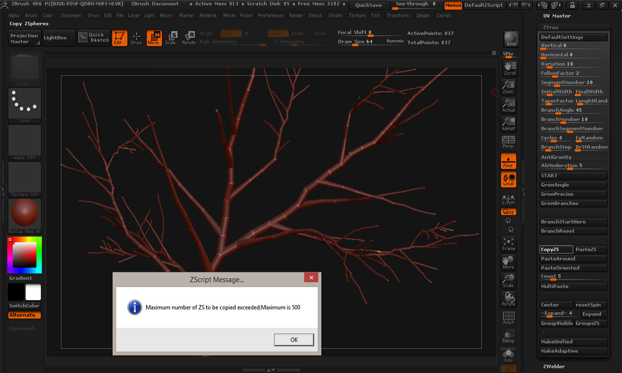

I´m playing around with CopyZS and PasteAround, PasteOriented and got a note that the limit of ZS copies is at 500.
Can you give us more ZS to copy?
That should be more than enough for a very nice tree :roll_eyes:
Be somewhat realistic, that is more than enough if used properly on your canvas.
It may gag with Fibermesh or Micromesh with any more(maybe with that), play with it.
Sure! I just limited to 500 because my initial idea was to replicate many simple branches… paste 10 branches of 500 will be probably very slow… I haven’t tried that many… but if you want more I can raise the maximum number.
Notice that you don’t have to press copy every time you want to paste…Maybe that’s what you were trying to do?
Anyway, there are a lot of things I haven’t explained at all… Sorry about that.
Ah, thank you for this tip, my mistake sorry. So 500 will be more than enough.:smiley:

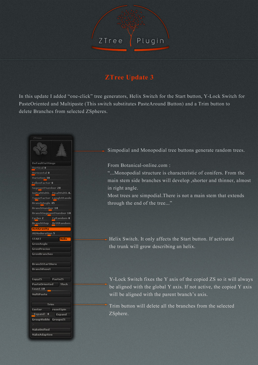

I will explain a couple of things…
for example:
When you select a ZS and click on pasteoriented or Growangle the angle around the parent’s branch is determined by the cycle slider…if you click a second time with the cycle slider at 1 and 0 cyclerandom, the 2nd branch will be generated with 17.20 degrees angle with the first one…a third time 34,4 and so on… So you can complete a cycle clicking 21 times on the same ZS…
The cycle slider at 2 means 217,2=34,4 degrees , so you would need 11 clicks and the 11th branch will fall in the middle of the 1st and 2nd…
8
17,2=137.6 wich is close to 360/phi.
the same cycles sliders are used in multipaste and growbranches…

In this Update I added “one_click” tree generators, Helix switch,Y-lock Switch and Trim button.
