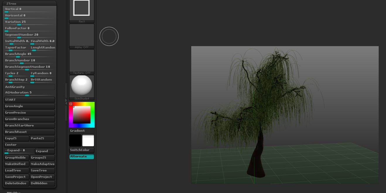

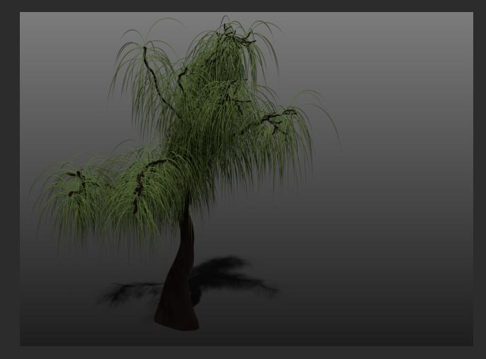

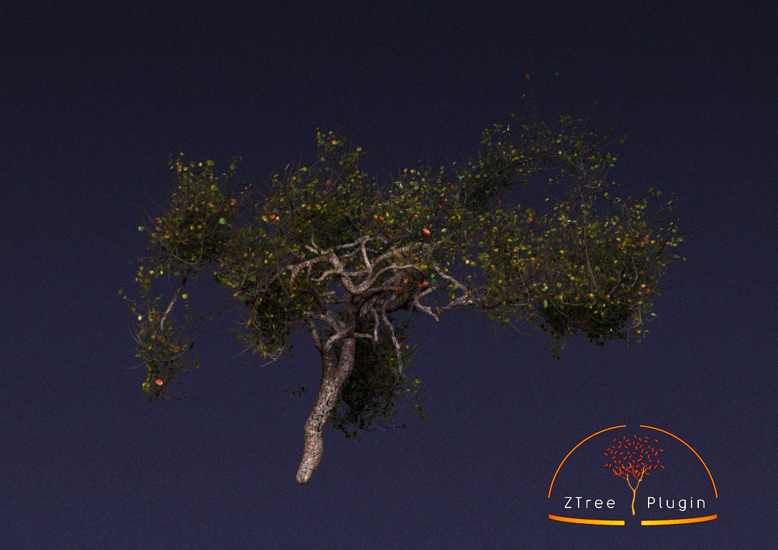

Sample of my Ist Ztree
Cool, a bit like a weeping willow. Did you save the fiber settings to a file?
10 minutes to model, 40 minutes to render the turntable with some bprfilters and a simple light… Never again! lol
I will post a better one and sample zs models… when I have some time.
