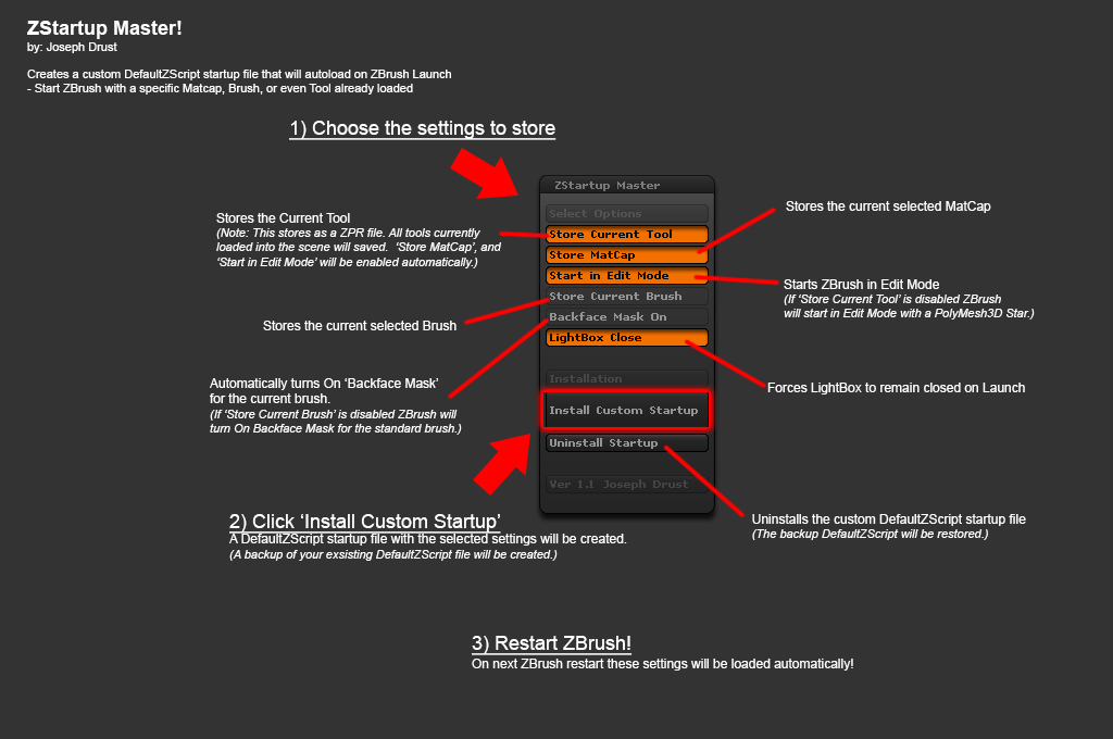

ZStartup Master is a unofficial plugin that will store settings to auto load on ZBrush Launch. If you ever wanted to have ZBrush launch with a specific Matcap selected, specific Tool selected, or a specific Brush this plugin is for you!
This plugin is unofficial.
Main features
  • Creates a DefaultZScript Startup file with specific settings that will auto load on ZBrush launch
  • Allows for items such as Specific Matcap, Brush, and Tools to auto load at launch.

I usually end up doing a few of the same things every time I launch ZBrush so I decided to automate this process. The plugin has not been tested extensively with custom UI’s so use at your own risk. If something is not working correctly after you “Install Custom Startup” just click ‘Uninstall Startup’ and it will revert the changes. If you find bugs just post them in this thread and I’ll try to fix them :slight_smile:

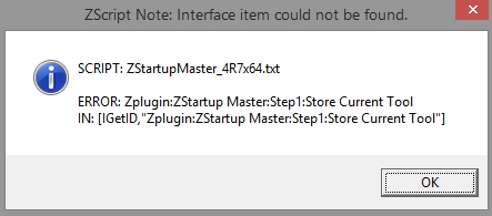

The latest build 1.3, I seem to be having trouble… Once I start Zbrush it takes ages to load, I press a button and then an error comes up [Error:Zplugin:Zstartup Master;Step1:Store current tool. In:{IGet ID, "ZPlugin:…ect]. ZBrush Starts and there is another error saying cannot find a file. Plus the ZStartup Master does not show up under the plugins.

@Wyattfox, Altea, valencia1992:
Questions for you all:
  1. What version of ZBrush are you running? 4R7 P2? P3? x64? x32?
  2. What Operating system is the issue happening in? OSX? Win7? Win8.1?
  3. Do you have any other Plugins installed?
  4. Do you have any *.txt files in your ZPlugin or ZPlugin64 folder?
  5. Did you completely remove the v1.1 ZStartupMaster_4R7x64/ZStartupMaster_4R7x32 and the ZStartupMaster_4R7 folder before installing version 1.3?
Side note: If ZBrush is taking a while to load (nothing is happening, more then likely something I wrote broke :wink: ) pressing ‘ALT’ will force the error messages to appear.
-Joseph
4r7 p3 64
win8.1
lots of other plugins, I can give a list if you want. No problems until now. Zbrush normally runs fine.
No TXT, only docx
I didn’t installed older versions before.
The error message was that it was missing a file, I think a model, the star. Not sure if it is exactly the same message as the other user as I didn’t write down.
@Altea: Try this version and see if the issue is still happening. I have not been able to reproduce the issue on my end (I have installed on 4 computers without issue :frowning: ) This is making me believe that the plugin is conflicting with another plugin. Comparing your answers with the ones Wyattfox and valencia1992 will hopefully help me in reaching a resolution (if this version is still causing the error.)

I get this error. Not sure if it is relevant but my Zbrush is installed in e:\ instead the standard c:
After the error the plugin it not found in the Zplugin menus.
I have removed all plugins that were not present in the original installation and you are right, now it works. I will try to find out with what one is colliding but not sure if I will find out as I have many. I have noticed the duplication of the zfileutils, with an older version.

Found it. It was one of your plugins, Nanotiles. It was an old version. I updated it to a more recent version and now both plugins work.
