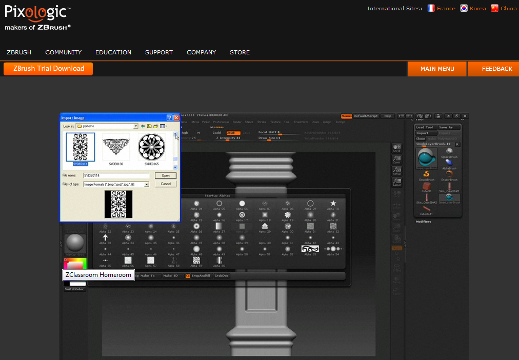

<img src=“http://www.zbrushcentral.com/pixo/atn.gif”>
i need those patterns…
