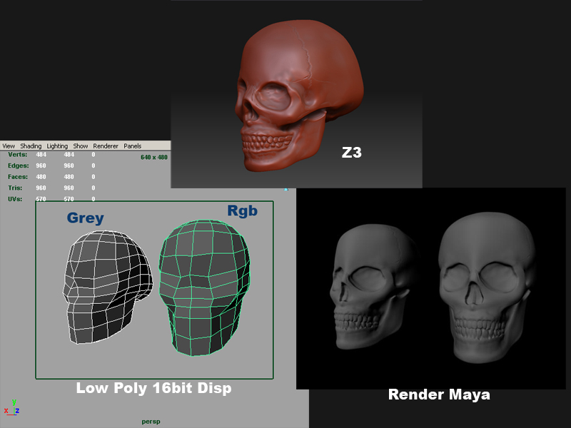

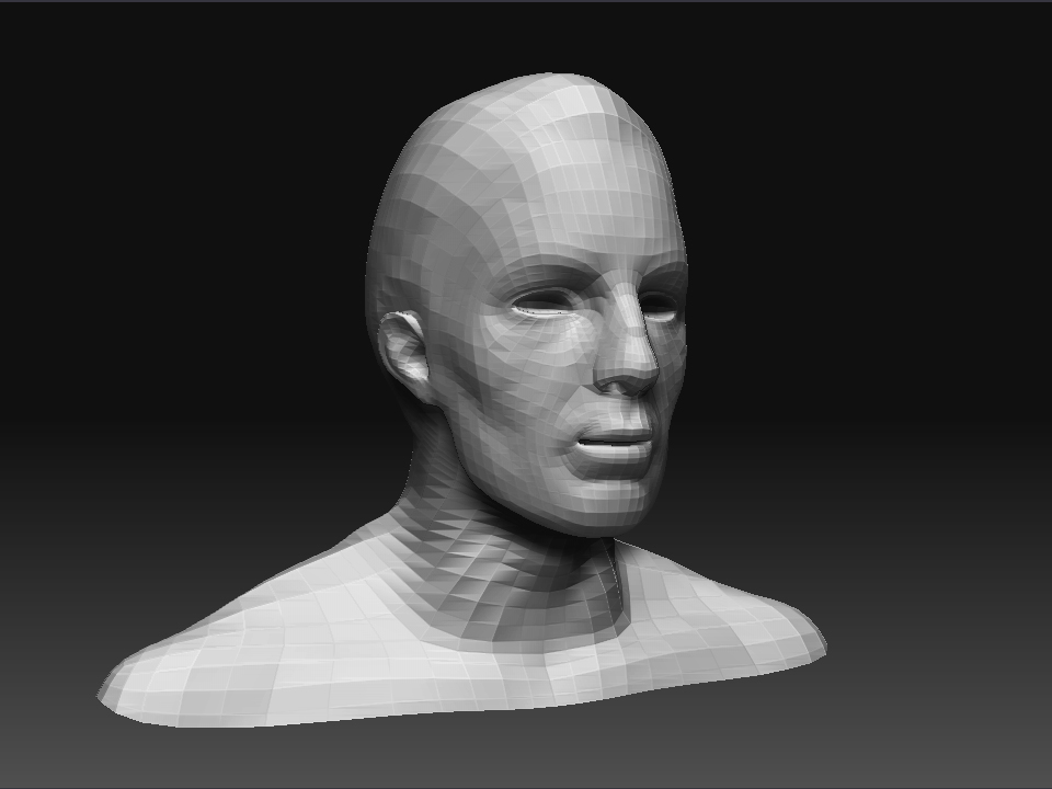

1. Prepare lowpoly model in maya, position model Yaxis up and Zaxis forward, assign UVs, freeze transformations,set normals to face, delete history and export.
2. Create displacement in zbrush3 and take note of the "Alpha Depth Factor"
3. Export the displacement Alpha and convert to .map file using "convertfile"
(drag and drop the displacement map file onto the convertfile and it will automatically place the .map file in the same folder)

I hope this is clear enough for all Z3 users to follow. I will eventually post a step by step tut with images, until then I will try to answer any questions that may arise.
](javascript:zb_insimg(‘64768’,‘step-1.jpg’,1,0))
