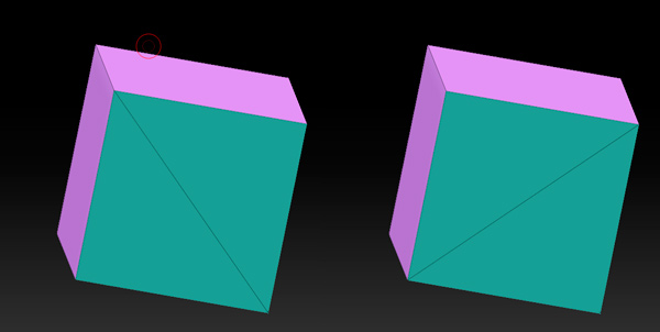

Am I the only one still experiencing Surface-Noise crashes? Even on the new 64-bit…
Everything else is working like a dream…just have to learn the new features.
I really don’t get the surface-noise crash though…I’ve re-installed and still have the issue…
Crashes with the the spin edge function are usually tied to tiny bits of extraneous or hidden geometry it is possible to inadvertently create with some of the other functions. Tiny, almost invisible ploygons that appear to be single edge, for instance. Every time I’ve gotten one of those crashes, I’ve found extraneous geometry in the problem area by deleting polygons and reconstructing it.
For instance, don’t use the slice function to split partially visible polygons, and go over the edge of the visible polygons. It will create such problematic geometry when everything is visible again.
It is important to remember that Zbrush does not support N-gons. Therefore every operation MUST result in a quad, and will be forced to do so. It takes a bit of adjustment, but once you understand this, you can avoid many problematic actions.
i WAS WORKING ON A EVEN SIDED CUBE, AND IT STILL DOES IT NO MATTER WHAT. the GEOMETRY WAS NICE AND CLEAN NOTHING HIDDEN

Don’t misunderstand me. It IS a very temperamental function, and it WILL crash repeatedly if everything is not to its liking. Most of the Zmodeller functions are pretty stable, but you should always save before attempting to spin an edge. I generally avoid it until Pixo gets more of the issues sorted out. They are aware of it.
However, if you investigate further, I would not be surprised to find something is problematic with the cube. One thing that can happen is if you have the edge action set to spin, but have the polygon action set to some operation that adds geometry, and you miss the edge target and inadvertently add some invisible geometry to one of the adjacent faces, then spin edge will crash when you try it again. For some sensitive operations its helpful to set the other target options to “Do Nothing” to avoid any mishap in fine work.
My only point was that Spin Edge does work, and when it crashes there is usually a reason for it (typically nearly invisible, extraneous geometry) even if it isn’t immediately apparent. I just spun the face edge on this cube about 20 times with no issue:
