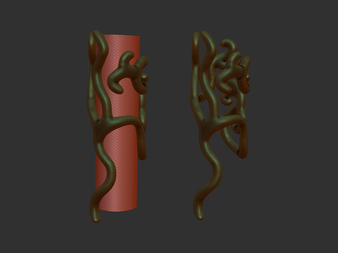

And I think I know how to make the vines you want using masking, I just tried it and its fast and easy, all you have to do is draw your vines as a mask onto what ever object you want them on, then when you like your drawing use Extract in the subtool menu and set its thickness to roughly the width (in polygons) of your stems and branches (That part is obviously variable so you might play a bit with inflate and smooth or something later). Once you hit Extract go into Geometry and hit Group Loops, it makes things nice and smooth.
I did this on a cylinder in the first attempt and it worked very well, I did need to use inflate in the deformation pallet because I did not adjust for thickness.
I think from looking at your model you could do this dozens of times and use the Move brush to make things overlap how ever you like.

This took maybe five minuets from thinking of how to do it to getting it round, it obviously
could be better but its so easy and quick I think it might be just what you are after.

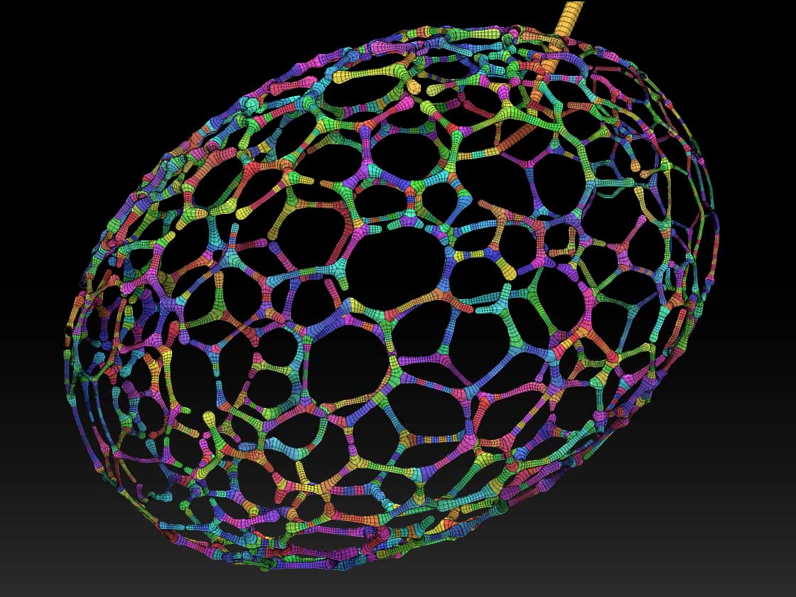

but anyway i did the above extraction as a zsphere mesh , but as we know you cant “close” zsphere chains so you still have to use another package to connect them, unfortunatly this also seems to take ages… so to get this mesh finished it has been almost a week , this is just far too long,…zspheres1.jpg

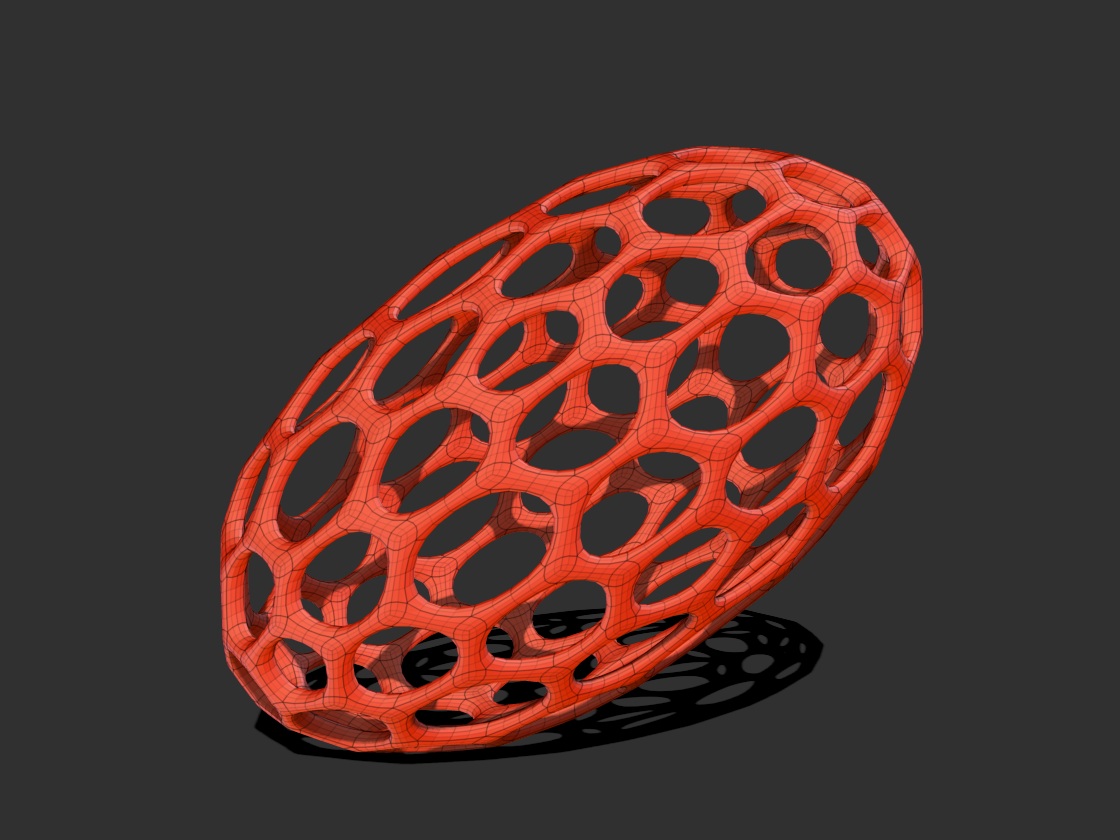

I realize this is a little less complex, or at least has less holes but it also took about 30 seconds to make in TopMod and export as a .obj, then less then 30 seconds to import and render after distorting slightly and rotating in ZBrush:
Posting it here was the longest part of the process.

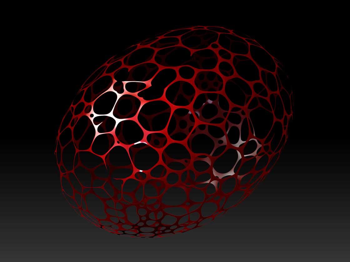

thats the kind of nice topo i am looking for but i think topomod is for more mathematical shapes is it not? like this?

Anyhow if what I made is the sort of thing you are after, then Topmod is the tool to use, it does some rather tricky things very fast, I’m serious when I say it took longer to upload the image here than it took to create it from start to finish.
Topmod is sort of for math related stuff but you can do all sorts of other things with it, its great fun and on top of all the obvious things like just making topology and screwing about with it you can also use 35 or more methods of subdivision and most of them are neat too.
What I made was a simple “soccerball” object, honeycomb subdivided and then framed at a low setting like 0.040 or something.
