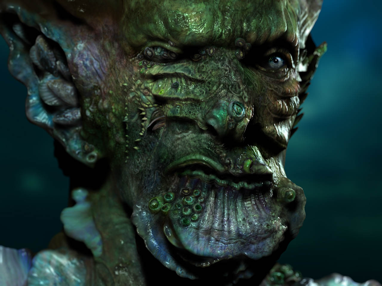

Hi guys! Here I am again with a new render of my character. This time it’s a close up. I added more surface details and zoomed on the face. Eye is painted in Photoshop.
What next? some sleep! girlfriend is pissed :smiley:
![John_2.jpg|1100x960](upload://4CEqmBWQnr5dlK1v3ZN1Gwr8Ib5.jpeg)
Hey man, great post dude! feels like a character from Pirates2! i saw Taron´s demo in Siggraph this year and it was as crazy as this post! gotta try the plugin man! keep posting!!
Superb artwork !
Speechless, congratulations !
Thanks for sharing with us !
Cheers !
This is really quite cool. Nice work!
