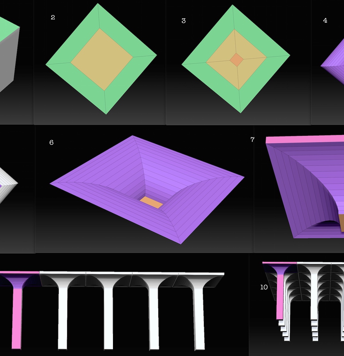

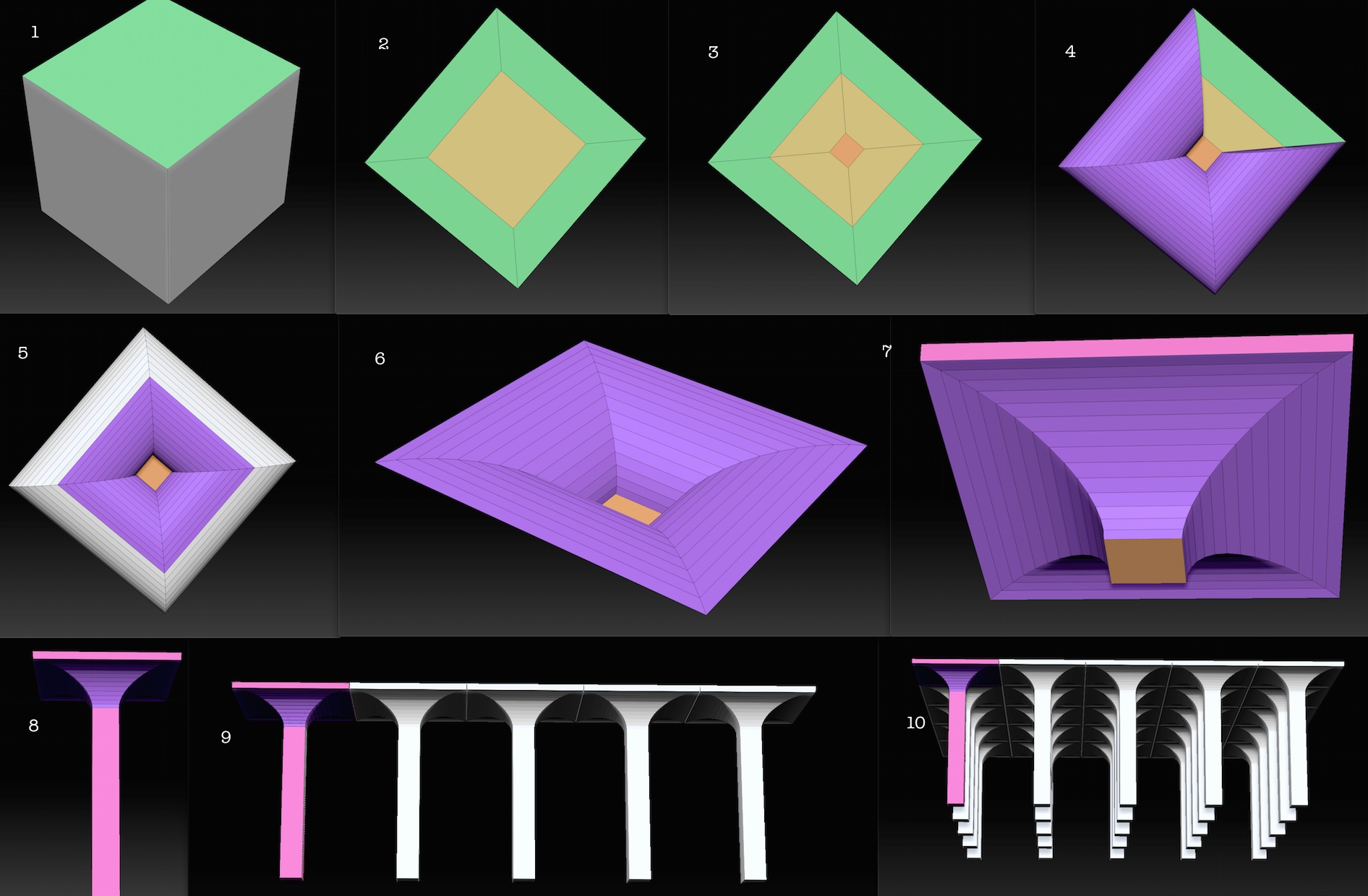

@ chris.3d:
maybe:
1: Cube
>>Polymesh3D
>>Initialize 1x1x1
ZModeller:
Mode Poly (Cick+A ) Delete (Target SinglePoly) 5 Quads to get a single one
2: Mode Poly/Inset(Target SinglePoly): Drag to less than a quarter of total width
3: Mode Poly/Inset(Target SinglePoly): Click into the inner island to get a second loop and a remaining quad in the centre
4: Mode Poly/Bridge(Target ConnectedPolys - Modifiers: Circle, [email protected], SpecifiedResolution@evenValue, AlignToNormal,PolyGroupFlat): Bridge four times from the outer quarter to the second loop
5/6 : Mode Poly/Delete: Select the outer half of the circles and delete them
7: Mode Poly/QMesh(Target: AllPolys):āExtrudeā all polys to a solid mesh
8: Mode Poly/QMesh (Target:SinglePoly): āExtrudeā the centre quad to be the column
Go to Tool/ArrayMesh:
(maybe you need 5x5 columns)
9: Repeat set at 5 with XAmount at 5
and
AppendNew
with
10: Repeat set at 5 with ZAmount at 5
Just a possible way <object type=ācosymantecnisbfwā cotype=ācsā id=āSILOBFWOBJECTIDā style=āwidth: 0px; height: 0px; display: block;ā></object>
