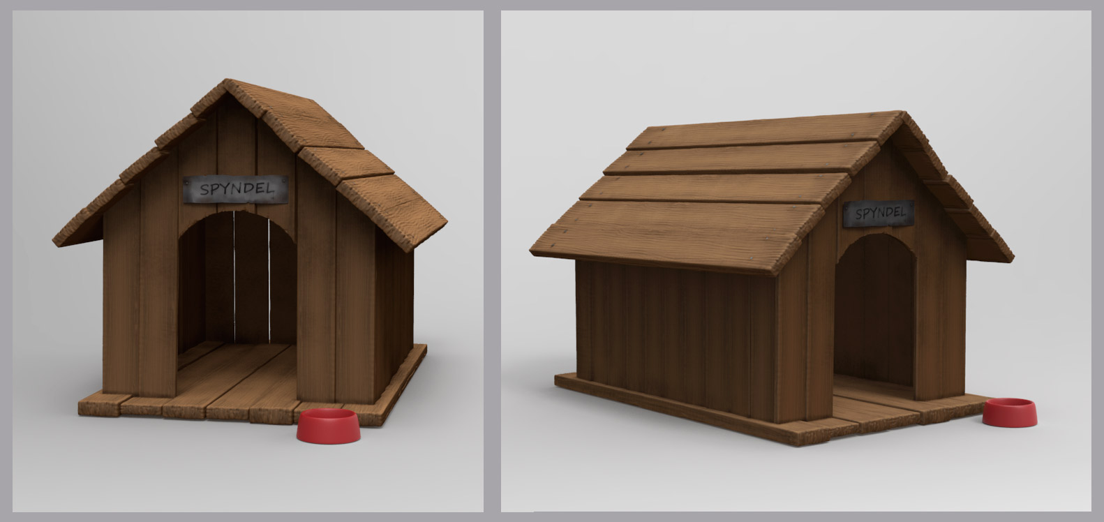

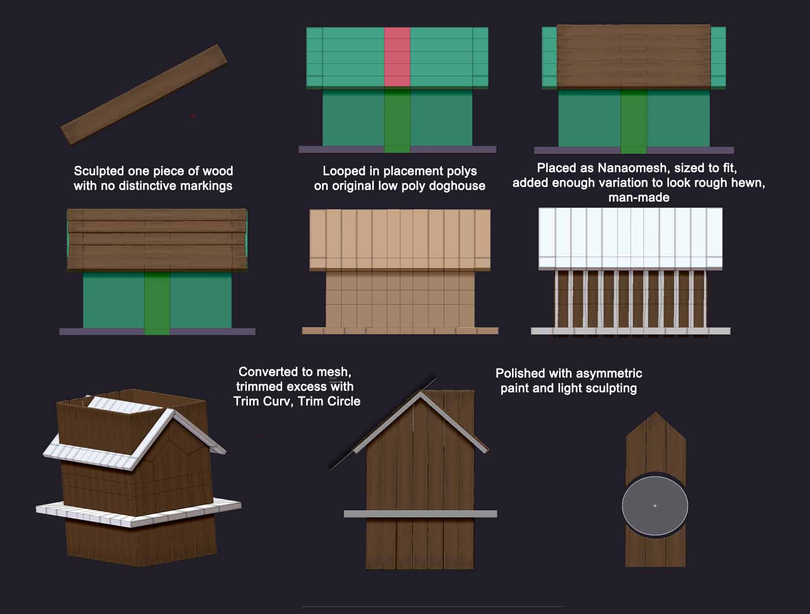

I wanted to spruce up my doghouse a bit, so I built a Nanomesh doghouse on top of my original low poly doghouse using it as a sort of frame. I doubt it’s 3d print friendly. I’d have to merge all the planks with the underlying frame to make it solid, but I just wanted to see those little cracks of light in between the wood. :slight_smile:
The basic process here ( Tip! You must sometimes use Tool > Geometry> Modify Topology > Align Edge to get all your Nanos going in the direction you want them to):
Spyndel what are the step for use nanomesh? i still confuse with it,
thanks in advance:+1:
There are a couple different ways to get started with it, I think.
First, prepare your nano by angling the camera at it in the way you’d like it to appear on the target polygon (front facing, side facing, etc.)
Then:
  1. If ZModeler is active, you can make it into a nano by using POLYGON > MESH to BRUSH > Target:ALL POLYGONS and clicking on one of the model polygons.
OR
  1. Prepare your Nano, and in the Brush menu, select “Create Insert Mesh Brush”, and then “Create Nanomesh Brush”
Either way basically creates a new ZModeler brush with the Nano loaded. Select POLYGON > INSERT NANOMESH with the desired target, and insert the nano on the desired polys. Once placed, you can change their attributes in the Tool > Nanomesh menu.

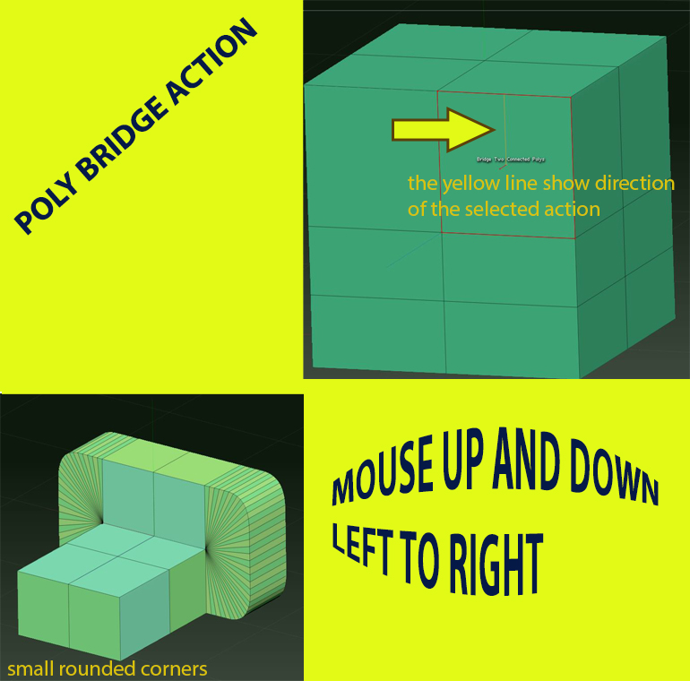

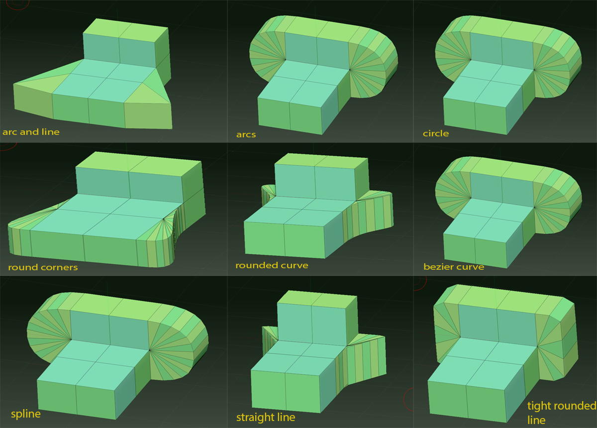

ps:the image below is related to bridge action on connected polys that some guy in other thread asked for…
Great Thread :slight_smile:
When bridging two adjecent faces zb seems to not merge the tris to the center vtx, but quad it out so that point has a bunch of extra edges. Anyone else zoomed in close and noticed that?
Edge Align tool looks great as well. Anyone know if there is a way to perfectly center a loop between two other loops after it has been created? That would have been neet :slight_smile:

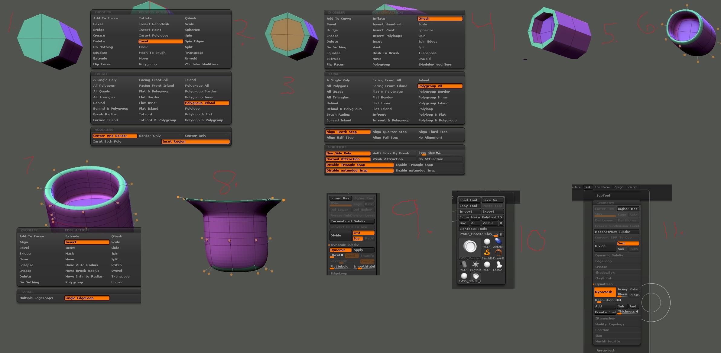

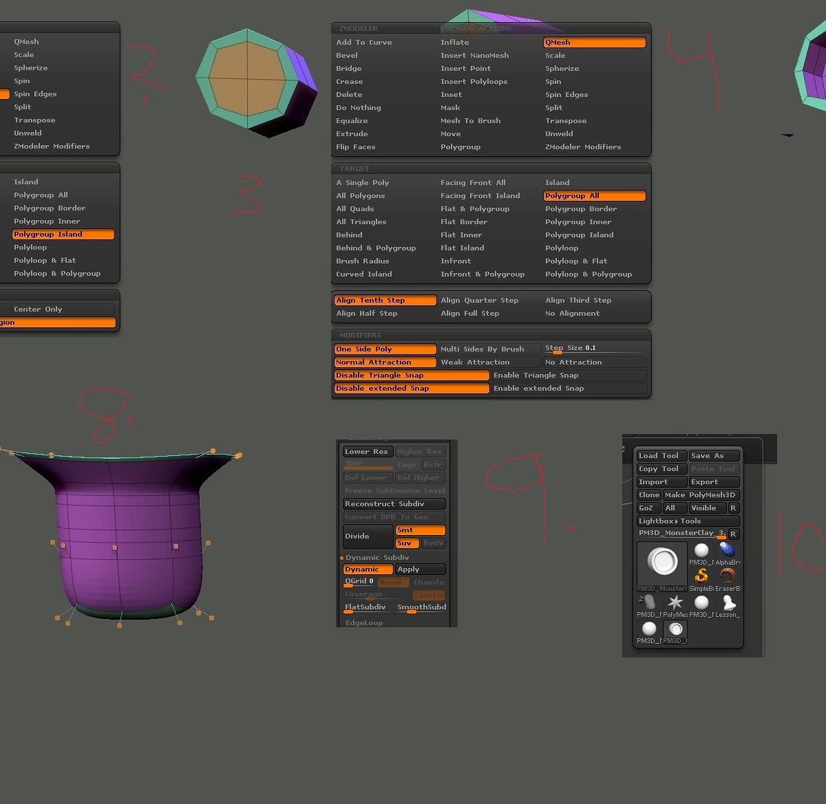

here’s a example of organic workflow with qcube zmodeler dynamic and dynamesh
  1. make a qcube on y
  2. with zmodeler brush hover over polygon hit spacebar go to insert polygroup island ,center and border, and insert region
    3 see the result of doing that
    4hovering over the new polygroup go to qmesh polygroup all and hold the pen/mouse down and move in the new polygrouip
  3. the result
    6 go tool geometry dynamic subvdiv click dynamic and make the smooth subdivion 3 or more
    7.with the edge seelected go to inset single edge lopp and put in a few edgle loops in the moved island and outside of the round cylinder
  4. with the pins i call them pins u can move the object to form anything u want or use any of the zmodeler actions
  5. after u made your object hit apply in the dynamic subdiv
  6. go to tool make polymesh 3d
  7. goo tool geometry dynamesh and put in 200 and hit dynamesh and use any of the brushes ex claybuildup to deatail it more
