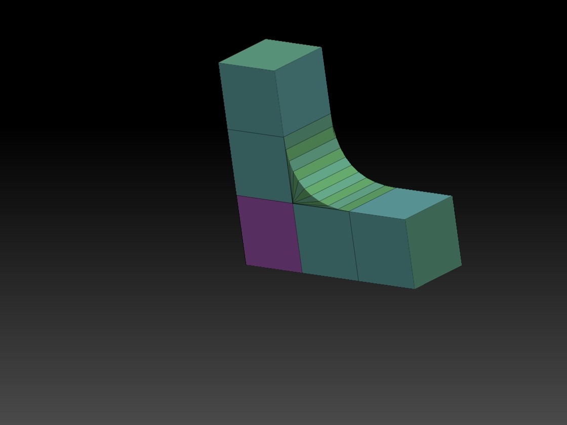

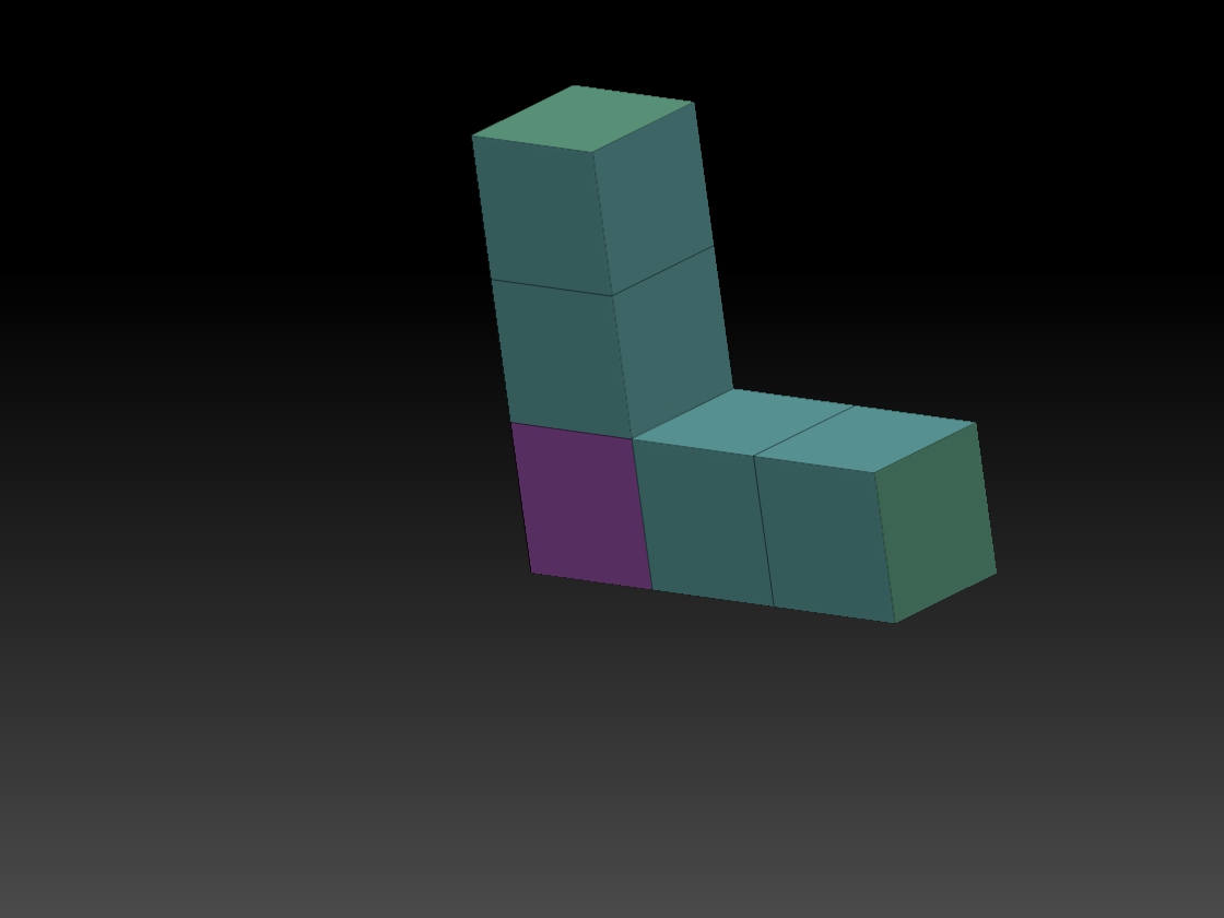

Did you make sure you had poly’s extending beyond the two poly’s you are attempting to bridge? See before and after images below

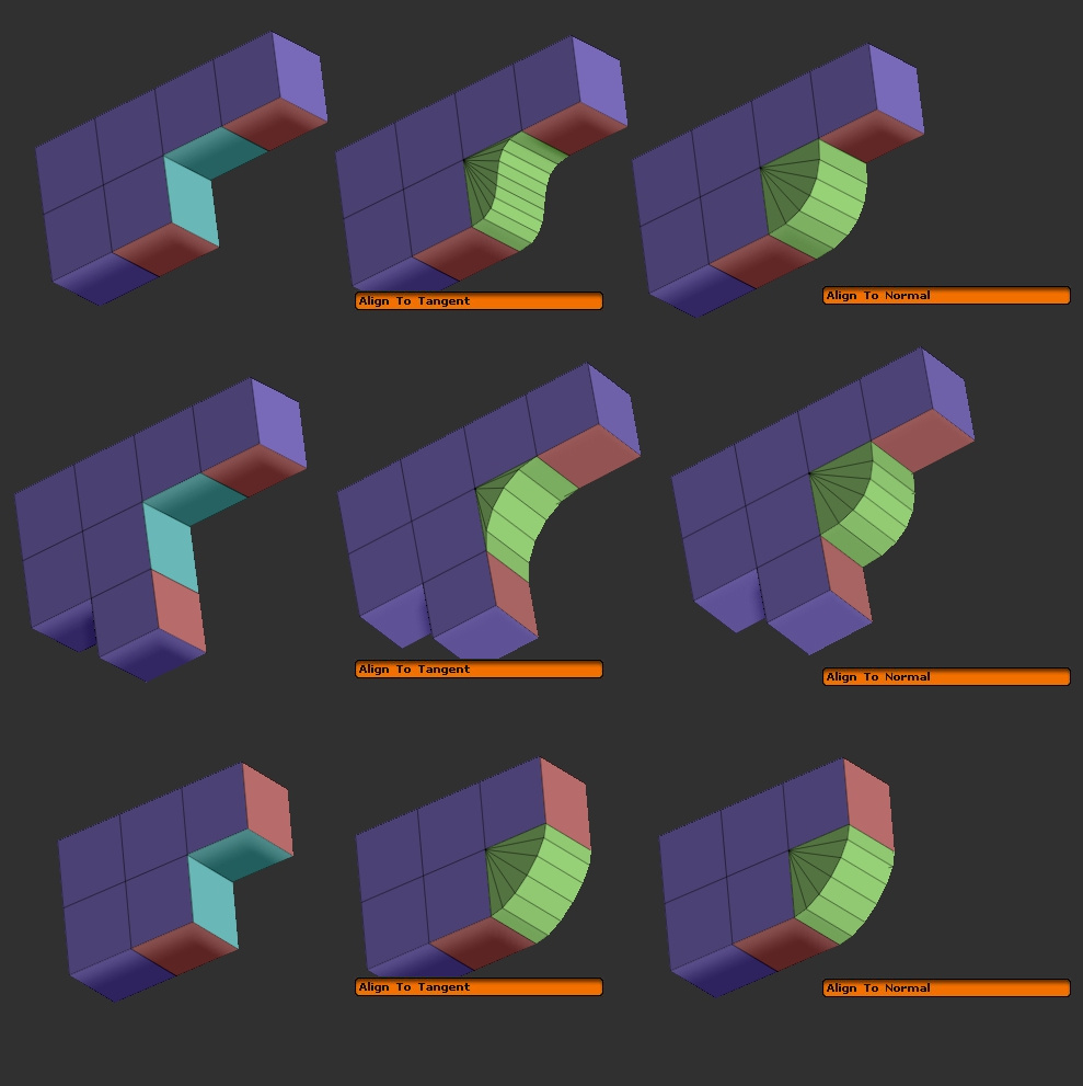

Hi Daimondo,
If I understand your issue correctly it seems to me that you need to look at neighboring polygons (reddish in my example) especially when choosing the Align To Tangent version of the Poly Bridge Action.
Here’s a comparison of the effects and as you can see the S curve is created when you choose the Align to Tangent option and the neighboring polys (red) are parallel to each other.
All of the below actions are created by moving the cursor outward (that is to the right in this case).
The concave curve in the second row is due to the curve being aligned to tangent of two red polys facing each other at 90 degrees and still dragged outward - to the right (and not aligned to normal dragged inward - to the left - that would give an overlapping geometry as in your later example).
If my explanation is not clear then I hope the image is

Wow, very astute! I think you solved my issue. Thanks for taking the time to demonstrate. Perhaps they can add the vital information you’ve provided to their ZBrush Docs for ZModeler. Thanks!
