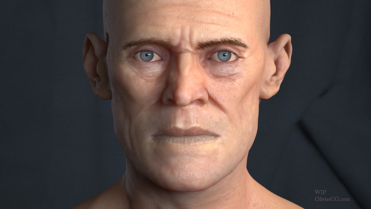

This is a head I tried making about 2-3 years ago. I decided to put what I’ve learned since then to the test and redo this project from scratch. I’m trying to make a Sci-Fi suit for it as well with a bit of hard surface armor.
I’m hoping that posting here will kick my butt into working a bit faster.
Base modeling and rendering in 3dsmax/Vray, UVs in maya, texturing in Mari/photoshop and sculpting in zbrush.
Hope you like.
Great work - looking fwd to more.
Excellent work. :wink:
Bien joué.
Nice job, very good likeness! :smiley:
CREG Customs - Thank you!. I will update as much as I can.
Philuxius - Merci!
chalkman - I’m glad it looks like him. It can be very frustrating at times when recreating a face.

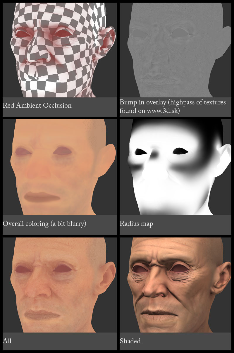

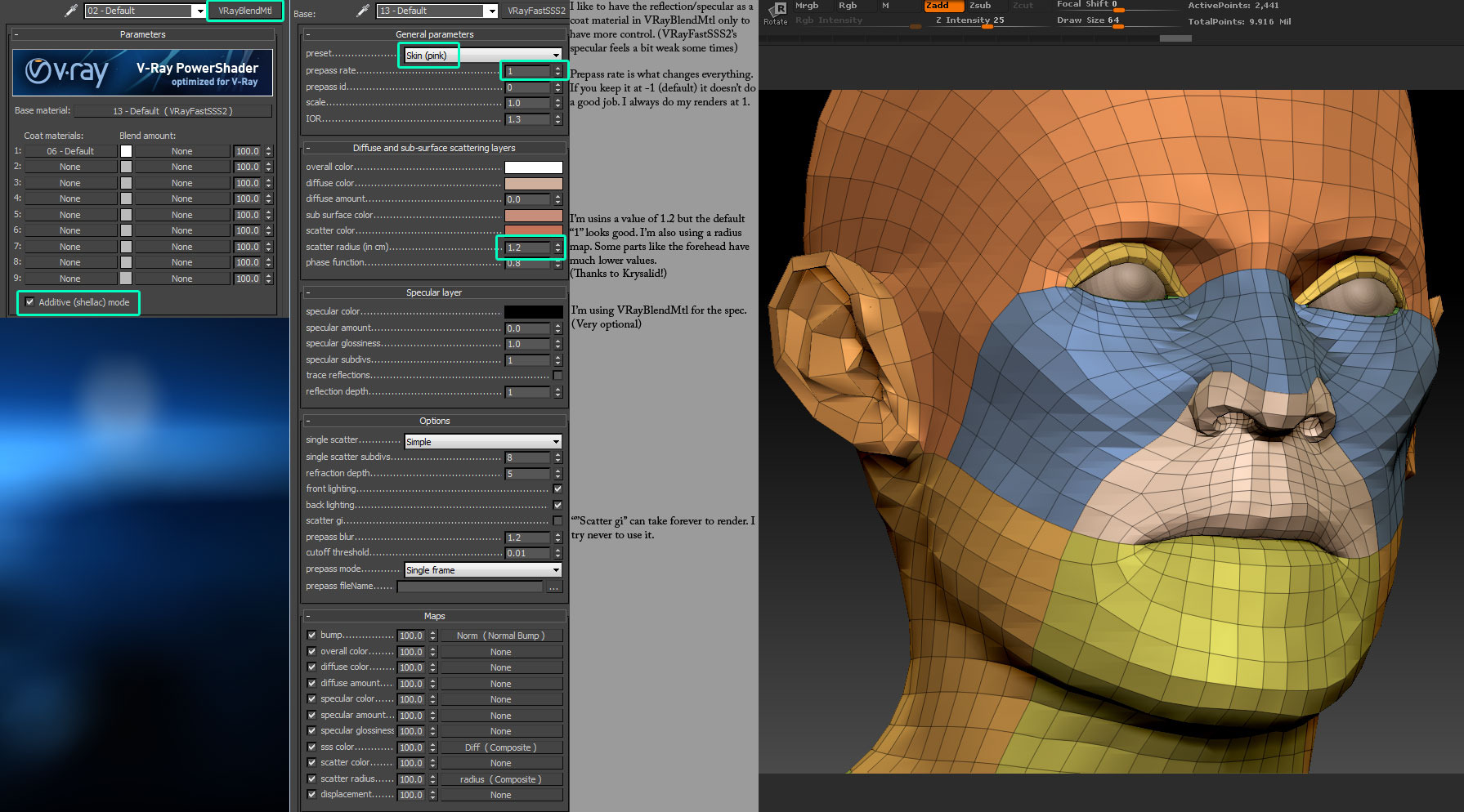

the skin looks really good. the lips seem to be lacking saturation though. would you be willing to share your sss2 settings and maps? i just started suing vray and i cant get skin to look good at all haha. looking forward to seeing the full peice
This is looking Awesome, Can you post your material settings? I’m looking forward to seeing this Top Row it looks so life like. If i could offer some advice it would be to break the symmetry on the eye texture… :+1:small_orange_diamond:+1:small_orange_diamond:+1:small_orange_diamond:+1:
Shepard.B - Thanks! I will change the lips color later. It’s hard to get the right colors since the reference images all have different lighting. Here’s an image with some of the things I learned over time. The main thing that’s wrong right from the start is the prepass rate. Just changing that to +1 makes a huge difference.
sculptrisnewb - Top row? Nobody ever said something nice like that about my projects. Thanks! I think you’re right about the eyes. I’ll go over it later.
Here’s an image with some explanations. This is just my opinion but if it helps anybody, super!

Here are the layers I use to get the diffuse.
I’ll try to do the same about my 3dsmax lighting setup later.
*edit: the radius map is not part of the diffuse.

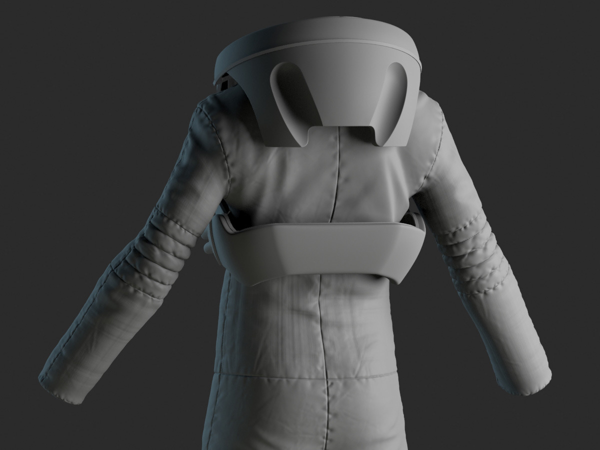

Here’s an update on the suit. Cloth is done in zbrush and the hard surface in 3ds max.

First off you have a good likeness to him. You could make the eye integrate better in terms of materials maybe its just the thin eyelashes that are throwing it off.
As for the suit i think it looks very natural especially those creases, are you just exporting it straight from zbrush?

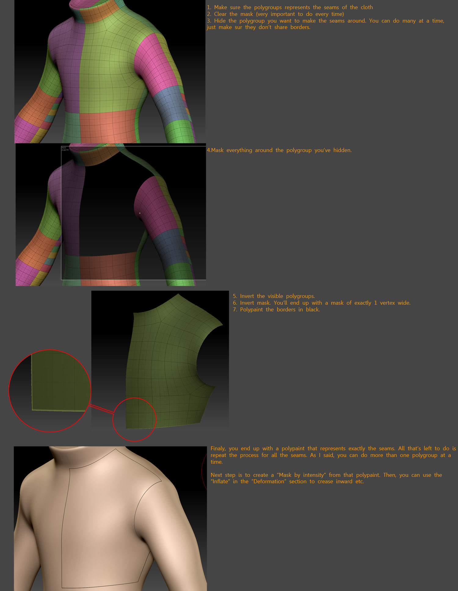

For the suit, if you’re talking about the cloth part, I’ve exported from zbrush with a displacement map. I’m using different layers in ZBrush:
1.Seams
2.Folds
3.Small high frequency folds from texture
4.Fabric
To create the seams, I’ve develope a technique by accident. I’ll try to create an image that demonstrate the workflow.
The hard surfaces are done only in 3ds max.
Here’s the workflow for the cloth seams.

Belle combinaison sans fioriture inutiles, et ta gestion des plis est nickel.
thank you for posting your technique for the clothes i appreciate it. I will definitely try this out when i get to it.
