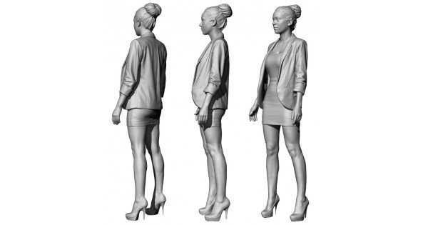

The difference is that everyone got access to photos, not everyone got access to scans.
Wouldn’t you consider it cheating if you and someone else was going to make sculpts of Scarlett and you had to do it from scratch and the other guy got scans?
Do you think it’s cheating if a painter use a projector? (Painters have been accused for doing that.)
When scans will be available for everyone to use, no one, or atleast very few, will think of it as cheating anymore.

Everyone can’t afford ZBRUSH, a powerful computer, and a 27 inch CINTIQ… Do you consider it cheating if you have all those mentioned items versus someone with a mouse, basic cpu and SCULPTRIS in a human figure sculpting contest?
Will is a capable artist regardless of scans, he has shown that. Even with SCANS most artist STILL screw it UP. You still require SKILL and SELF DISCIPLINE regardless the TOOLS you are using.
Scan data and TOOLS are littered all throughout the internet…
http://www.3d.sk/
http://www.agisoft.com/features/professional-edition/
Noticed all the POSER and MAKE HUMAN SCREW UPS…
But nothing is wrong with SHORTCUTS if you have the SKILL to use them and that skill requires mastery, the masters always make things look simple and effortless, yet it generally took several years of STUDY and PRACTICE inorder to reach that point!
Wikepedia describes Wisdom as is utilizing KNOWLEDGE, EXPERIENCE, understanding, common sense, and insight most optimally!
I would conclude by saying “WILL HARBROTTLE” is a GENIUS…
HATE his methods all YOU like I wager you will never be able to DUPLICATE this RESPONSE thru your work with that attitude!
Have to agree. Tools have never made the artist, regardless of discipline.
I think these works are amazing. Absolutely stunning. I also dont agree that scan data is cheating, but its not the same as starting from scratch either. Much the same way having the eye for being able to recreate textures, forms, etc is much more impressive than taking a photo. (although the photo can be just as beautiful in its own right). I have seen people using microsoft paint create incredible work… for microsoft paint.
