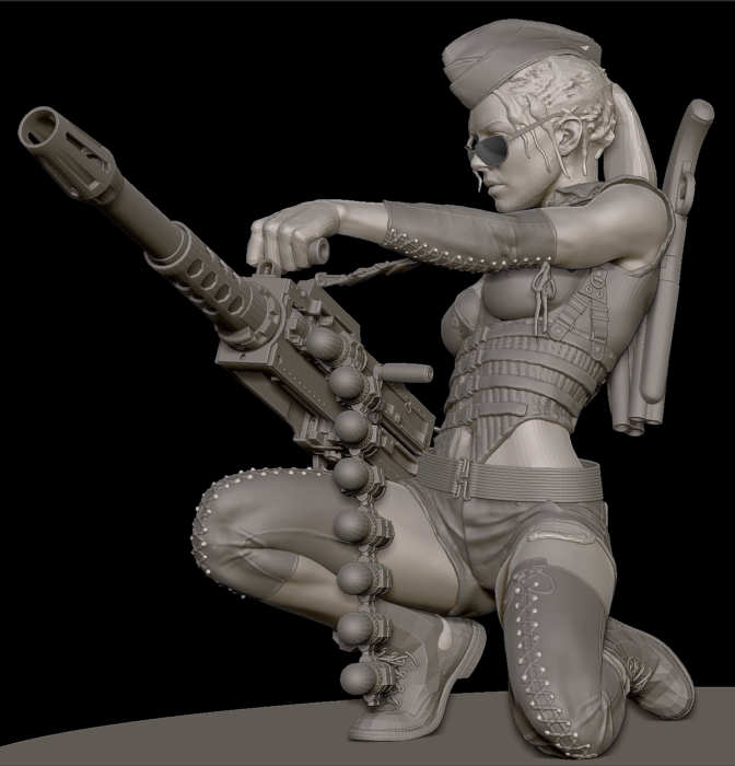

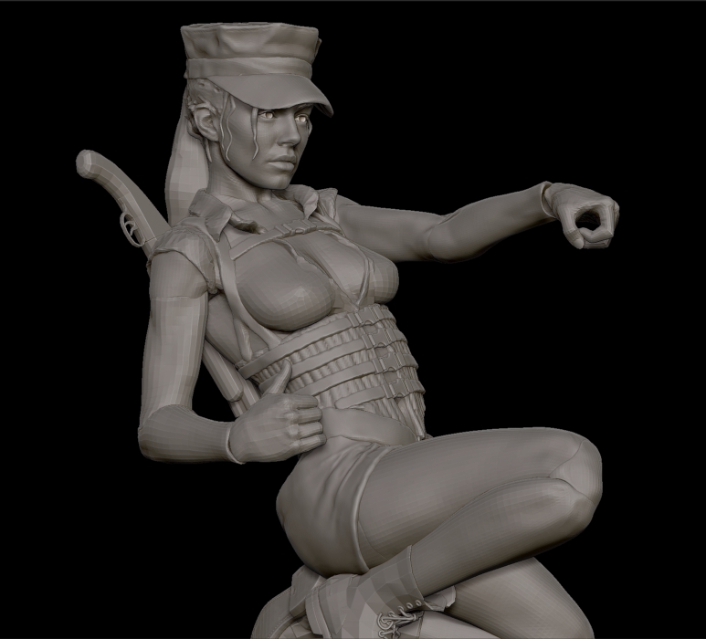

I’ve had a lot of requests to show some of my process so I went back and did some screen grabs of the character “Lucky” at various stages.
First off, my process is admittedly strange and not necessarily the best. Nor do I recommend it for all types of projects. My process is definitely a product of my background in making action figures. I was a traditional sculptor of action figure prototypes for many years, and not knowing any better, I just started replicating the same methods in the digital realm. This continued as I began making statues. Over the years of making action figures I built a library of several different body types. So for me the first step is selecting a body that is closest to what I want. You can still see all the articulation built in.

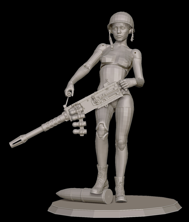

Lucky began as a personal project – I had always wanted to sculpt a woman with a big gun. I spent a few nights of free time just playing around and trying to find the basic character.
Later I went to my employer with the idea to produce a line of “tough beauty” statues, and when they agreed, I was able to work this character into the project. Over the years I have tried about every method of posing (from rigging to transposing), and for me, nothing is faster and more flexible than posing up a “toy” version. I do this in Maya. We went through a bunch of poses before settling on the final one.
At that point I pulled a ton of reference from http://www.female-anatomy-for-artist.com/. Like this:
I am a reference nut and I highly recommend this site. With a little searching, you can usually find something close to what you are after. Sometimes I will use the upper body from one pose and the lower from another. All of their poses are available in full turnarounds, which is key.luckyRenderB.jpg

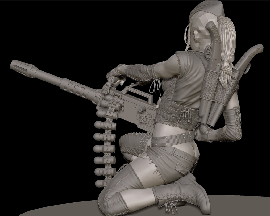

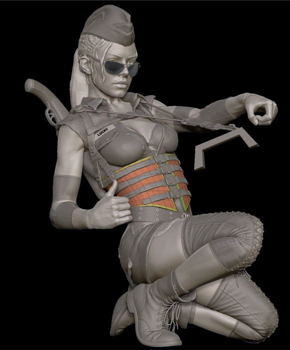

After the pose was settled, I started roughing in the accessories. I already had the basic gun and boots from my earlier doodling. Other than those, however, I didn’t have any real design in mind – I was just winging it – so I used Z Sketch to quickly lay down some “digital clay”.
I use Z Sketch all the time because it lets you test things out very quickly. Sometimes I will clean it up and detail it pretty far and just retopologize, sometimes I get enough info from the sketch to go straight to Maya and build the details from scratch there. It depends on the individual item. The rest of the process is cleaning things up and adding details. But I keep everything as low res for as long as possible. This lets me easily tweak the pose or change it dramatically right up until the end. At any stage, I can just send it back to Maya, repose, and send it back to Zbrush and all the accessories like gloves, boots, belts, straps, etc, just go along for the ride. :slight_smile: This is also the reason why I am judicious with dynameshing. Dynamesh is a very powerful tool, but I find that too much of it severly hampers my flexibility. Usually when I dynamesh, I will immediately Z Remesh and project the higher levels of detail so I still have a low rez version to work with. I also try to keep everything in separate subtools for the same reason. For example, I keep things like the arms and legs in their separate pieces (upper arm, lower arm, hand, etc.) for as long as I can. I just blend them together to look like single pieces. Merging things too early always comes back to haunt me. This means I regularly work with 200 or so subtools – which is a pain – but it helps that everything is low rez and changeable right up until the end.
Since everything I make is eventually printed, the last stage is always cutting the model apart and keying it for production. Keying not only keeps the pieces smaller and easier to print, but if you cut it apart with some forethought, you can keep the pieces easier to mold and paint as well.

*Also to harbottle, I really liked seeing the way you made the pose with the limbs separated, like an action figure, then dynamesh and sculpt them. Super convenient, and I imagine it helps preserve the forms of the body.
Thanks for your breakdown…it makes a lot of sense to keep statues that you can begin with especially as it allows you to not have to carve in the joints every time you begin.
