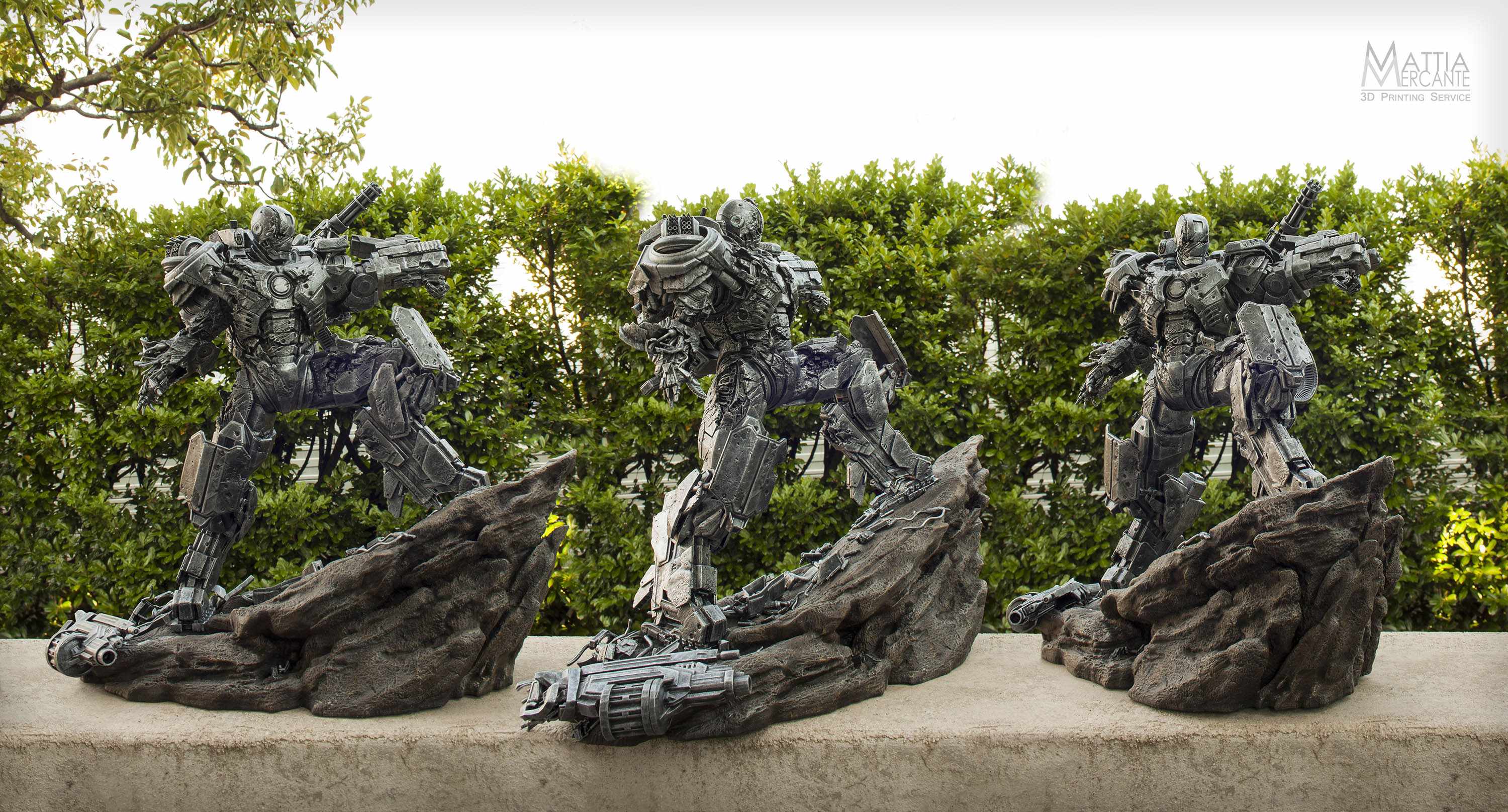

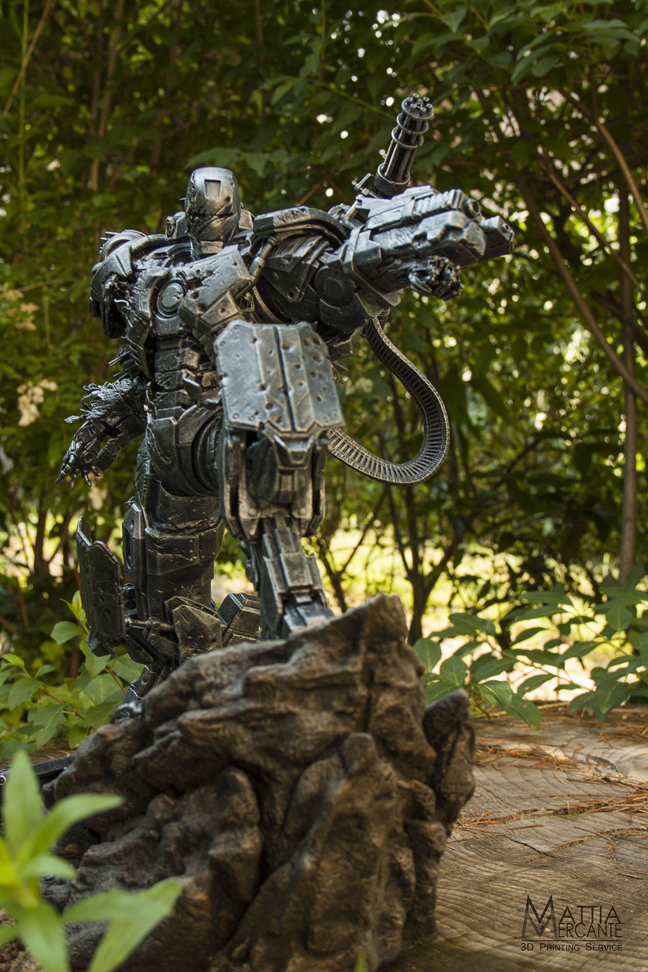

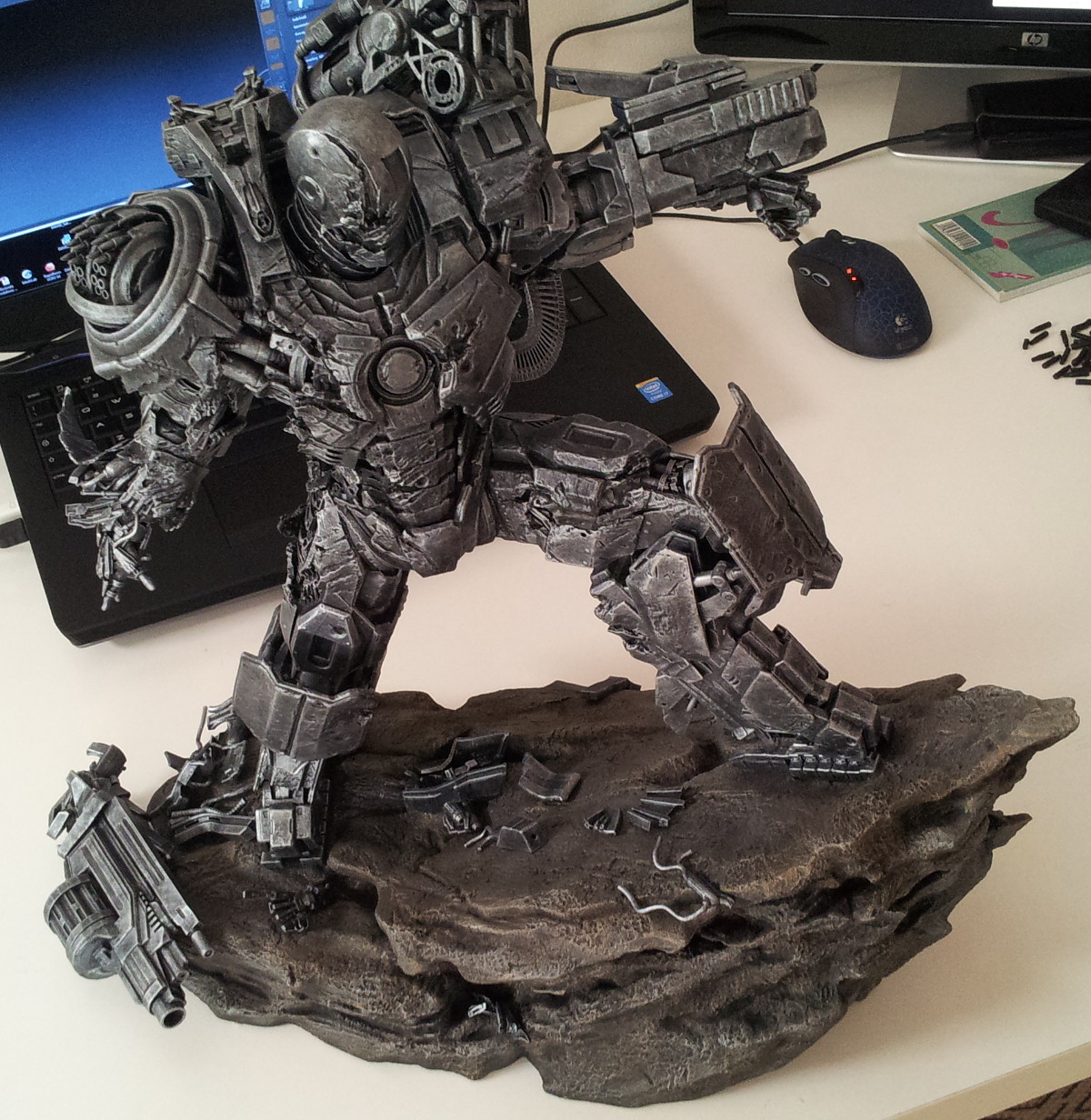

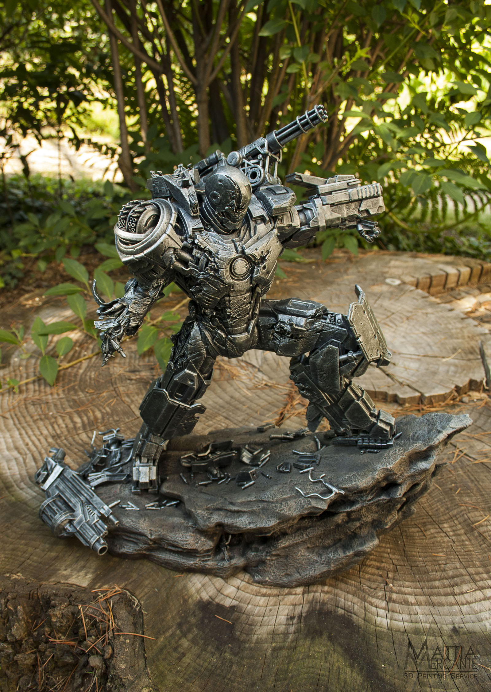

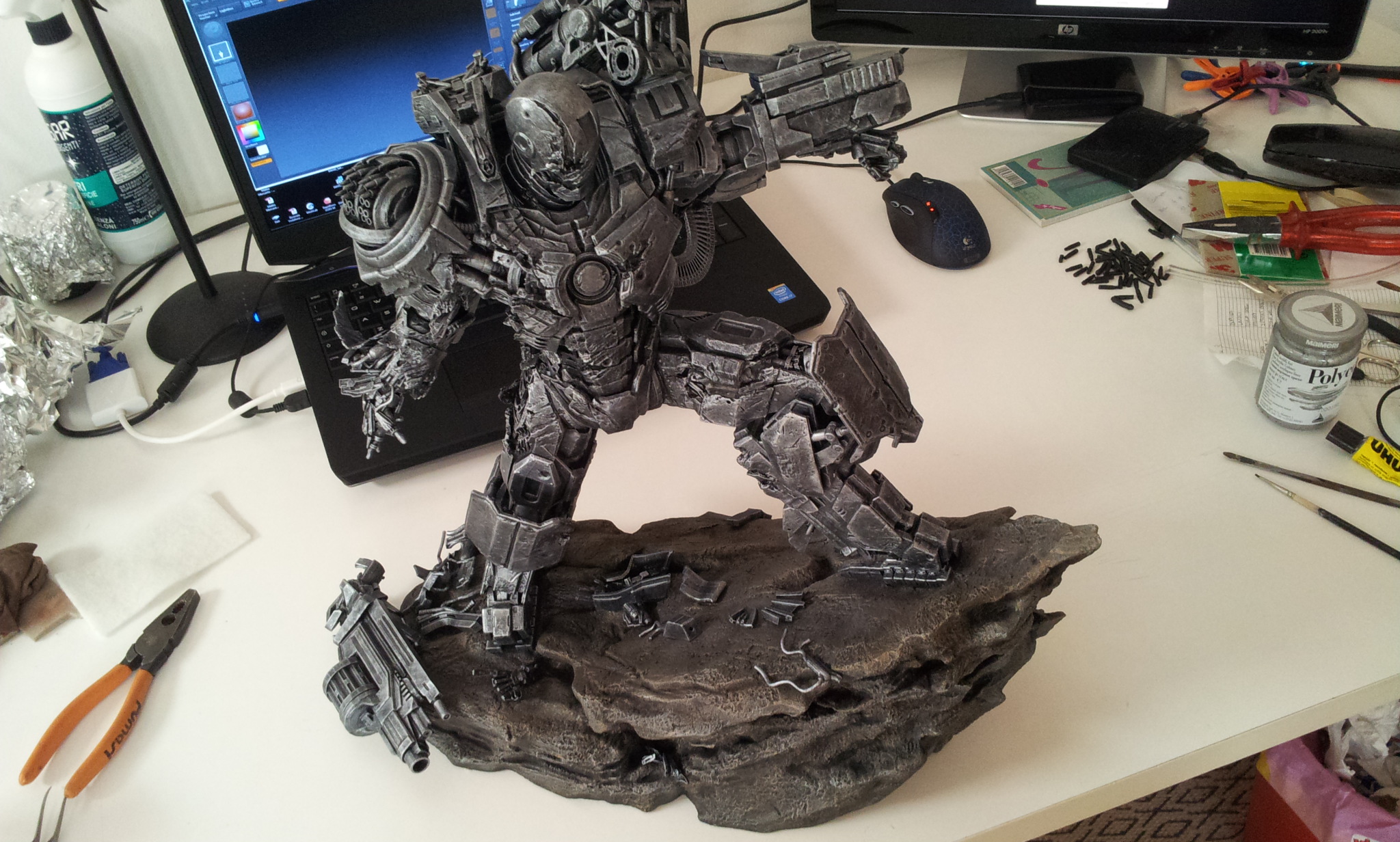

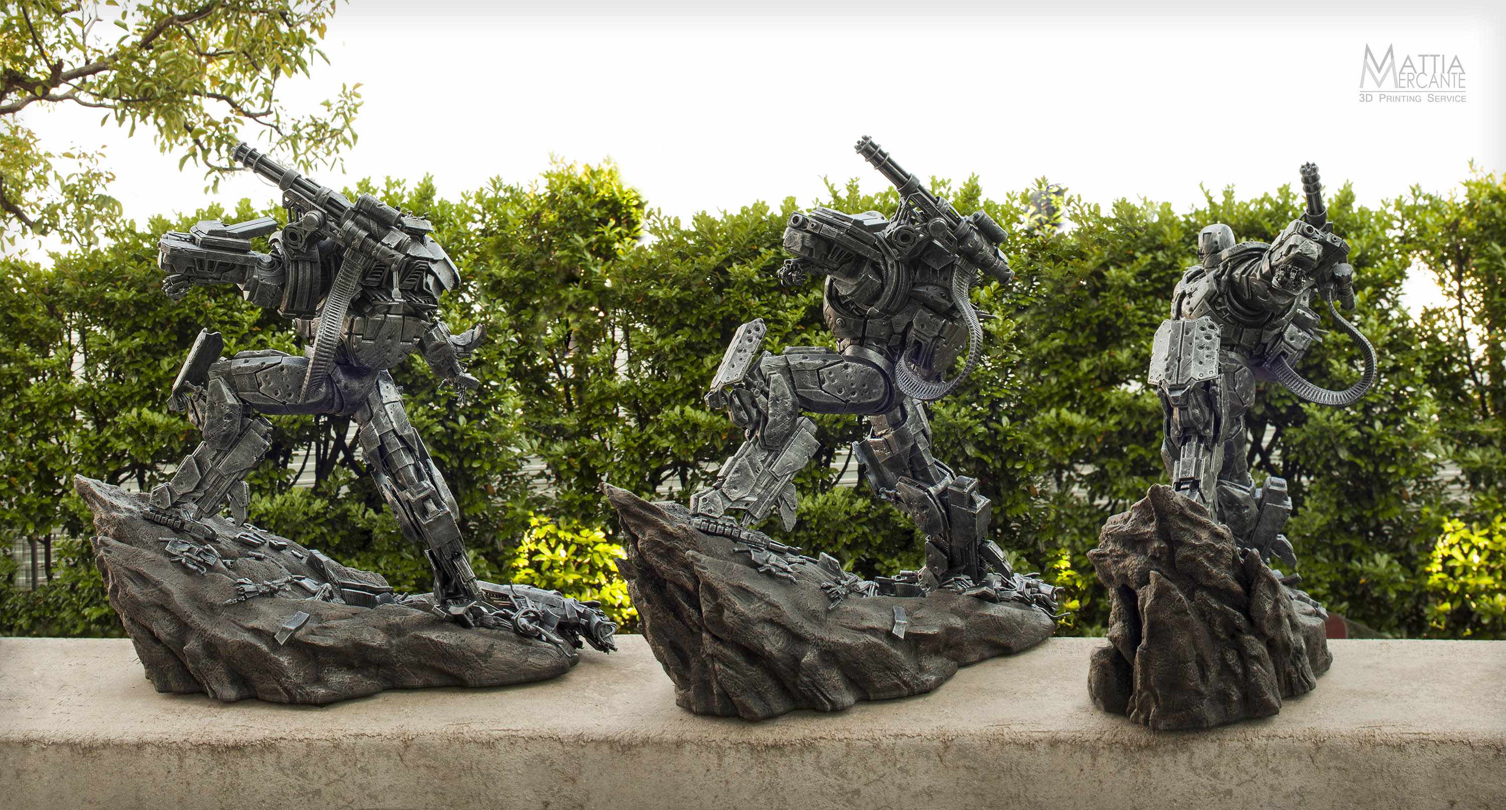

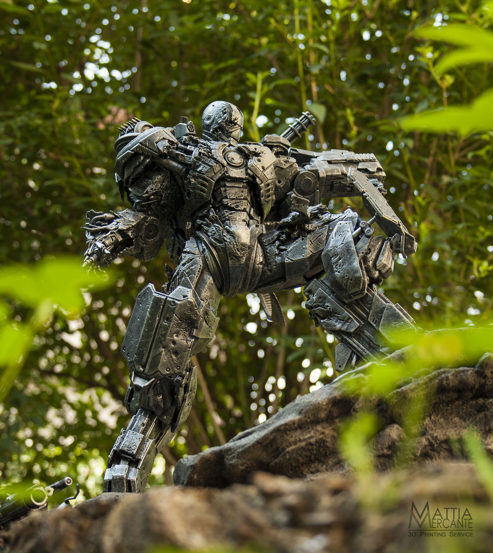

Hello,
finally I got some spare time to complete the War Machine printing project. It was hard for me, but a real fun!
Compliments to Joe for his amazing digital sculpting job. It was an honor to print his War Machine.
Here a quick shot. Will follow other images soon…
Mattia

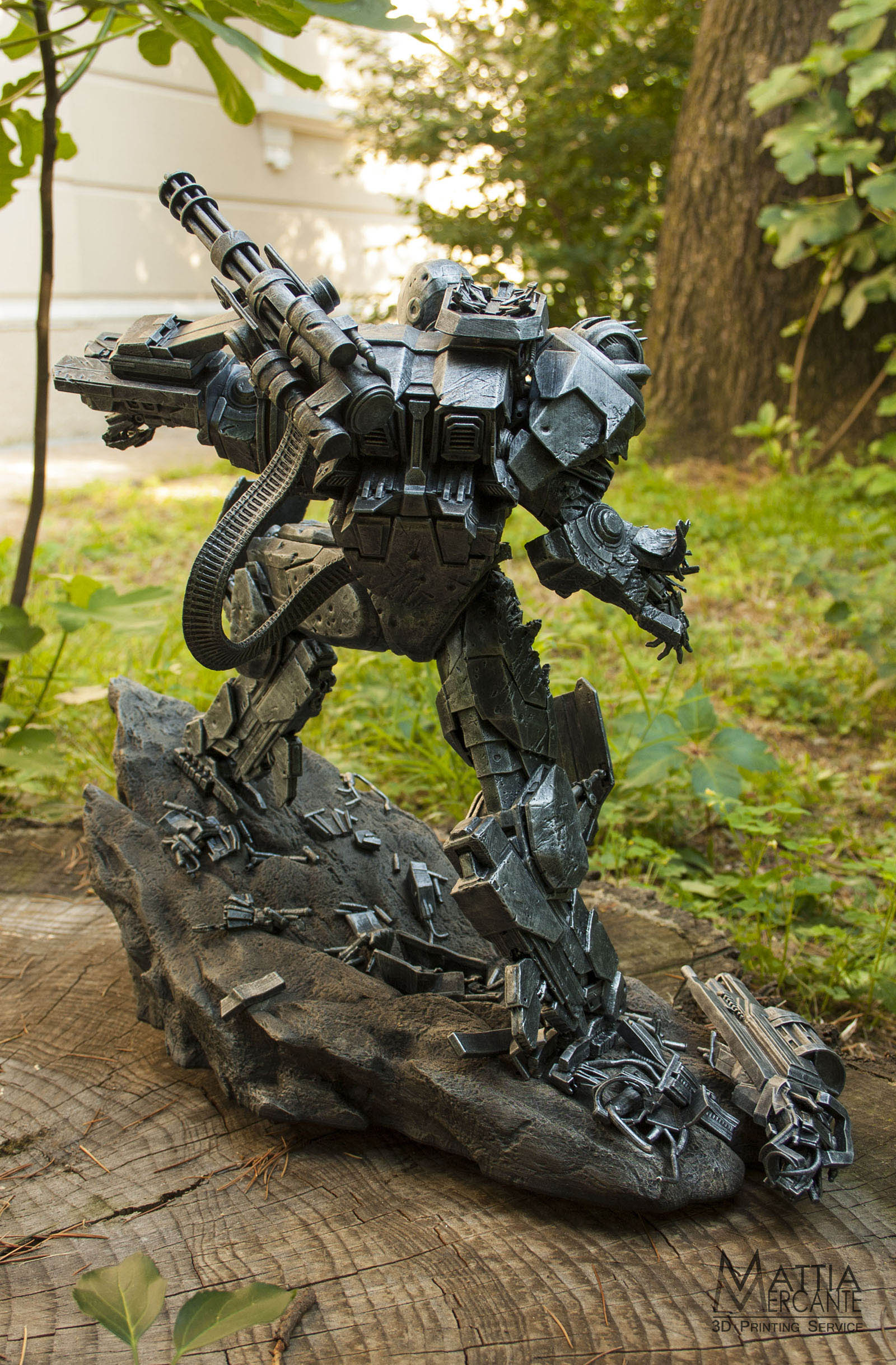

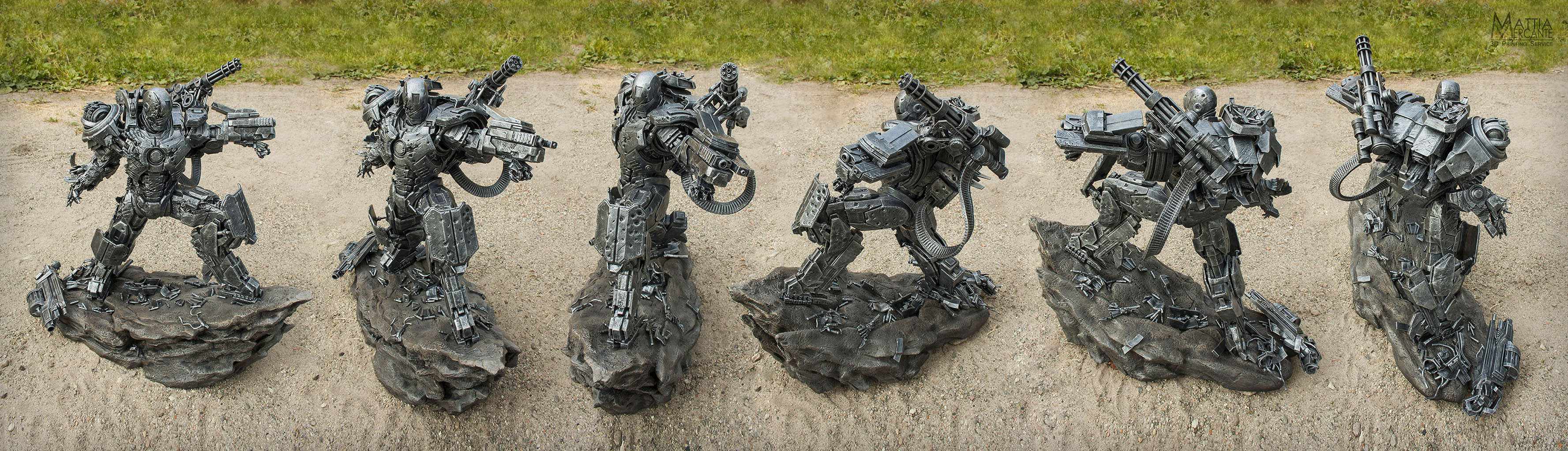

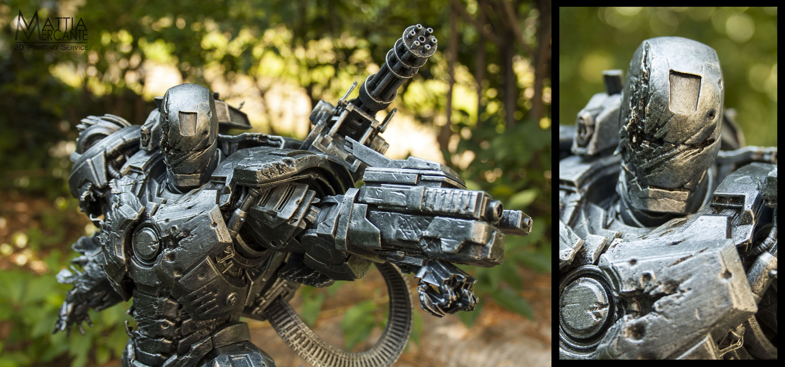

The sculpture is little more then 45 cm tall (approx 18 inches). the War Machine figure have 28 pieces assembled, puls other 18 on the rock (broken pieces of the armour) and 3 dozen of bullets. The rock stand was printed with an FDM machine (6 pieces assembed). Everything was printed at 0,1 mm, except the head, printed at 0,05 mm.
Printing time with SLA printer is appox 97,5 hours, plus other 67,5 hours for the rock (a total of 7 continuous printing days).
The black resin surface of the figure and props is painted and varnished (just few acrylic paint with dry brush - the darker color you see is the resin itself). The plastic material of the rock was painted in black, then finished with colors and varnished.
I’ve interpreted a little the original sculpture: I’ve increased some small details, too thin for the printer, and increased the left hand’s size. I’ve drastically reduced the dimension of the rock. Then I’ve choose a old-metal style color palette: hope Joe will like this version :wink:
I still want to add some little wires and other thin detail, missed during the printing process…
Soon other photos and details.
Best regards,
Mattia

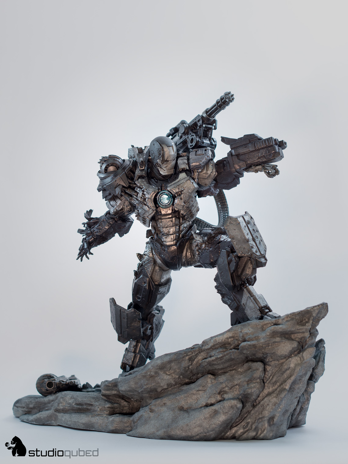

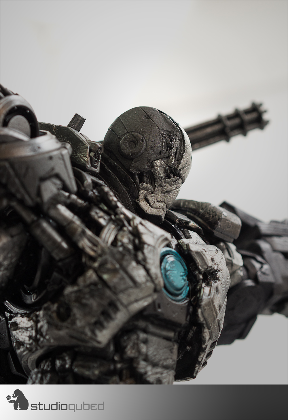

studioqubed
can you make a tutorial about the print of War machine and the materials??

Hello Shags.
If it can be useful, here some points I’ve followed: http://formlabs.com/company/blog/2015/06/16/mattia-mercante-war-machine/
Best regards,
Mattia
thanks Mattia! fascinating, how much did it cost to print all up?
Hi Shags,
I used 1,5 liter of resin (more or less). 1 liter is about 135 € (without 3 failed prints and lot of supports the final sculpture weight is little more then 900 g).
PLA filament for the rock cost 60 € 1 Kg, I used 900 g, so…
This was a printing project done mainly for fun in spare time: I didn’t counted the tons of hours spent in my nights and week ends (well, maybe my girlfriend did, I should ask to her! eheheh :wink: )
Best regards,
Mattia

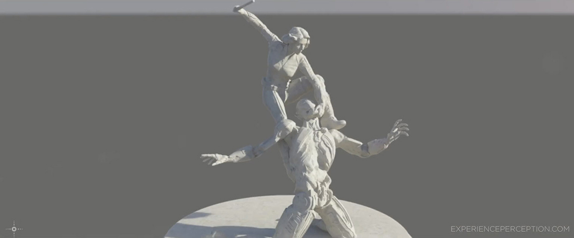

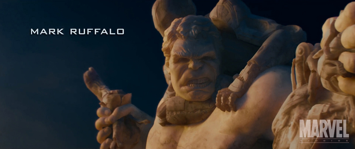

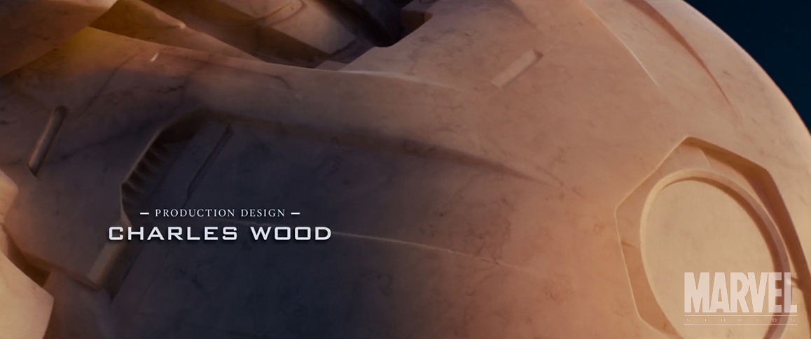

Hey ZBC!
It’s my pleasure to share with you an exciting project from last year for which I was hired after receiving the Top Row for my War Machine.
Avengers 2: Age of Ultron
Partnered with fellow CG artist Casey Reuter, we were the Zbrush team who sculpted the marble monument for the end titles.
As a token of gratitude to all those who helped make the War Machine such a presence on the web which resulted in my first feature film work, here
is a tutorial on the Zbrush workflow we used to turn Industrial Light and Magic assets into marble works of art.
Thank you Zbrush Central!!
[youtubehd]dsmgz1qjpmk[/youtubehd]
