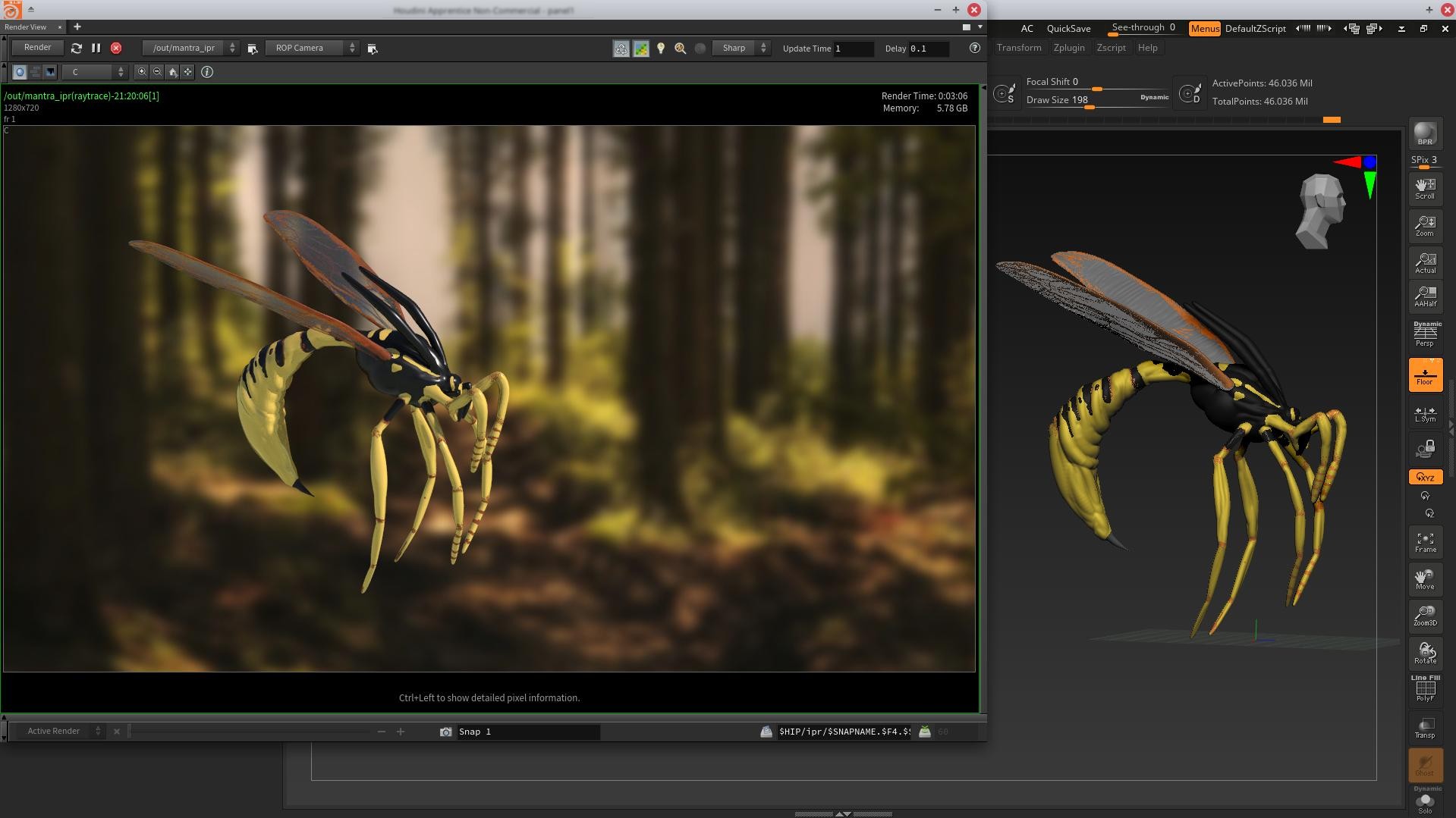

Now it is maybe time to mention that ZBrush on Wine is working well for me at the moment by using ZScripts and other scripting. I can not spend time with the remaining problems because there are other ones with higher priority.
Crossover by Codeweavers is somehow related to Wine. I am not sure if the user base is large enough for them to support ZBrush with Wine. So for now I will just use Wine and workarounds like ZScripts.
ZBrush-mat-to-Houdini-yellow-jacket-test
This image is just a quick test with the bug from ZBrush
oh,a nice little bee. actually I don,t know what that in English. :anguished:

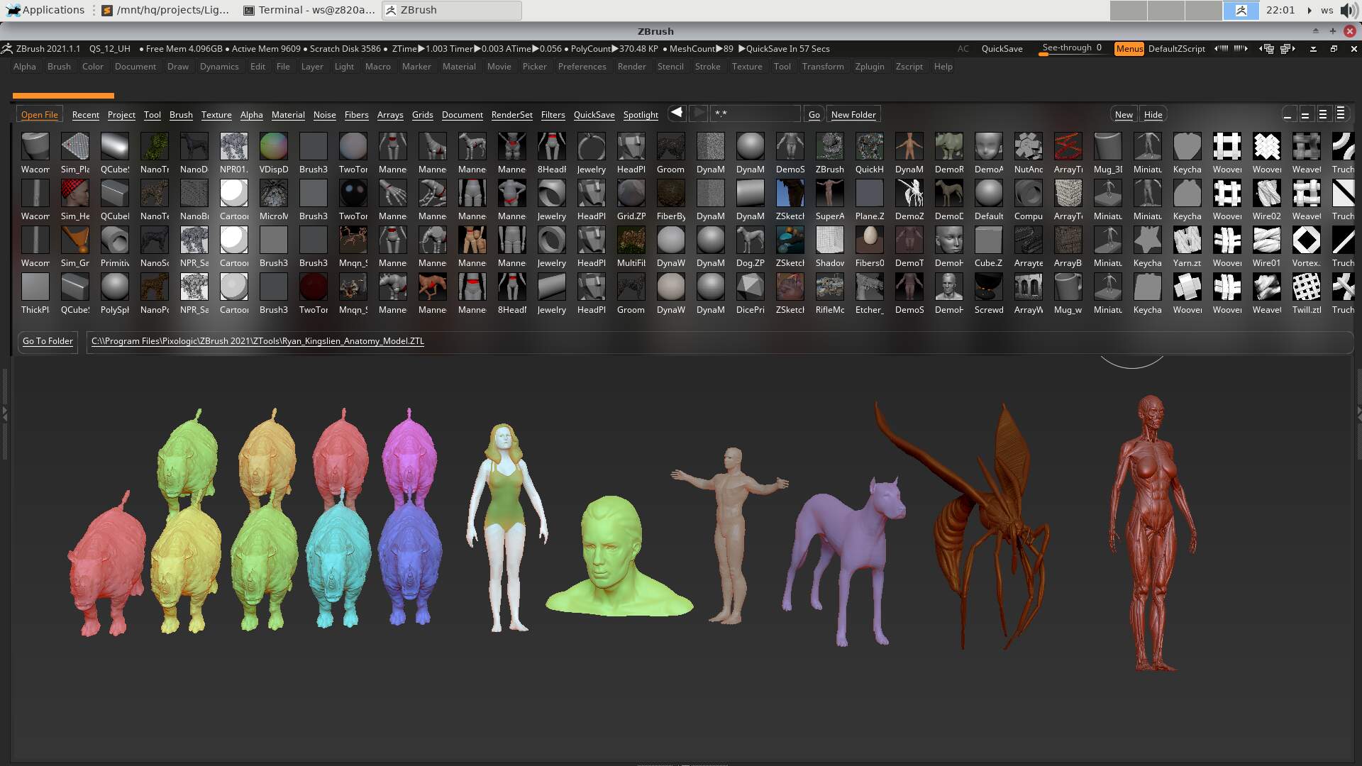

I followed both the instructions on here and on WineHQ to install zbrush.
One way I figured to resolve some issues with Lightbox was to open up the folder in a File Explorer then to create a new folder from the File Explorer and place the files that I use/want in the new folder(s).
Linux: Pop_OS! 20.04
RAM: 32GB
CPU: Ryzen 7 3700X
GPU: 2060 Super
Performance has increased dramatically. Copying the subtools in the image was done quickly.
Issues are similar as mentioned previously, however all limitations have not been checked.
Basically use the Linux File Manager to work around the Lightbox icon limitation.
