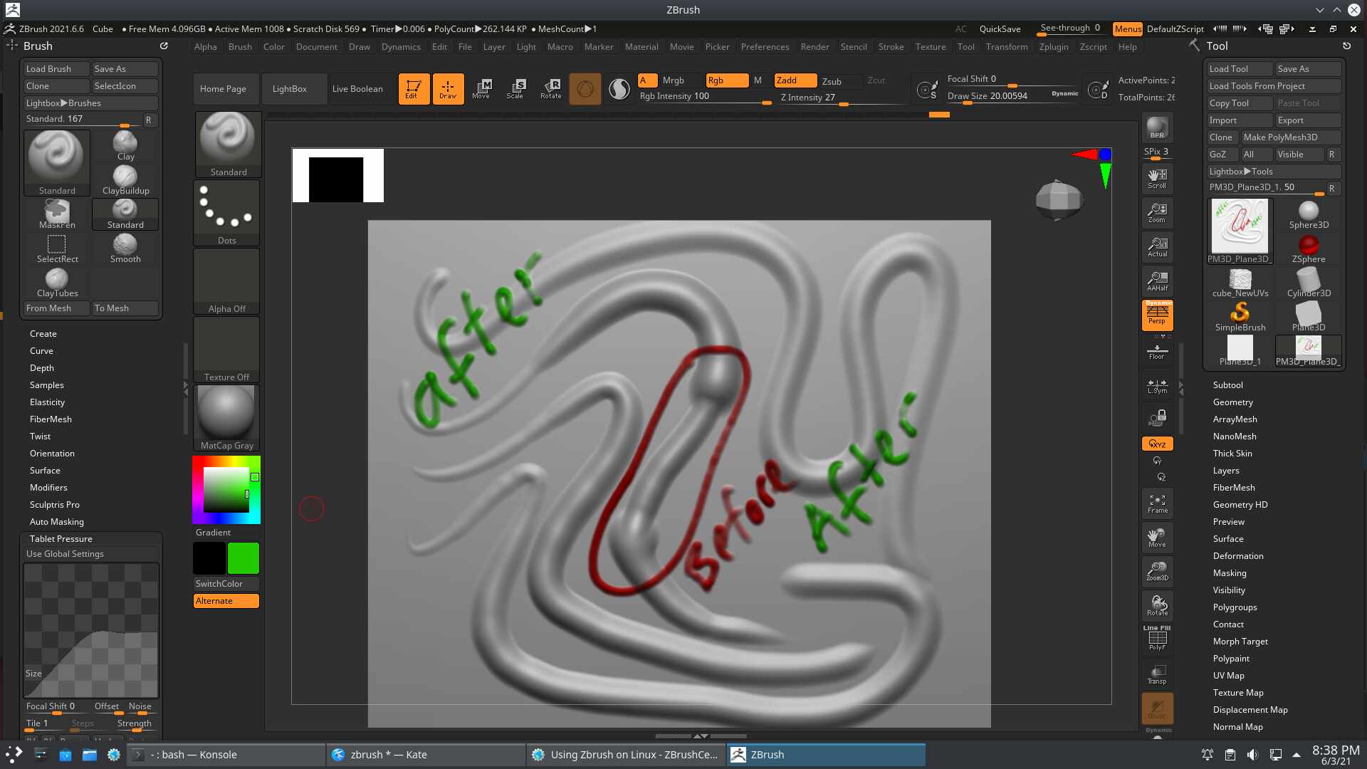

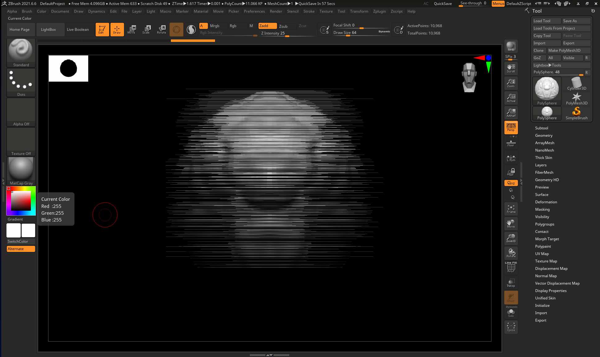

I have managed to make pressure sensitivity work, but with certain problems, though.
Here’s a screenshot of a problem I have, quite often at higher subd levels sculpt strokes randomly glitch and I end up with random maximum pressure strokes, it is really annoying and makes you undo all the time. This doesn’t happen at all in Windows. What may be the cause? Is it Vcredists conflicts or is it an internal linux problem?
@Lycaan @Histone

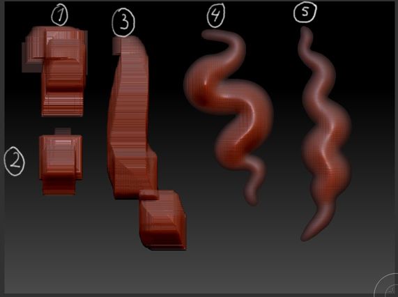

Problem description: When the tablet is pushed hard so the brush size reaches its maximum size additional pressure will cause the size to suddenly jump to a small size. (see image below)
Actually probably the reason why I have not noticed the pressure issue is because it only appear when pushing unnaturally hard with the Wacom. Pushing that hard with my Cintiq would quickly destroy my pen nib. However, it does exist in version 2021.1.1 as well as in 2021.6.6. My guess is that it should not be a Linux error beause pressure works well in other apps for example Krita. However, there is obviously some incompatible number translation between Linux-Wine-ZBrush.
To avoid the problem either you simply press lighter with your tablet or do the following tweaking. See the Brush settings in the image below.

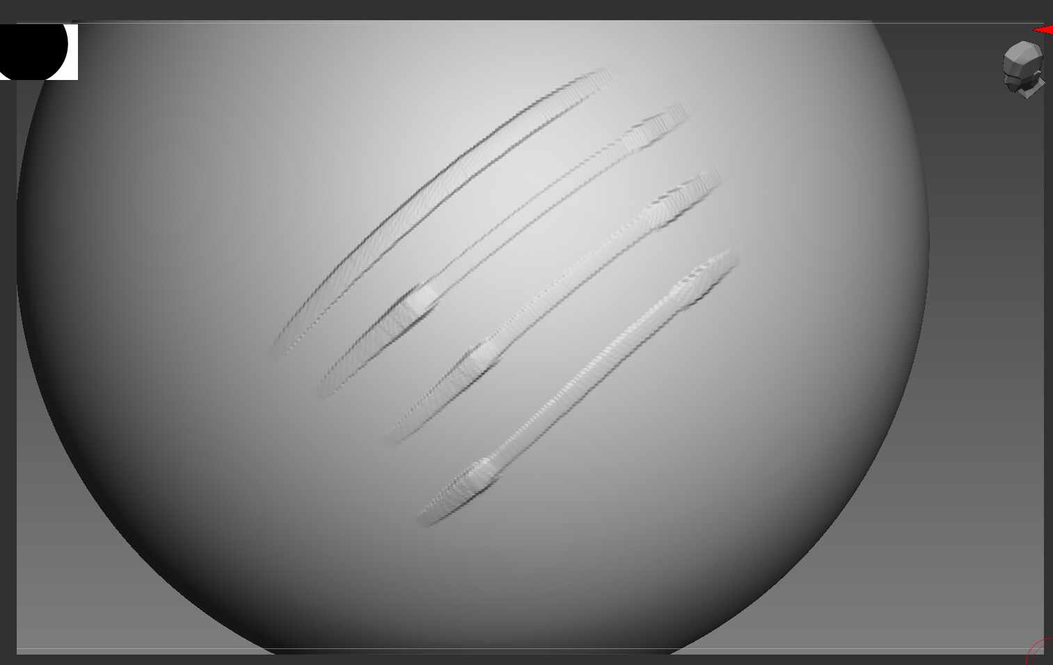

To get rid of the “lines” rendering error in version 2021.6.6 the library override vcomp140 (native, builtin) can be used.

Tablet pressure issue
As mentioned in my above post the quick and easy solution is simply do not press your tablet too hard (and adjust your settings so you do not need to either).

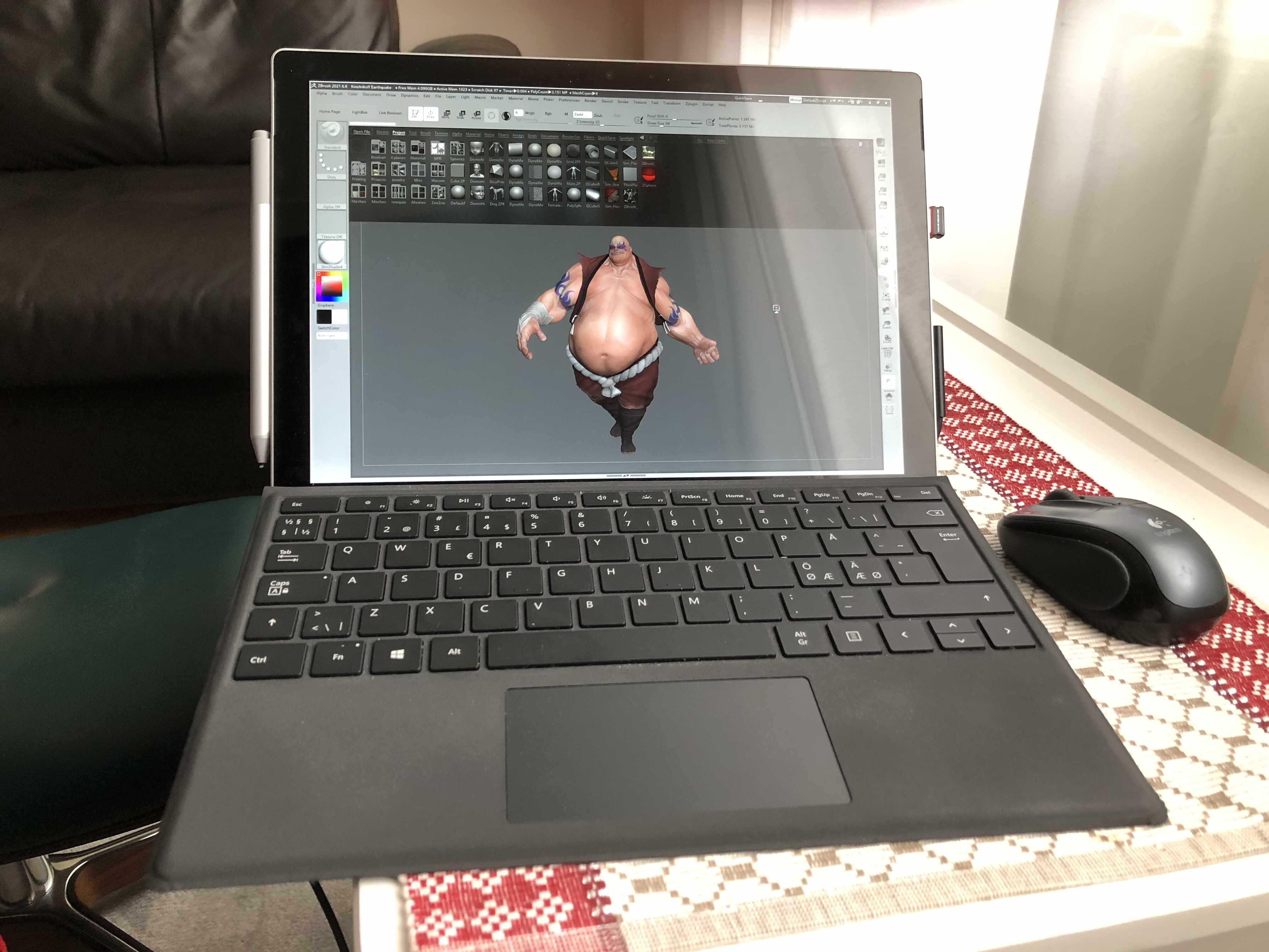

On the technical side I tested this with my Surface Pro running TurboVNC. This issue does not exist. I am not running virtual tablet (an optional argument when starting vncserver) but simply the built in functions of TurboVNC with XFCE4 (for less overhead). My mouse settings window will register different devices. For example I can connect to the same screen/session from the physical workstation and the Wacom Cintiq and at the same time run TurboVNC to the same screen. XFCE will see different tablet devices (in the mouse settings). When using the Surface with VNC there is not that pressure issue, but when running the Wacom pen on Cintiq there is. The pen used on Surface is some MS one (without a middle button).
https://external-content.duckduckgo.com/iu/?u=https%3A%2F%2Fmedia.4rgos.it%2Fi%2FArgos%2F4635206_R_Z001A%3Fw%3D750%26h%3D440%26qlt%3D70&f=1&nofb=1.
Conclusion: It seems that the pressure issue is somehow related to different devices (or possibly how you connect to ZBrush).

proper tablet pressure (this pen for now)
Surface Pro with Ubuntu (only the Surface)
Secure connection via Internet to a workstation running Debian 11 (fast interaction possible)

Hey everyone. I’ve tried using ZBrush with wine and it works but I’m getting terrible experience. Whatever element I put in the viewport doesn’t get rendered. I have to left click + move mouse so I can get something to show up, and even then it’s kind of fragmented.
I’ve tried wine 4, wine 6 and crossover on different distributions (CentOS, Fedora, Ubuntu) and the result is always the same. The PC I’m testing on is quite performant.
Here’s a screenshot with my problem. The element I’ve selected is a simple sphere

I started Zbrush and I saw I had your issue. I closed it, I choose “configure” from the Lutris menu, and installed the lutris runner. I closed and restarted lutris, I again clicked “configure” for Zbrush, then changed the runner from Wine to Lutris. Started Zbrush and the issue was solved, but my stylus was acting weird. So I closed Zbrush, reverted back the runner and finally everything works correctly.
@Z_Z Have you tried the overrides THINKIT suggested in the post #9? As well as vcomp140 (native, builtin). This fixed it for me. Hope it helps :slight_smile:

9. Observed the “lines issue”. Lightbox show items but has a “clearing issue”.
10.
winecfg
Opened tab Libraries and added:
vcomp140 (native,builtin)
Terminal:
wine64 ‘/home/shared/.wine/drive_c/Program Files/Pixologic/ZBrush 2021/ZBrush.exe’
  1. Observed: No “lines issue” and no “clearing issue”.

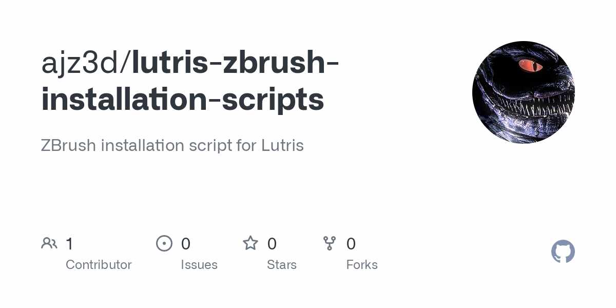

For the sake of installing ZBrush on GNU/Linux machines in a simple and quick manner, I created a git repository holding Lutris installation script(s) for the current, and possibly also future versions of the program.
It will, more or less, automate the installation process. More, because most of the Wine-related stuff will be dealt with automatically. Less, because I didn’t find a way to run ZBrush installer in a silent mode, so it will, at a certain point, require user interaction. Typical for Windows software. If you know a way to circumvent this and run the installer in a silent mode, then please do let me know. Preferably in GitHub issues section, as I’m not a frequent patron of these forums.
Happy sculpting.
