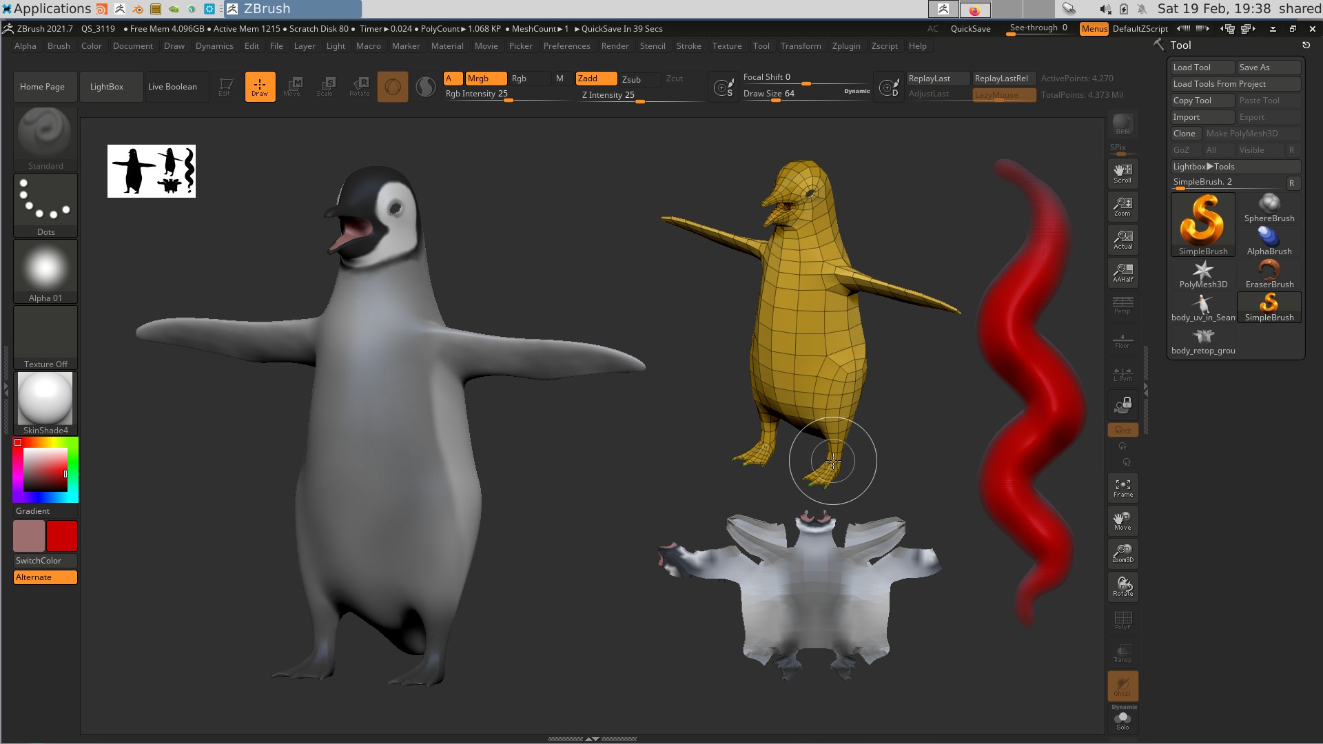

One of my later projects is a penguin rig (but I forgot to show that disgusting tongue). Doing something basic like this is no problem with Wine-ZBrush (i.e. after you set it up right). I did send the model back and forward to Houdini while fixing the topology.

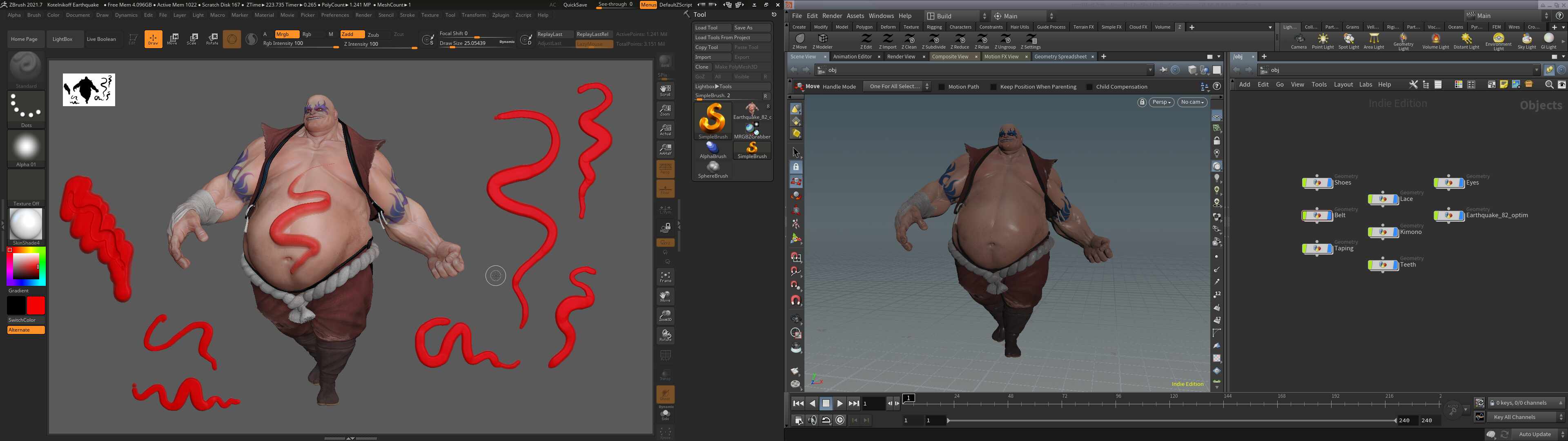

In this setup I had to disable the āvirtualtabletā mode (it will not work well in dual screen) and thus got the pressure mapping wrong (i.e. do not press too hard). In effect I just have to press half the amont to get the brush in full size. However I can accept that.
