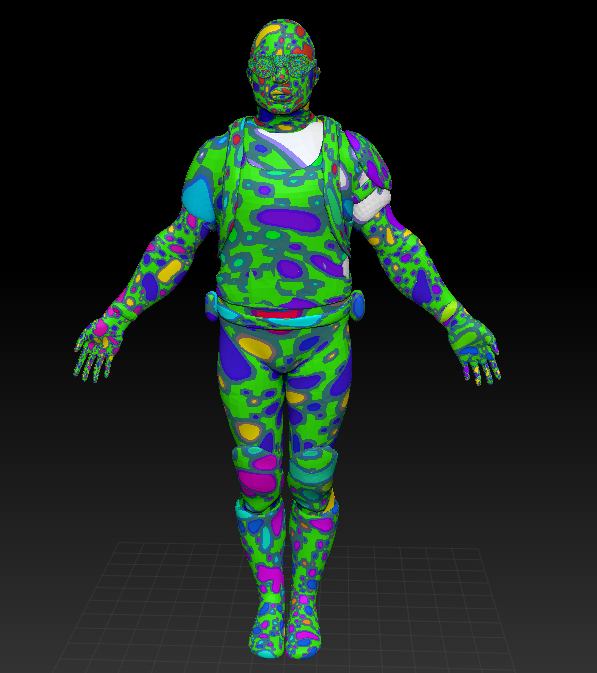

Thank you so much for this useful script. I can now fill my canvas easily with ‘processed’ subtools so I can rotate the mass of them and ‘l@@k’ for “something” on the canvas to edit further and then paint on and or with.
Still need to tweak my macros a bit.
