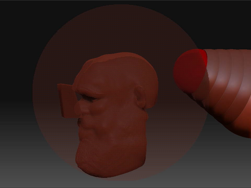

Is there an issue with Topology and 3.1? In 3.0 I could attach a mesh to a root zsphere and Shift/Click and draw out new topology. In 3.1, even if I use native polymeshes that come with the program (like the star tool) I can’t get new topology to draw out. I have brush size set to 1, x symmetry turned on and am in edit mode.
Thanks!
~S.~
Snark you say something like this…mesh+zsphere root+edit topology=new mesh
Andreseloy
ps:this is a quick test now but i have been able to work in that way
